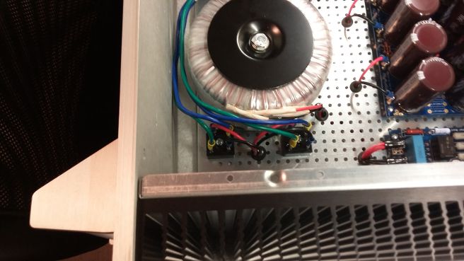

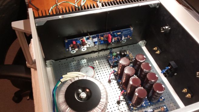

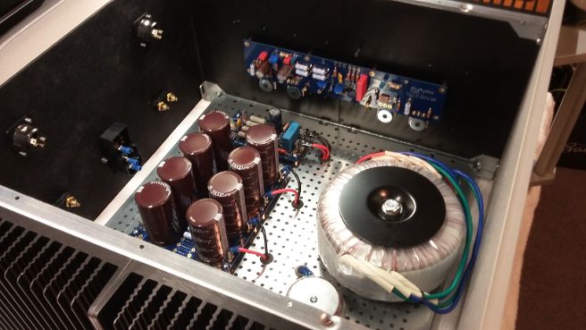

slowly making progress...
Working on this between other projects:
A moment of truth draws nigh, about to install my R channel board.
Power supply has been checked 3 times and will be checked again prior to
connection and energizing of the board.
Seeking a confirmation: Q5/Q6 are matched pairs and Q7/Q8 are matched pairs, check?
