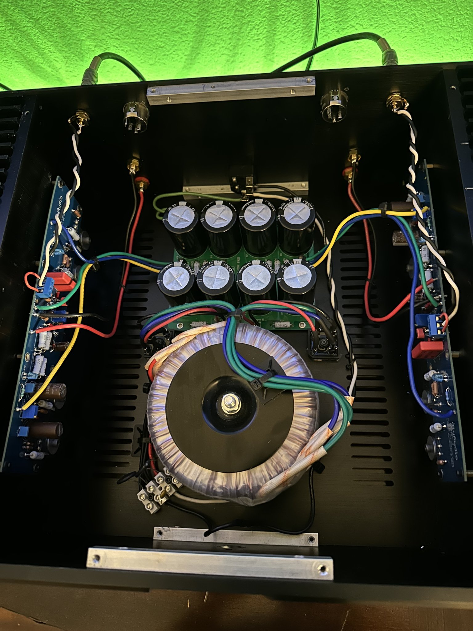

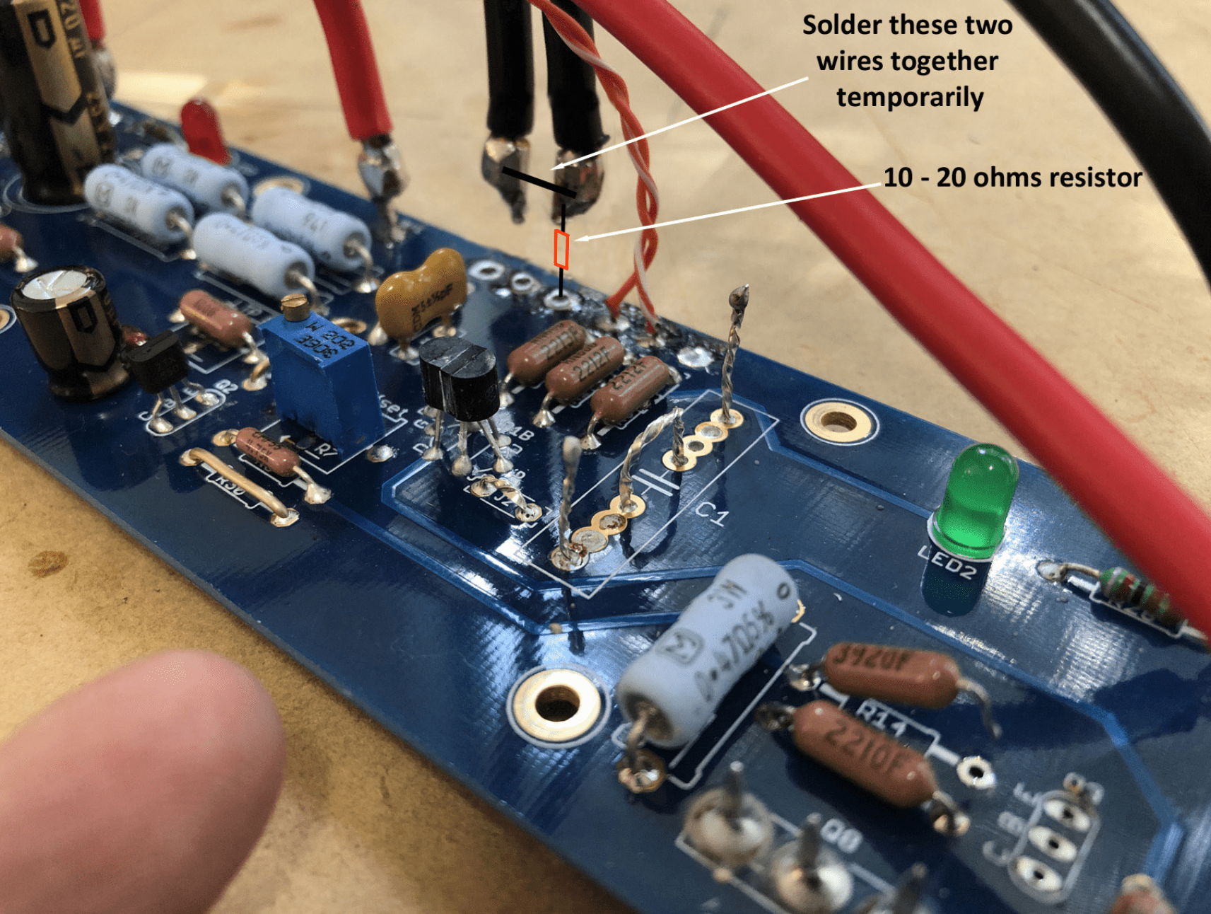

Hello, yes there is a trace around the board but there is an open area in the back by the bridge rectifiers. After doing the recommended grounding I still have a hum. I will say that when I moved the amplifier to the kitchen table and used a different wall socket the hum dropped considerably. could it be coming from my wall?

The amplifier shows XLR, but I am using single-ended rca connections on the other side. the 2 grounds have been joined together via a wire soldered in place at the xlr connectors on the back plate,........the Hum is present with the source and the pre amp off
Check the ground on your power cable. Make sure it isn't open. Then to be sure, check the ground from inside of the amp to the ground prong that goes into the wall with the cable plugged into the amp. Also, check the outlet for proper ground.
Crooner, did you try rotating the toroid transformer?
Did you measure the resistance between amplifier signal ground and chassis ground? It should be the thermistor cold resistance.

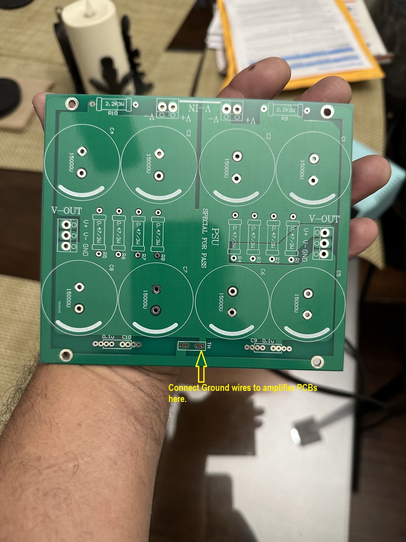

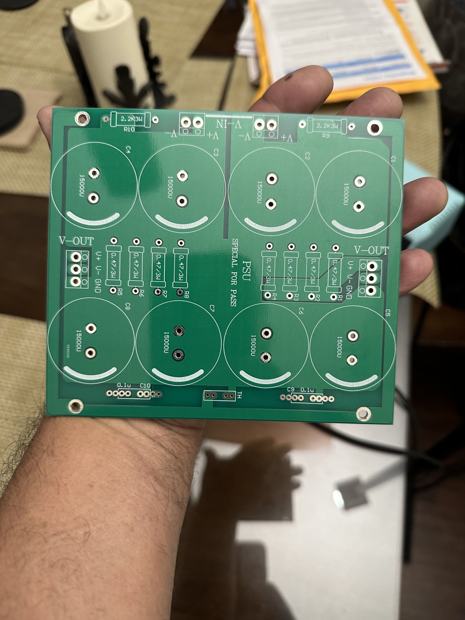

The power supply PCB does not take the Ground from the board at a optimal location. That may cause some hum. The PS ground should be located between the last V+ and V- capacitors. So disconnect the V+ and V- grounds from the screw connectors and solder them to the location shown. The location is at the board side of the thermistor connection.

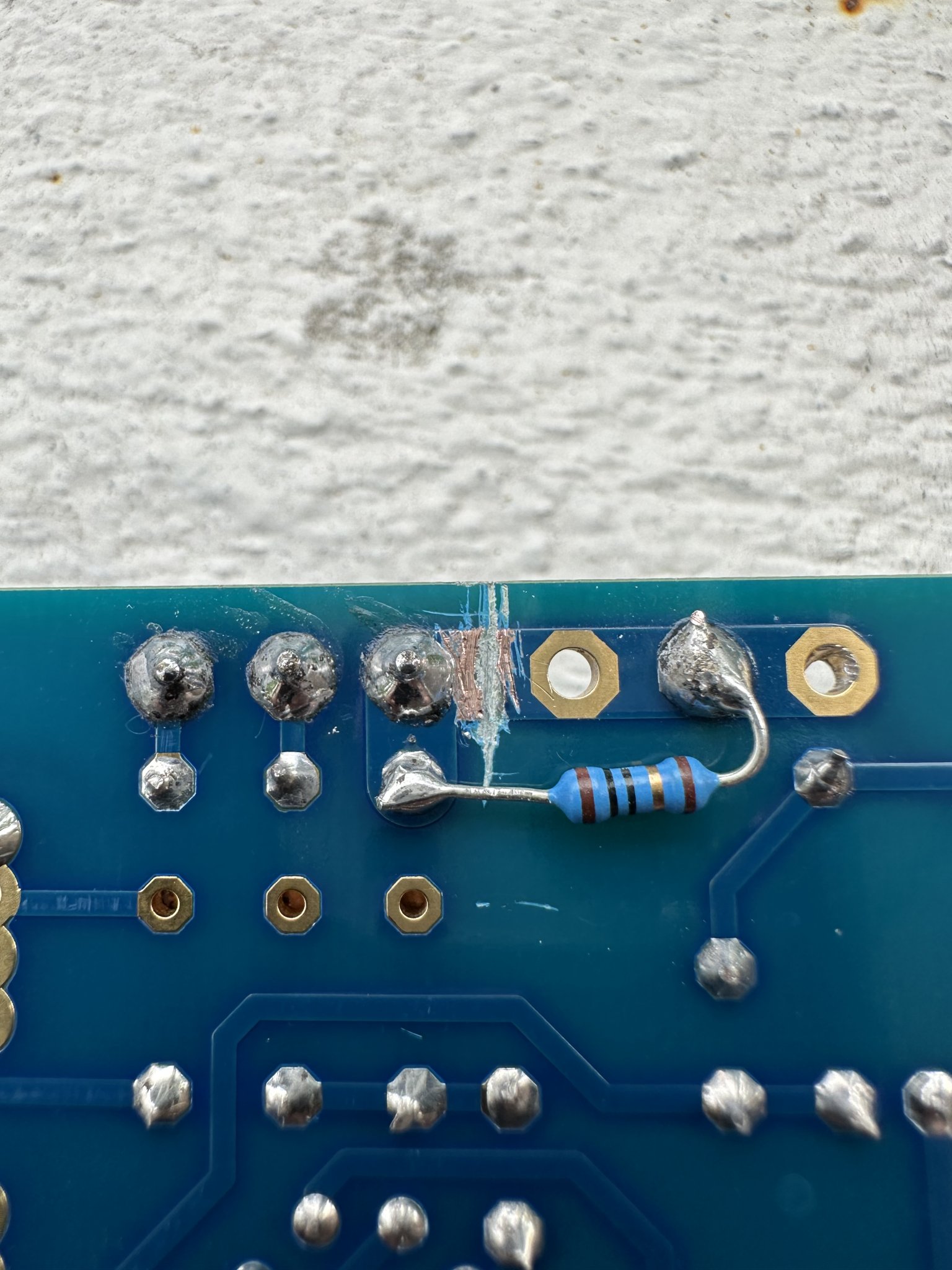

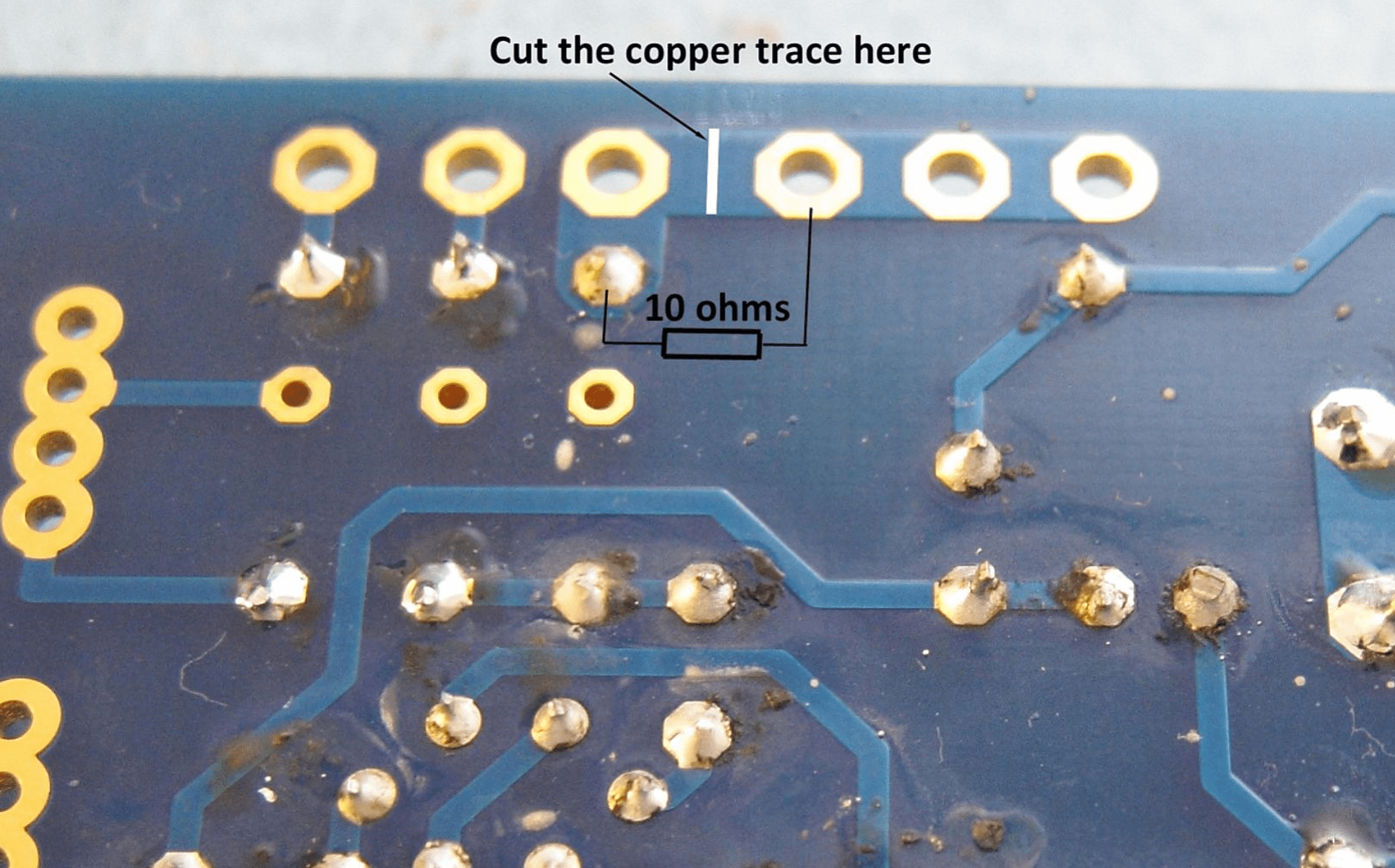

The XLR-wired Aleph J, if used with a single-ended (RCA) source, will require a ground lift resistor (negative is shorted to shield/ground). Later on, if an XLR source is used, the ground lift resistor will not cause any harm... Furthermore, it can be bridged out by soldering a wire link across that resistor... no need to remove the PCB...
The above can be tested first...

Hi, yes I tried moving the transformer, didn't really make much of a difference. I also checked the signal to chassis ground= 13.2 ohms
You can test if it is going to work from the top side as per the second photo I attached above... but the mod needs to be done from the underside, i.e. you have to remove the AMP PCB... as per the first photo I attached above.
Ok, I will try that and report back, thank you.The XLR-wired Aleph J, if used with a single-ended (RCA) source, will require a ground lift resistor (negative is shorted to shield/ground). Later on, if an XLR source is used, the ground lift resistor will not cause any harm... Furthermore, it can be bridged out by soldering a wire link across that resistor... no need to remove the PCB...

I was also going to install the single-ended RCA jacks. will I have to do the 10-ohm resistor mod for that?.......I don't currently have an XlR set up at the moment.You can test if it is going to work from the top side as per the second photo I attached above... but the mod needs to be done from the underside, i.e. you have to remove the AMP PCB... as per the first photo I attached above.
Ok, here are the mods you recommended. I also decided to put a connector on the driver boards and add a single-ended connection ....there is a very slight hum but you have to put your ear to the speaker. I think I can live with that.....thanks to everybody and to Extreme_bolky for all the 👍 help on this site.
