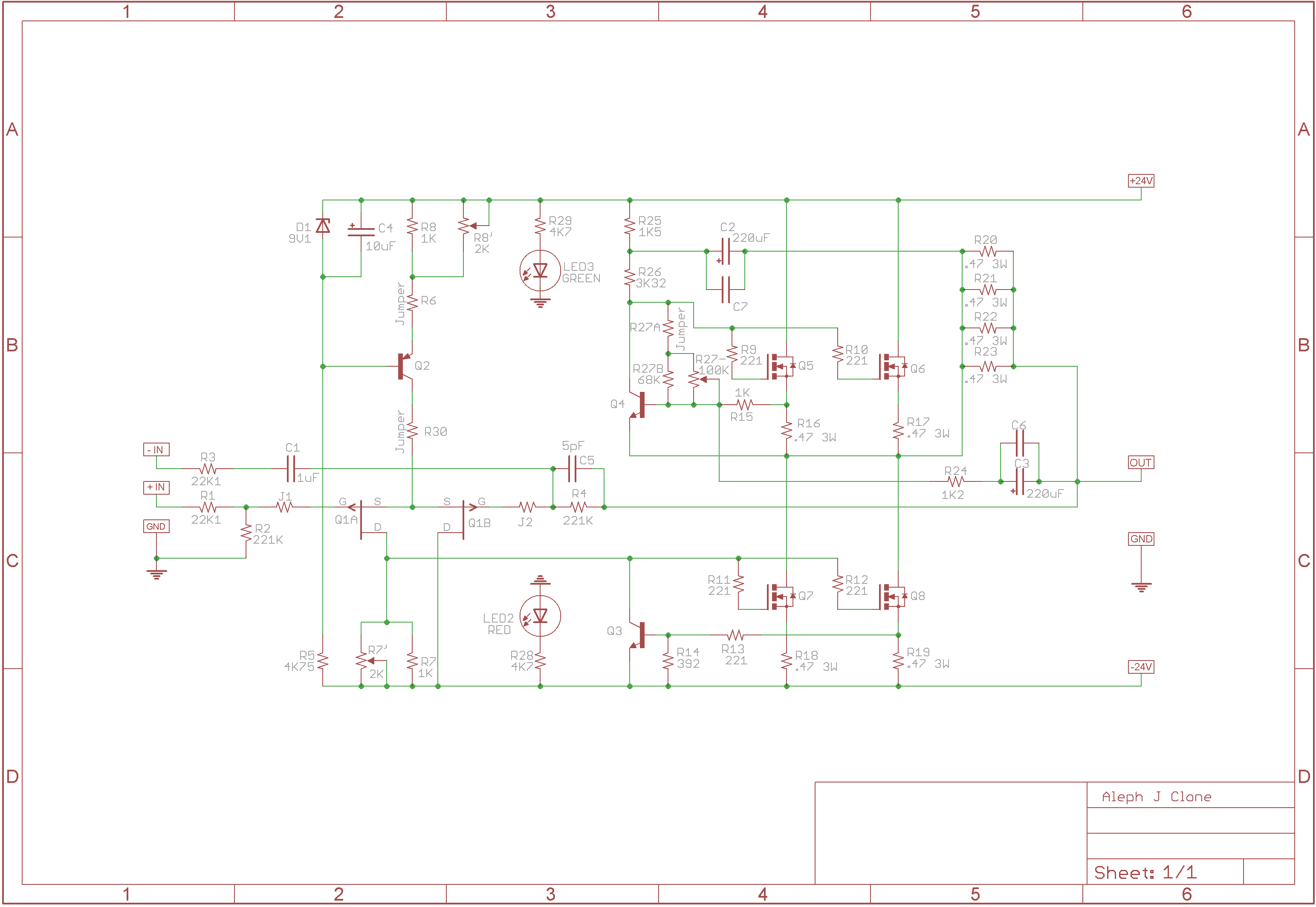

values for R7, R8, and R27 are needed.
R7 - 1K (however, that's the easiest to adjust, merely twist it whatever what you need to set 0V dc on the outputs)
R8 - 1K (I would use a resistor here, not a pot, unless you truly need it)
R27 - 68.2K

Thanks for the nominals, 6L6.

Thanks.

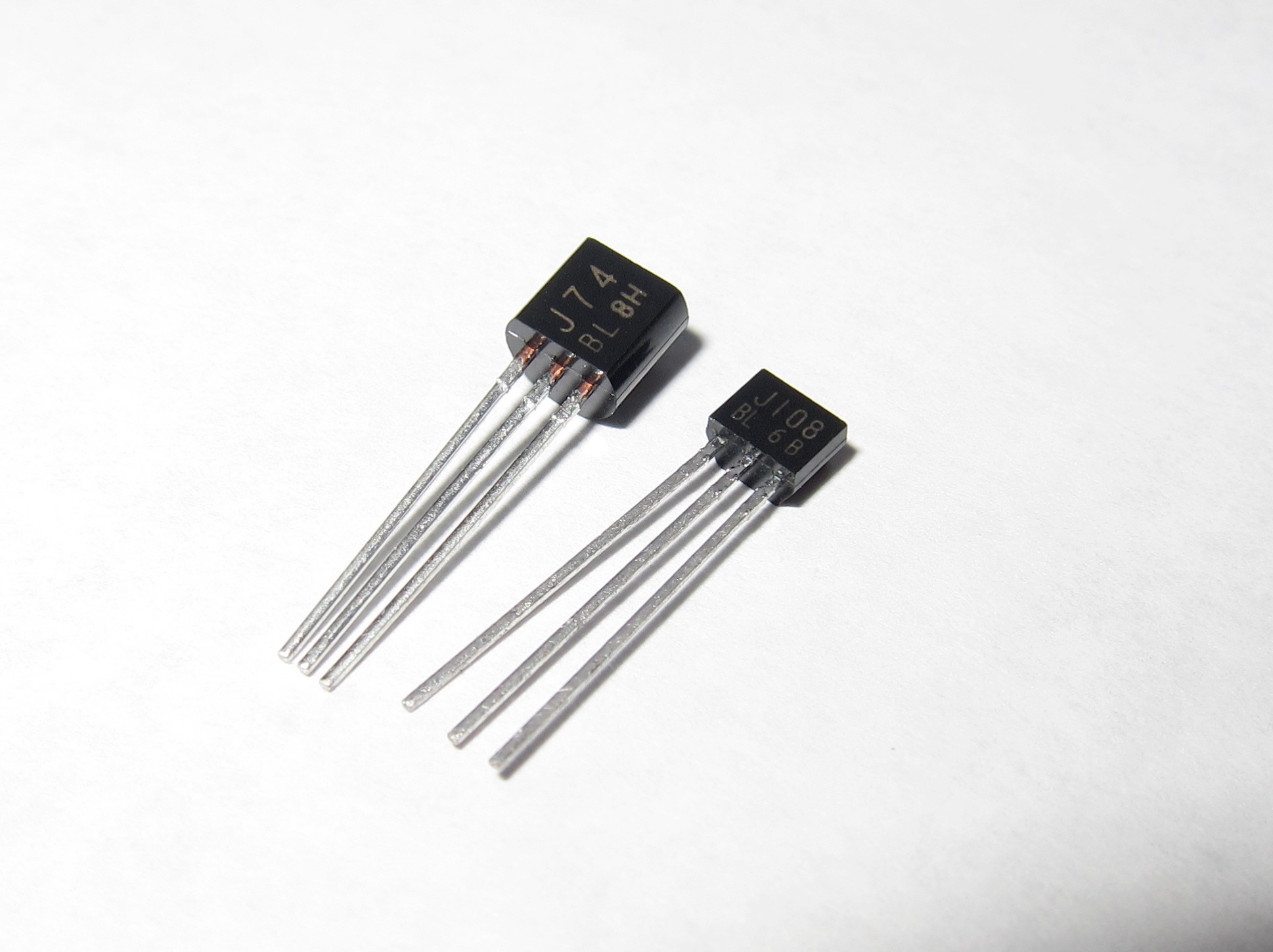

Funny you should mention that, I'm pricing out a kit to populate the amp PCB, with everything, and it looks like I can sell it for about $70 for the stereo amp.
I've got 30 sets of 2SJ108BL (The same chip as a 2SJ74, but in a different package) And if I can get enough interest, will make the kits.
When I visited Foresthill about a month ago, I got a really nice present from Wayne - a bag of 2SJ108BL.
The J108 is the exact same die (chip) as a J74, in a smaller plastic package. The pinout is the same, and the only difference is dissipation, which in our application (the differential input pair of the Aleph J) works just fine.
This has been verified by Nelson. 😎
After testing the pieces for Idss and matching them, I have enough to sell 30 stereo kits. One kit will populate 2 Aleph J circuit boards, I.E., one stereo amp.
The kit will include Matched IRF240 from Buzzforb, Wima film caps, Nichicon Audio grade electrolytic caps, Dale/Vishay CMF55 and RN60 resistors, Bourns trimpots, and other high-grade components. Everything to stuff the amp PCBs.
There will be no PSU components. (Although, if you are interested, tell me and I will look into it.)
At this time I'm looking to see how much interest the forum has in a parts kit like this. I only have the one batch of Jfets, so there will be only 30 kits. When they are gone, they are gone.
If you would interested in buying a kit, and at this time it looks like it will cost $75USD + shipping, please send me a PM. (I'm only recording interest at this time, not taking orders)
2SJ74BL left and 2SJ108BL right
