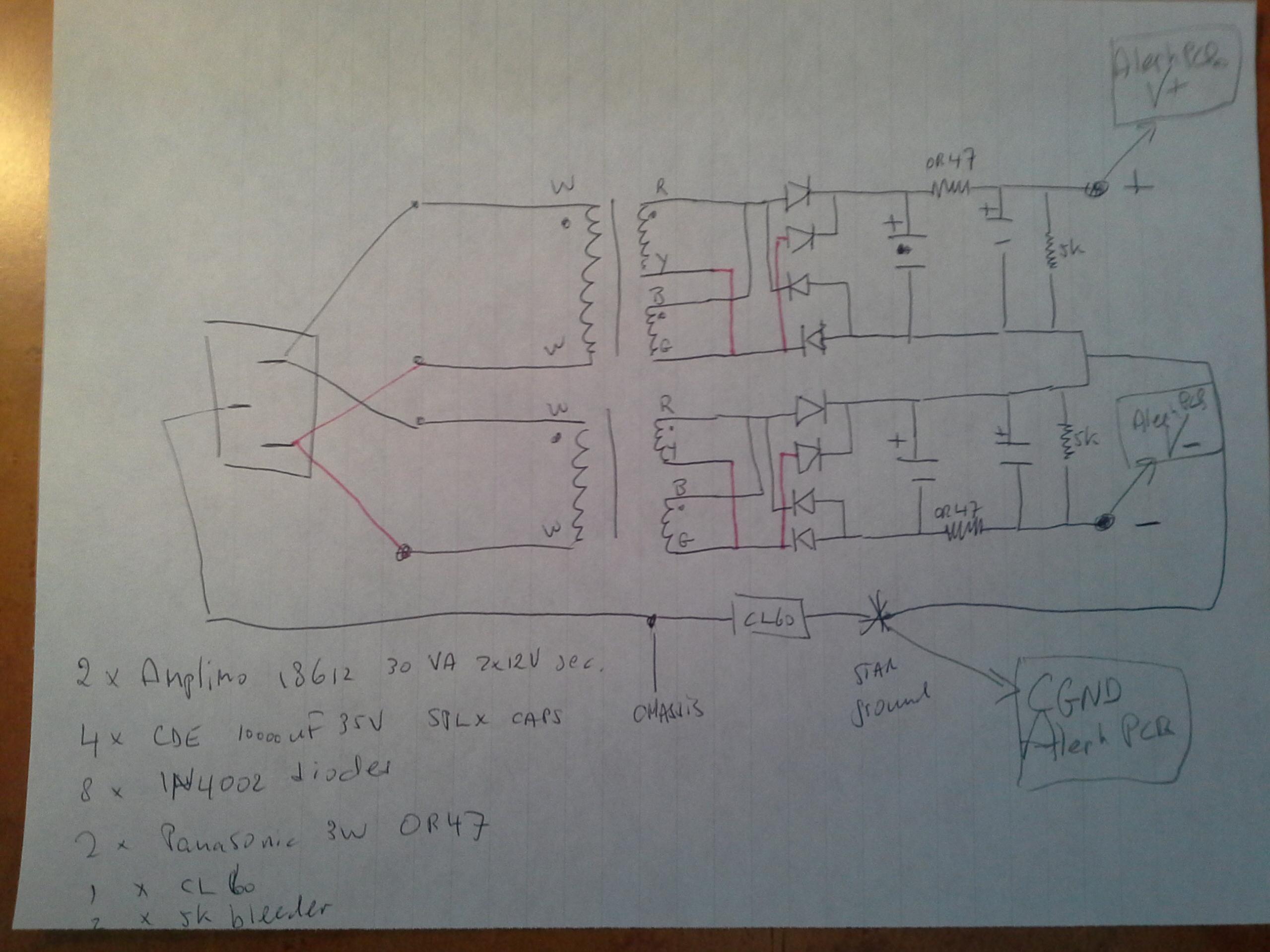

I made a simple CRC PSU (CDE 10000uF 35V, Panasonic 0R47 3W, CDE 10000uF 35V) using 1N4002 diodes I had in my drawer. Perhaps I will change the diodes in the future as suggested by Zen Mod.
I used PSU Designer and think that with the load I expect that a single 3W 0R47 in the rails should be OK. It's simple to change if required.

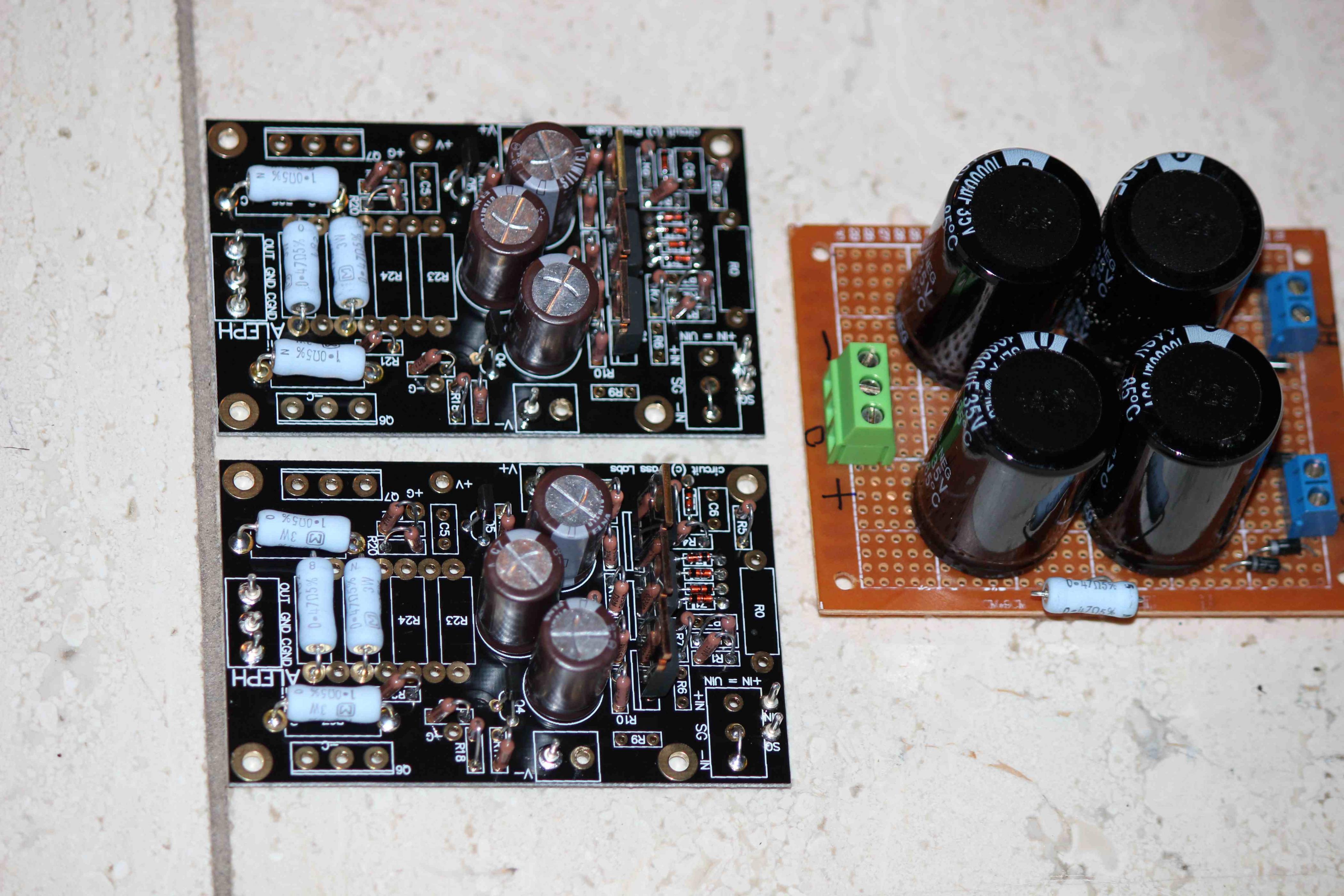

I had already bought Aleph boards from Chipamp. A German ebay seller supplied matched IRF9610 IRF9610 matched quad | eBay (he also supplied the IRF610 I will be using). The single Q3 IRF9610 came from a surplus store.
All other parts from Mouser (Dale RN55D and Panasonic 3W resistors, Silmic II caps, ZTX450).
After renumbering using the schematics provided by Metalman (post #1) and 6L6 (post #14) to fit the Chipamp boards (I hope I got it right) things were easy.
I now have to wait to get mounting holes drilled in the bottom plate before I can assemble and test.

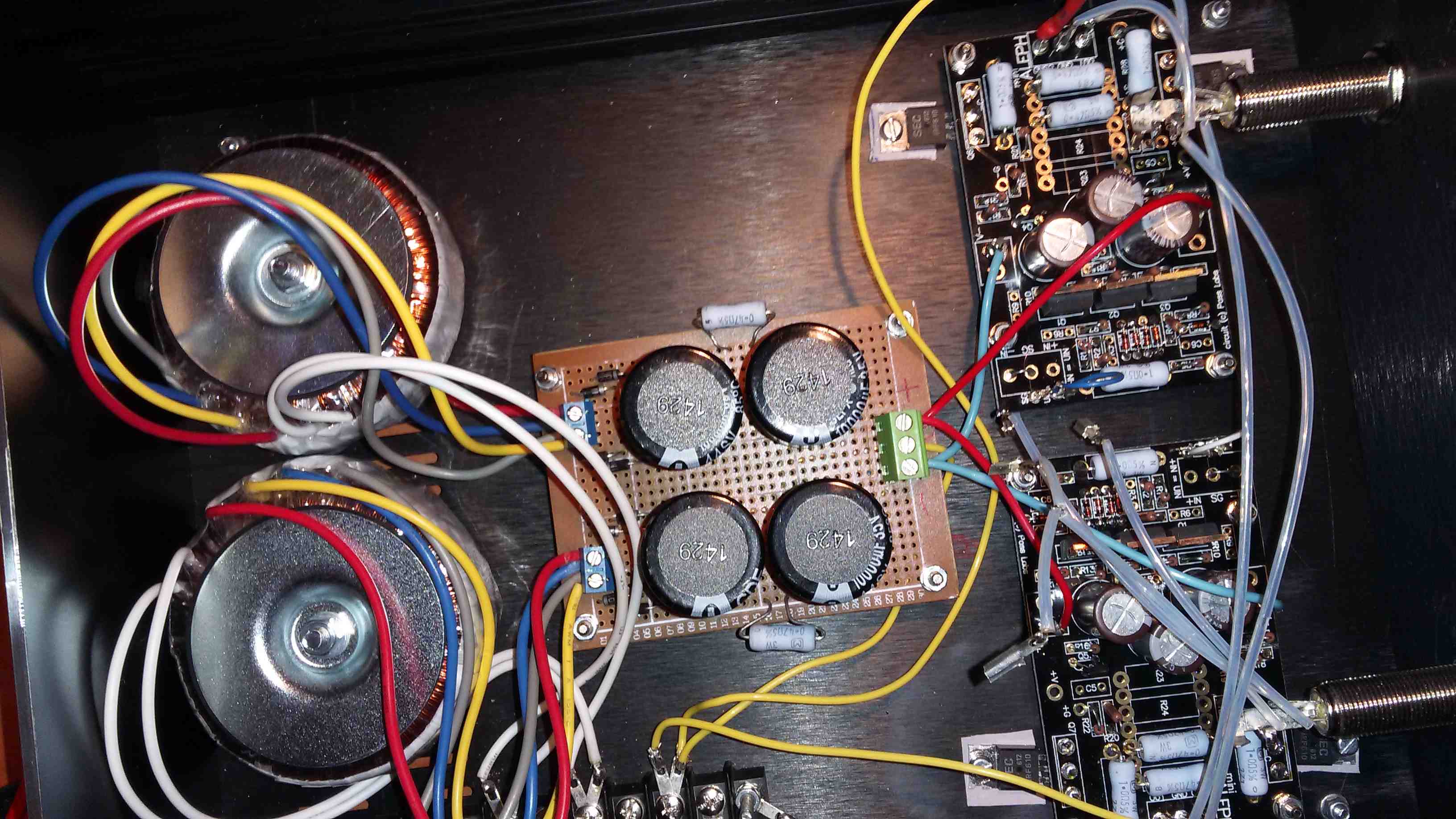

Amp is completed and working. Attached mobile phone photo (inputs grounded).
Measurements:
PSU under load (after ca. 20 min) +12.5V and -12.5V with 59mV ripple.
After 20-30 min top of Mosfet case is 40-45 C according to IR temp sensor, so it seems the bottom plate is an adequate heatsink.
Voltage drop across R29 and R35 1R resistors (Metalman's post#1 schematic) is 472mV and 468mV. I assume that current is aprox. 470mA and power consumed is 2 x 12.5 x 0.470 x 2 = 23.5W.
With inputs grounded and after ca. 30 min switched on the DC offset is about 40mV.

hum without anything on inputs?
Yes. Inputs shorted as in picture, hum remains.
We'll need more detailed pics showing the complete wiring. What's up with the lose wires/connectors in the pic you posted?
Is everything (inputs, outputs, FETs) isolated from the chassis? Smooth DC offset will generally not cause hum. I'm not sure, but maybe psu filtering capacitance is too low?

Thanks for your replies.
Loose wires in pic were inputs that were disconnected in order to ground inputs using short jumper wires.
I just checked and the Neutrik 1/4" jack is not isolated. Had incorrectly assumed it would be. Everything else is isolated from chassis.
Drawing of xformers and psu attached.
Realise the chassis connection of the 1/4" jacks is not ideal. Tried the following to see if I could get rid of the hum:
a.
removed front panel from enclosure and laid on top of enclosure with bubble wrap between panel and enclosure (i.e. electrically isolated).
hum remains
b.
panel as described in a.
signalground of both input and output jacks are connected to chassis, so a possible grond loop. Disconnected input signal ground connection.
hum remains
a.
hum remains
b.
hum remains
Moved star ground 3 inches to front, further away from toroids and 230V wiring. No change. Am running out of ideas. Any suggestions would be appreciated.
Wiring of PCB:
2 seperate wires (RED) from V+ PSU to V+ on PCB
2 seperate wires (BLUE) from V- PSU to V- on PCB
single wire (YELLOW) from 0 PSU to star ground and 2 seperate wires (YELLOW) from star ground to CGND on PCB
Input 1/4" jack connected to SG and UIN on both PCB's
Output 1/4" jack connected to GND and OUT on both PCB's
Because of non-isolated 1/4" jacks, front panel removed from enclosure (no longer attached so electrically isolated).
Because of possible ground loop due to shell of input and output jacks sharing the front panel, disconnected input jack wires from SG on PCB.
