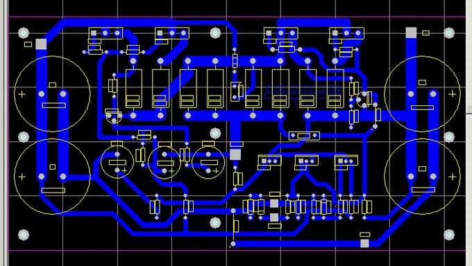

I think it should be a bit more wide.
Only on that areas, where the current is higher, than normal. You can check in the schematics easily (FETs drain, source and power resistors, output, etc).
I would go up to 120-150mils, or even more...
Especially at drain, source and power resistor and out areas.
But, it is depend on you, of course.
In construction I would use 70um copper FR4 (hard to get it)
But the normal (35um) is the most popular.
Do not go down to 17.5um FR4.
I post now my version (NOT final) of Aleph 3 pcb.
I am working on it to get a little bit shorter signal path, but it have to look nice also. So, I have criterias...
This is some kind of mix from Kristijan-k and my ideas.
BR,
I've updated the layout above according to these considerations. The traces from ±35V as well as the one to the power output resistors are now 200 mils wide. The only one which is smaller (125 mils) is the one between the output power resistors and the SOURCES/R pad (right).
