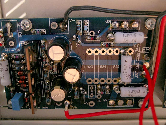

Ok, guys, I have a bigger problem -- There is only 4V between -V and -G on the board (and negative daughter boards, respectively). Everything is ok(~28v) on the positive side. PSU gives 33V to the board.
Any ideas? Could I damage input transistors while soldering? I really need your help as it is my first ss DIY serious amp!

Thanks Steve 🙂. I'll try a little bit more: i have 28.5 V between -G and ground. On the positive part its only 4V...hm...
I tested input transistors with multimeter I get some readings if i touch: neg. on source then switch pos. from gate to source.
Hm, or there should be 4.8V between -G and -V as it is exactly voltage drop on R14(18).

I zoomed into your picture around the RCA connection, i do not see the jumper in place, did you connect on underside? I do not have pcb in my hand but you should need to jumper -In to InG, IIRC
This would increase the volume for sure!

Yeah, -In should be jumped to SG....
grab a test lead and touch to the pad, should be sweet music!
