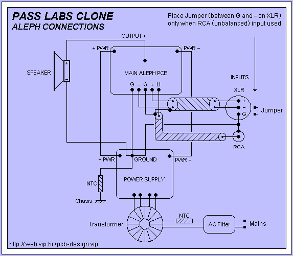

Kristijan by mistake posted this picture.
should the overall wiring be like this?

Mad_K said:
All grounds is taken from this point in the chassis (star grounding). Absolutely no hum.
Someone correct me but I thought the reason for using the NTC in the earth line was to raise the circuit ground several ohms above the chassis/mains ground. That is the mains should earth to the chassis, then the circuit earth should connect to this point via the NTC .... ??
My description of this comes from the construction notes for the Balanced Line Stage
Earth ground from the AC cord is attached to the chassis for safety, and is connected to the circuit ground through a power thermistor (bright idea from Frank DeLuca). This gives some resistive isolation for prevention of ground loops but goes to small values of resistance in case of catastrophic connection to the live AC line.
cheers,
mark
No need to correct, that's the way I did it too, but I have hum as well.😕
What about the XLR jumper in between G & - .
Or having ground point (star) after NTC that comes from AC ground, if you reed carefully Mad_K note, not on the Capacitors board it is a big no no. 🙂
The way I have connected my Aleph, is with AC ground -> NTC -> chassis. All grounds is taken from this point in the chassis (star grounding). Absolutely no hum.
That is exactly what I am going to do.
Trigon.😉

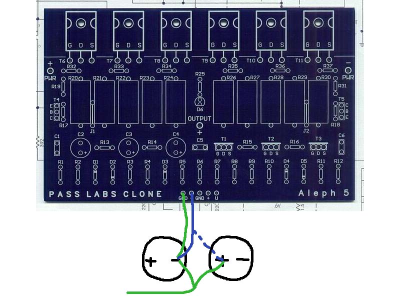

Hi all!
I kinda solved my humm problem.
In fact the humm is gone, but the problem is STILL in my head🙁
I said that I connected the minus input to the PSU ground.
That is true.
My PSU ground is in between two caps wich are connected witha Y cable connected to the bridge rectifier.
I have also a ground wire that comes from the board and is on one of the capacitors, so electrically connected to the other via the Y cable.
IF I CONNECT this wire to the cap with the ground wire, all is fine.
If I CONNECt the wire to the other cap (that is electrically connected) a good humm appears..
WHY????
This appened in both channels.
Peter Daniel,
No. Its one or other.
the dasshed config is the buzzing one.
neverteless, you say that if a loop (circle is created) hum appears?
if you have a twin separate conductor that is joined at both edges that is a loop?
why is that?

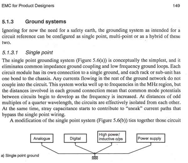

The folling text/image is taken from "EMC for product designers" SE by Tim Williams
The figure shows the concept of single point grounding, disregarding for now the safety earth.

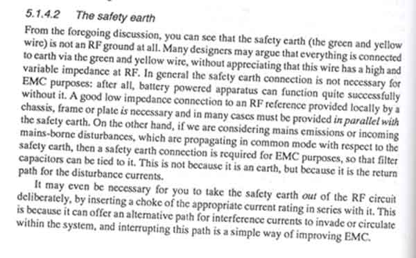

safety earth
The following text/image is also taken from "EMC for product designers" SE by Tim Williams
Regarding safety earth and the NTC in series with this earth, which is in paralell with the chassis earth connection. See also Passlabs Aleph 3 service manual, page 6 (schematic).

Hum in Aleph
Olá PedroPo
The hum and busing that you have when you connect the blue dotted wire is because you have a diference of potencial between the +and- of the electrolitics...they are connected together but in their conection is passing a very strong current of riplle..the current that charge the condensers with a very high armónics content.
When you conected the blue to the - side of the electrolitc you are conecting together the grounding of the PCB and the input . In this case the voltage betwen the + and - side of the power supply don't metter.
Cumprimentos!
