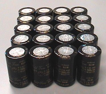

I'll be using 20 x 15,000uF (300,000uF total, 150,000uF for each channel) 63V Nichicon caps for the PS and 43CTQ100 (40A,100V) schottky barrier rectifiers for the bridge.

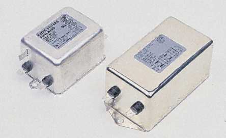

Is it advisable to use RF filters at the AC line for the Aleph 5 PSU? I'm thinking of using this filter:
These RF filters give high attenuation in both differential and common mode. Extended low frequency performance makes them suitable for industrial frequency converters, motor drives and switch mode power supplies. A combination of X2 and Y class capacitors and a high inductance toroidal choke give high performance especially in applications where interference is frequent and intensive. Electrical connection is by 250 (1/4in.) terminals for soldering or push-on receptacles. (Please refer to the Connectors - Terminals/Test Leads section).
Approvals: VDE, FI (only applicable to 6A and 10A types).technical specification

I'm using a switched, fused, filtered IEC mains socked for mine to kill several birds with one stone.
