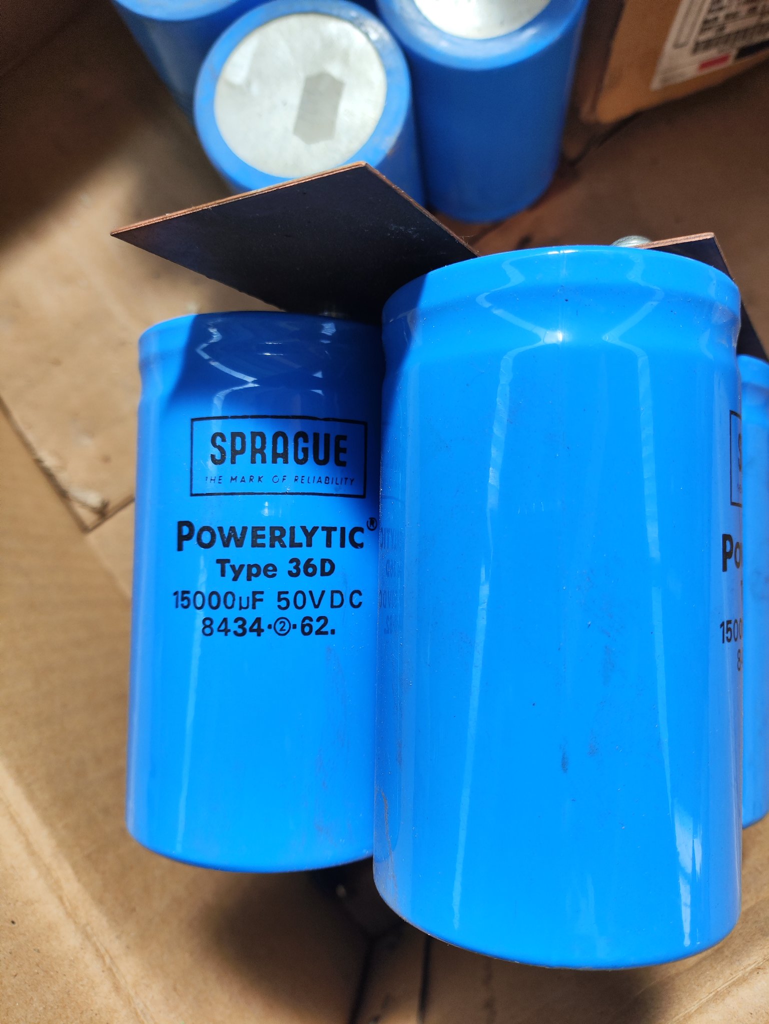

I think the originals were 25,000uF. I replaced those four with two 68,000uF Nichicons I got from Mouser. Not cheap (~$100 in U.S.), but not too expensive for extending the life of the amp another 25 years.
I bought them a few years ago new from a warehouse for €30, the transformer is a 28-0-28 so no voltage problems
Could I ask about ripple current @100Hz capacitor in ALEPH 5, which one is suitable (min or max) ?

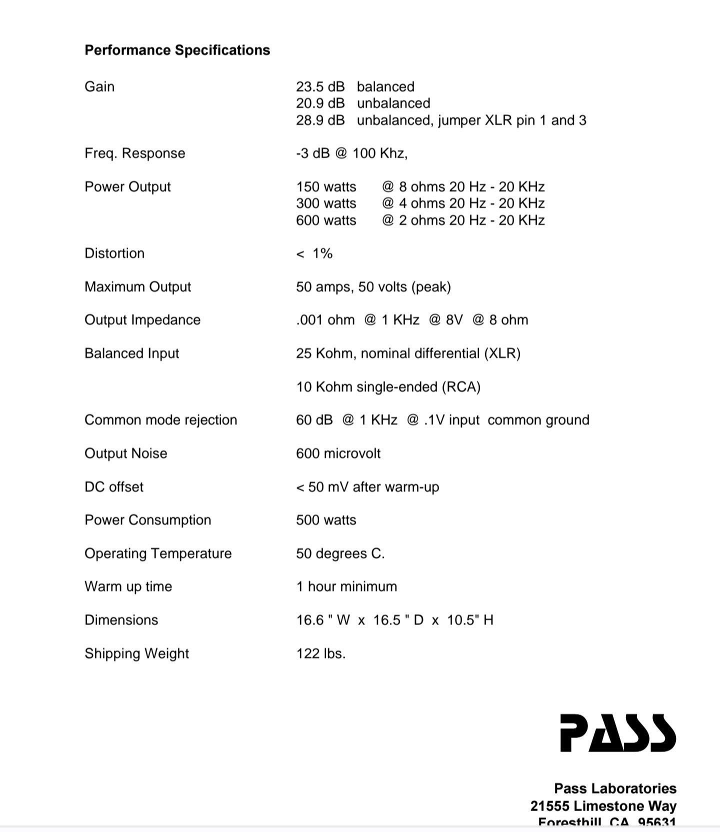

I have a pairs of ALEPH 1 first revision. I can't hear any hum & noise from the output but its noise floor as show in the owner manual not a good spec (600uV)

The sensitivity of your speakers determine how loud the noise is to your ears, assuming that your hearing is not impaired.
Here is a SPL calculator: https://mehlau.net/audio/spl/
(Voltage)squared x (speaker impedance) = Watt
So for 600uV @ 8 Ohm, P = (0.0006V)x(0.0006V)x(8R) = 0.000 00288W
