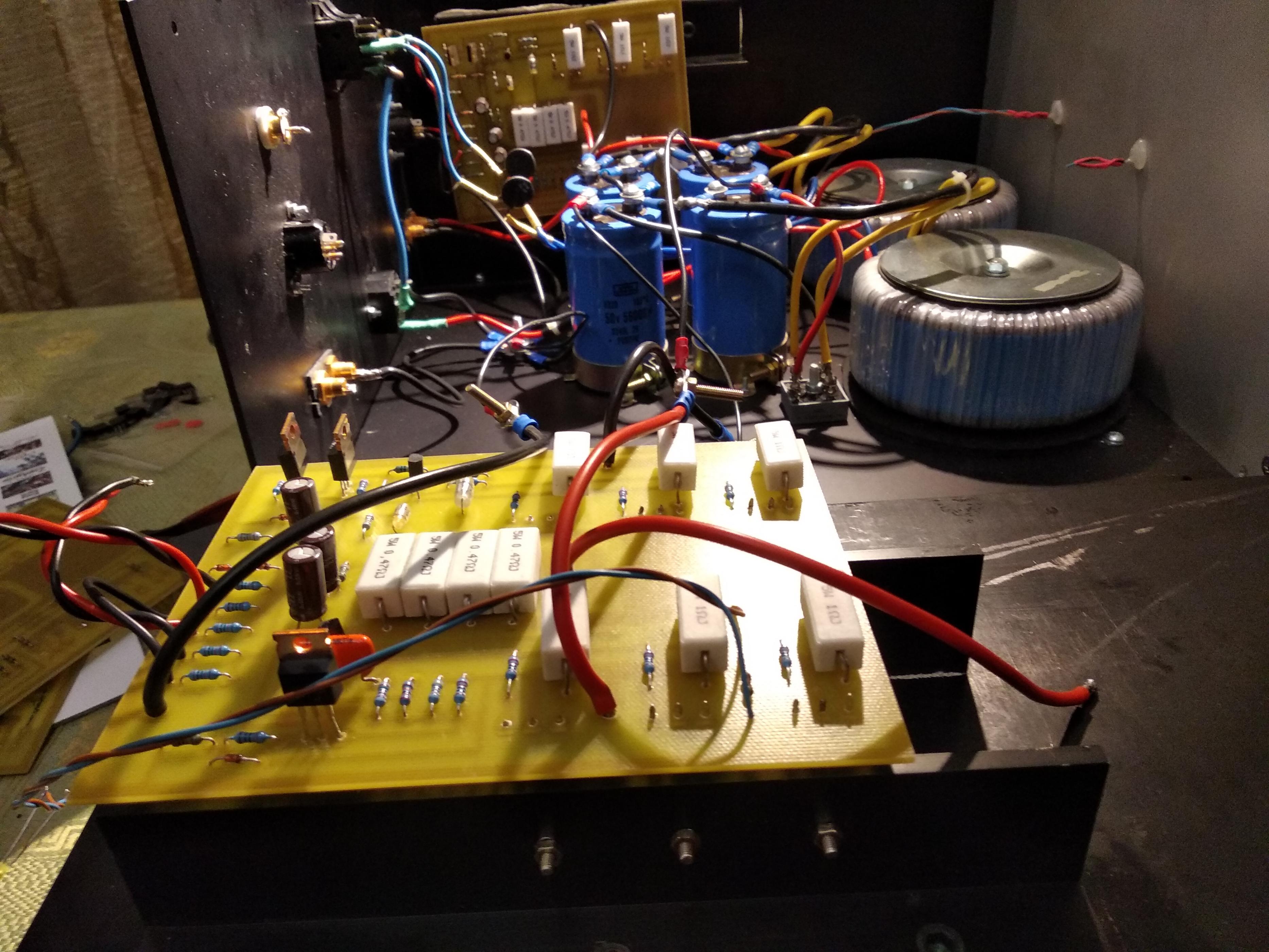

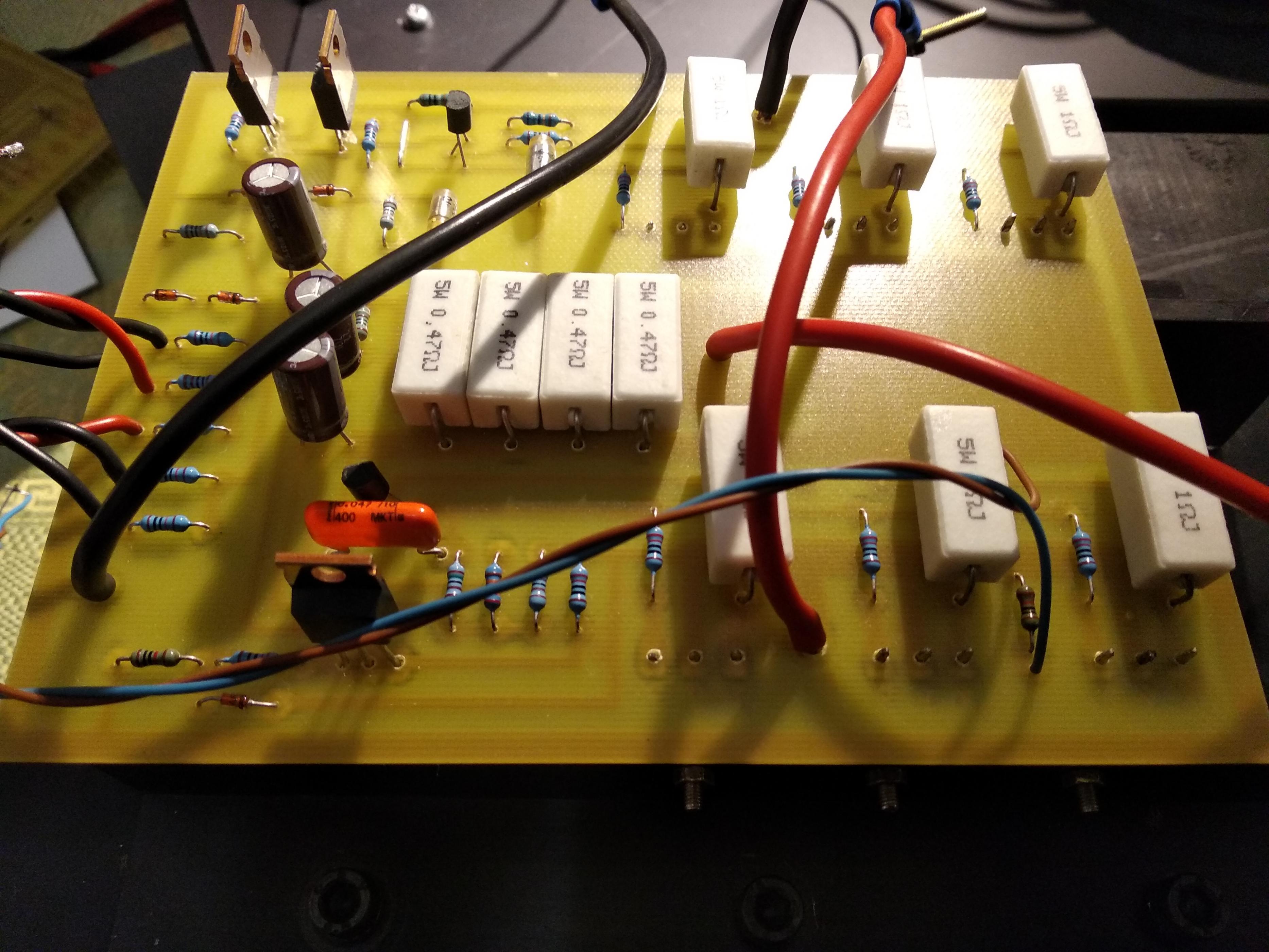

My finiss version of aleph 5 refuses to start (left channel).
Right channel is fine ,measurments according to manual.

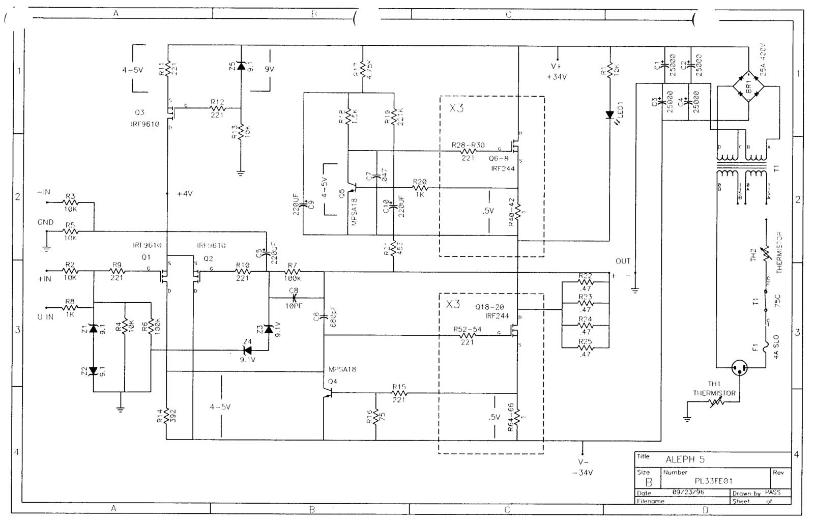

On left channel there is no bias across R64-66 and R40-42.
Z5 9,1 V.
Q5(BC550C) no voltage across E and C.
Q4 3,66 V across E and C.
Output dc offset 78 mV.
On speaker only ham.
Any help ? Thanks and MERRY CHRISTMAS to all of you !
Hi everyone ! I wish a happy new year to you all.
After the Christmas vacation I checked everything again and ...miracle... I discovered that I forgot to solder R20 resistor .Its amazing that after adding that everything is OK .
The sound is fantastic and I want to thank all members who replied.
