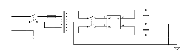

If you didn’t mind flicking two switches, could you simply install a second switch after the power transformer?
Flick the first switch .... count to one .... flick the second switch.
yeh, i am doing the same with with my 1970's rotel amp - it gets annyoling and i would much rather have a automatic solution such as a thermister - especially since they cost about the same price as the switch

In response to Equilibrium, if your going to flip two switches why not leave the main supply on all the time and only turn on and off the second switch? Would it be dangerous to leave current running to the transformer all the time?
I don’t know, but it seems that every schematic I’ve seen places the power switch before the transformer and I just figured it was for a good reason. Otherwise why not simply place it after the transformer just like you suggested if doing so would fix the inrush problem? My guess is that you don’t want the power transformer “hot” 24/7, especially with no load on it.
KenP said:
I'd be interested if anyone could say why it wouldn't work. Would the transformer get hot when drawing no current?
I don't think so. It would just burn a few milliamperes... say 10-30 (dipends on quality) with a toroidal one of say 800VA due to internal losses. But this will not save you from inrush current of charging condensers... nor keep your amp circuits stand-by warm... so I don't really see a use for it.
