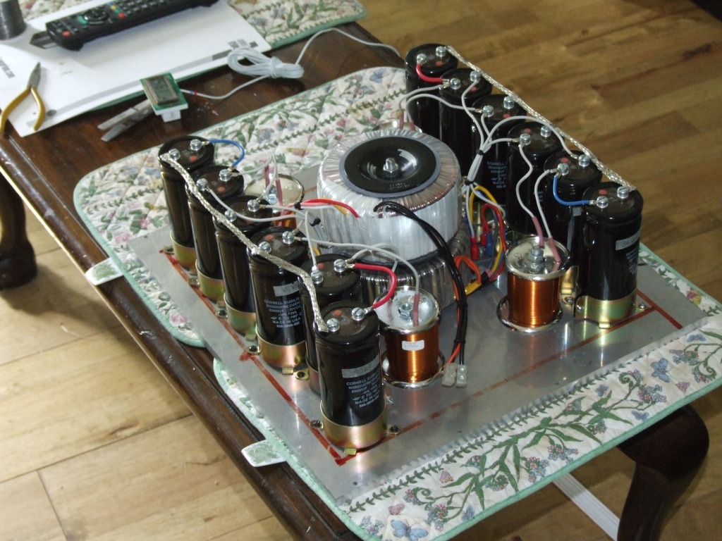

The ohm-meter measurements are:
16swg 500g 0r24
1.8mm 1000g 0r17
2.12mm 500g 0r07
The mega 328 DCR results are codswallop.

That's more like it. Thanks. Not sure when I will get round to getting the inductors sorted, in the next few weeks. Ill post results then.
Your inductors really should have a laminated or gapped cut-core to keep the DCR down and the inductance up . Do you just need a single choke of a few mH ? I may have a few orphan chokes suitable , I can only use in pairs

It was my original mistaken thinking I needed an AC choke. What is actually needed is 4 DC filters, large enough not to saturate from the DC current. The Hammond 159zl seems like it would be ideal, I have seen others recommend Erse inductors, and Jantzen air core.
But at $100-200 for a set of 4 for these options, I can wind my own for around $50 in copper wire. The down side being it will be larger, but my chassis has room, and slightly higher DCR which in this case, shouldn't be an issue other than a little voltage drop.
You choose your DCR by selecting the copper wire diameter appropriately.

This is my first amplifier build. Having spent 5 years living in Florida and now back in the UK, I can tell you the availability of such thing is much less. There is one of those chokes you mention on ebay in the USA for $30 or so, if I could just get 4 of those for that price I probably would.
I have one amplifier up and running with CRC, 45000uf-0.22ohm-45000uf. Using the balanced input I have no hum on my 99db sensitivity bass driver, and a little hiss on my 105db or so horn. I have no way of measuring it as I don't have a scope, but I'm happy with the current performance, I will be interesting to compare when I get round to adding the inductors.
Measure the PS rails' ripple with your DMM in mV AC?I have no way of measuring it as I don't have a scope, but I'm happy with the current performance, I will be interesting to compare when I get round to adding the inductors.
Oh didn't think of that, Ill report back later.
0.023v AC on the negative rail.
0.030v AC on the positive rail.
No reading on the speaker terminals in AC, 0.027v in offset DC.

This looks like it confirms your DMM set to AC voltage does not read the DC voltage bias on the AC signal you want to measure.0.023v AC on the negative rail.

I have 4 DMM from ultra cheap (<£3) to a Bench type and all 4 ignore the DC voltage when measuring AC.
The AC ripple on your supply is very approximately 3 times the AC reading you have measured.
i.e. you measured 0.023Vac = 23mVac and that is ~ 70mVpp ripple.
Try to buy a DMM that has an AC scale that reads 199.9mVac. They do not need to be expensive. My <£3 and my £9 versions both have these more sensitive scales.

My meter has the 200mV setting, which is what I used. It read 23 and 30 respectively. This was on the 34v rails, I had assumed it would ignore any DC.
I'm not sure I have anyway to improve this beyond adding the inductors, or if it even needs improvement, all of this is rather new to me. At least I have a baseline measurement to compare with future changes.
I plan to get a dummy load and at least use my pc and a software scope/rightmark to at least check there is nothing terribly wrong.
For ClassAB and/or other low current amps (pre-amps) the supply ripple after the smoothing is usually low, expect 5mVpp to 20mVpp.
When a ClassA amplifier is connected to a ClassAB type PSU the high current increases the ripple to enormous levels.
Expect 100mVpp to 500mVpp.

Thanks for that, I was mostly familiar with the power supplies in class ab, and small scale regulated supplies, but these class A amplifiers are new to me.
I am limited by the tools I have available, of course trying to judge with the ear is fairly useless. The amps are to drive my horns in a 3 way active setup, the horns are around 105db efficient, I can only hear a low level of hiss. I am happy enough with the current performance.
I do have access to a decent fluke meter, I might borrow it to compare.
I'm going to need a scope, then I can measure things to my hearts desire.
