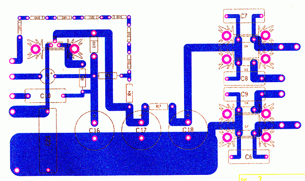

I attach a power supply pic for single stage diff preamp.
Will this power supply work?
Do I need to also change the 2nd last electrolytic rail cap to solen 47uf like the last cap on the rail which is also solen?
the first 2 caps will be 1000uf electrolytic cap.
I am using 60v sec transformer and slow start fred diodes for rectifying. The capacitor filtering the diodes is 0.001 uf. 2 low pass capacitors are 0.22uf wima and 10uf electrolytic. The resistors value and the regulator is the same as Aleph L power supply for + regulated voltage. For - voltage I will be using irf9610. Pic is only for + voltage.
I modify the powersupply from Aleph L preamp. I hope I won't be seeing fire works display on my preamp. Gain stage will be modified version of David Broadhurst, New Zealand.
