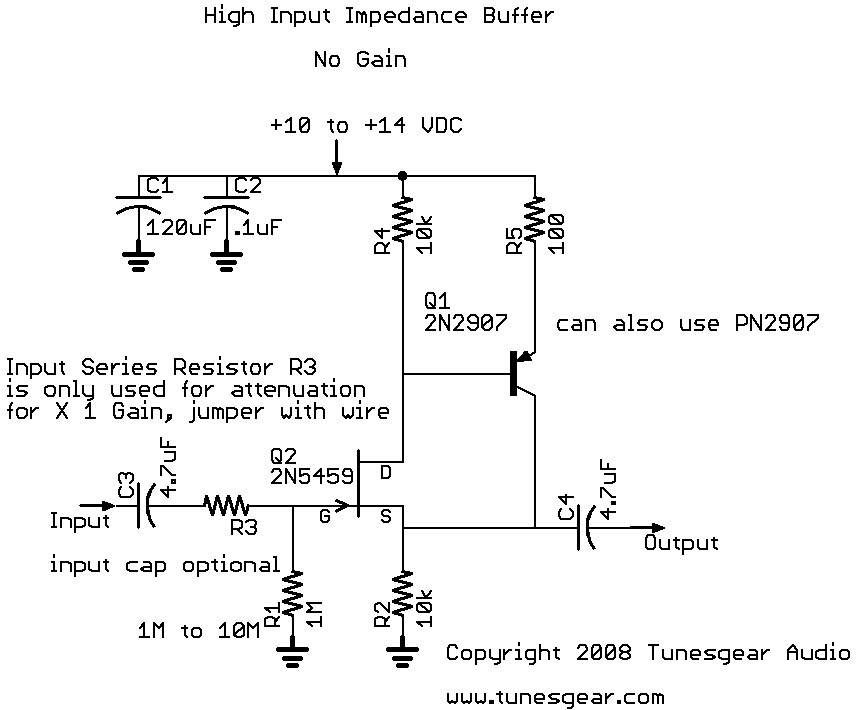

I need some advice on the maximum length of the signal leads for a pair of Aleph 4's. I know that they should be as short as possible, however due to limited space I would like to know what would be the maximum length that would not effect the performance? What problems may arise if they were too long?

PixelPlay said:Will the length towards 10 inches degrade the sound?
I consider the length as a part of interconnect line. I would try different lengths of interconnect lines to learn about the different sound. In general, I do not feel any sound difference when I tried different interconnect line lengths (0.5m-3m).
