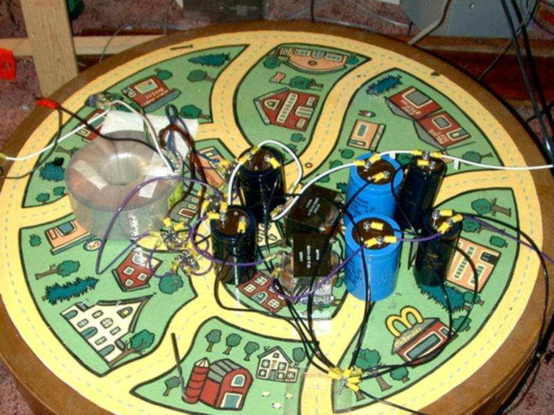

Continuous power should be:
400W per channel
800W / 115V = 7A Continuous
The turn on spike will be very large and will trip your breaker unless you use some in-rush current limiting. Still, I would turn one on, wait, and then the second.
Best option would be to run a 20A new circuit to your listening room. There is no guarantee that many other sockets, lights, etc... are on the same circuit. This amp deserves a separate dedicated line!!!
By the way, I wired up one channels power supply today. With my PI filter in place, the ripple is very low. Also, with the in-rush current limiter, I get no "light dimming". However, with two online, I think that I need the 20A circuit..
I have 18mF - 10mH - 60mF. I am also using a separate bridge for the + and - supplies with a dual winding transformer. Star ground point for all connections. I plan on designing hum out.

You should be fine with 2 transformers as long as you stagger start them...... it'd mean that total start up time for the amp would be around 1minute but i guess that really isnt too bad... i know of at least one commercial amp that functions in a similar fashion.
No problem at all. I have 4 amps with 750W transformer ea., no chokes. The only protection for in rush current are thermistors. I used to switch them all at the same time using remote trigger from my preamp. It took about 3 seconds for all of them to settle down. Everything was fine.🙂
