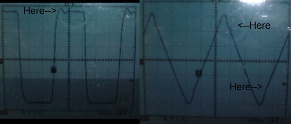

Aleph30 Distorsion
I Have distorsion quite easy to see on my Aleph30. Waveforms are ok at 1Khz, but a bump in the waveform can be see at soon as 10Khz, it is worse at 1Khz. Here the waveform, in 8ohms, at 10khz.
Any idea what can cause this distorsion and how can I remove it. One possible source, the AC gain feedback capacitor 220uf. I'm using a Panasonic FC type. Will it be better a Black Gate? What BG type?
Any suggestions?

Hi Algar_emi
I also noticed similiar distortion when I tested my A30, but discovered that it was my Scope's probe leads that caused it. I don't think that the type of capacitor you use will change this problem, although higher quality caps will sound better in certain cases. BTW, can you hear this distortion, how big is this signal, is it on both channels? Did you check for possible bad solder joints? I used standard type Nichikon and Rubycon caps on my A30 and standard type Elna caps for the PSU and they all sound very good singing together.
Hope you get the cause of your'e problem and can fix it.
If You increace C8 from 10pF to say 20 pF You proberly would get rid of it the instabilit at the 10KHz squarewave, but on the other hand You also will lower the hig rolloff.
Try it out, but I think it is oky as it is.

Algar,
I never heard such behaviour even with a 75% ac-current gain setting. Can it be that your amp is clipping?
This could be the case if your ac-current gain is chosen too low (under 50%) and your speakers demand the current but don´t get it.
william

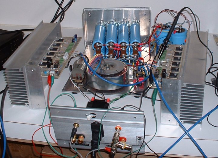

Aleph30 Distorsion and Traces routing
The Biais is 0.5A each, total 1.5A per rail, 3A total.
What else can be wrong? Do you have any test that I can do to start finding the problem with the DC offset?
Both my channels have the same behavior. So I exclude bad soldering and bad parts. Possible causes then are:
bad schematic to start with, but the amp is working so...

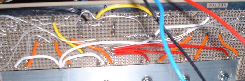

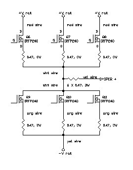

Bad traces routing. The more I think, my problem is maybe cause by the way I connected the FET using point to point wire. They are connected like this (See picture):
+V +V +V
| | |red wire (all AWG18 wires)
Q6 Q7 Q8 FET Current Source (ref Aleph30 Schematic)
|___|____|0.47 ohms and org wire
| wht wire
|______________________
6 resistors 0.47 ohms |
| yel wire | wht wire
Speaker out + |
|-------|---------| org wire
Q9 Q10 Q11 Active FETs
| | | org wire and 0.47 ohms
| yel wire
-V
I suspect That the single wht wire connecting both FET banks and the single wire connectiing the Active FETs to the negative rail are choking the current and cause current limitation in the circuit.
Any suggestion for the power traces and the speaker connection point

I don't think the negative supply leads are the problem
assuming the front end is also sharing exactly the same
negative supply, which is necessary.
As to offset, I assume you are using a cap in the feedback
loop. As your rail voltages are a bit low, I suggest that you
reduce the 4.75K resistor feeding the NPN positive bias
circuit to 3.3 K or so to compensate. This may in fact
cure your high power distortion.

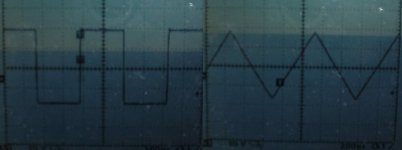

Aleph Measurements
Thanks Mr. Pass. Your help is very appreciated.
I will tried these tonight.
You don't think my wiring can affect the sound?
I will rewire one of the channel so each current source feed one Active Fet using its own wire.
Just to be sure the rest of my circuit is Ok. Here the complete measurements:

Vres is the voltage accros the 0.47ohms on each FET.
Are the FET correctly MATCHED?
