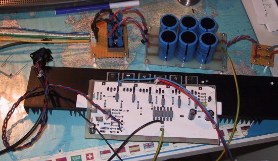

Ok, fired it up...
...and it seems to work. Runs VERY hot, due to my small heatsink. I'll change it tomorrow, to another small heatsink (though a little better). Now I have to make friends with someone at a junkyard, so I can get heatsinks cheap.
I got -0.078 volts on my output post. Is that way off, or within margin?
Best regards,
//magnus

It's alive!
Hi again!
Now I have tried the first board on my Aleph30. It works! Thanks a lot to all of you! Especially to Panos (panos29) and (of course) Mr Pass.
How much bigger heatsinks should I get for each channel?
I didn't get it to go very loud (fairly loud, but not VERY), but I think that has more to do with me using an attenuator instead of a pre amp. I measured the input (from the attenuator) to be +/- 2 volts max.
It runs very hot, so I don't think the heatsink vill do. It gets almost too hot to touch after just 5 minutes.
Well, now I have to build a really nice enclosure.
See ya!
//magnus

Heatsinks
Hi all,
Now I got my monster heatsinks (big, huge, fat *** heatsinks), but my Aleph 30 still runs pretty hot. Actually I found them in a dumpster!
I read somewhere that 55 degrees C is the limit where it is no longer comfortable to touch a heatsink. Well I believe I run it hotter than that. I'll do some measurements on my amp, but I'm in the middle of packing all my stuff down in boxes. The next month or so will be amp-less, since I'm moving to Schwizerland on tuesday.
Isn't it so, that oscillations can heat up the output FET's pretty much? I'll scope my amp and see what happens.
I finally got two pieces of 300VA transformers (2x18 V). Will post pictures as soon as I can.
