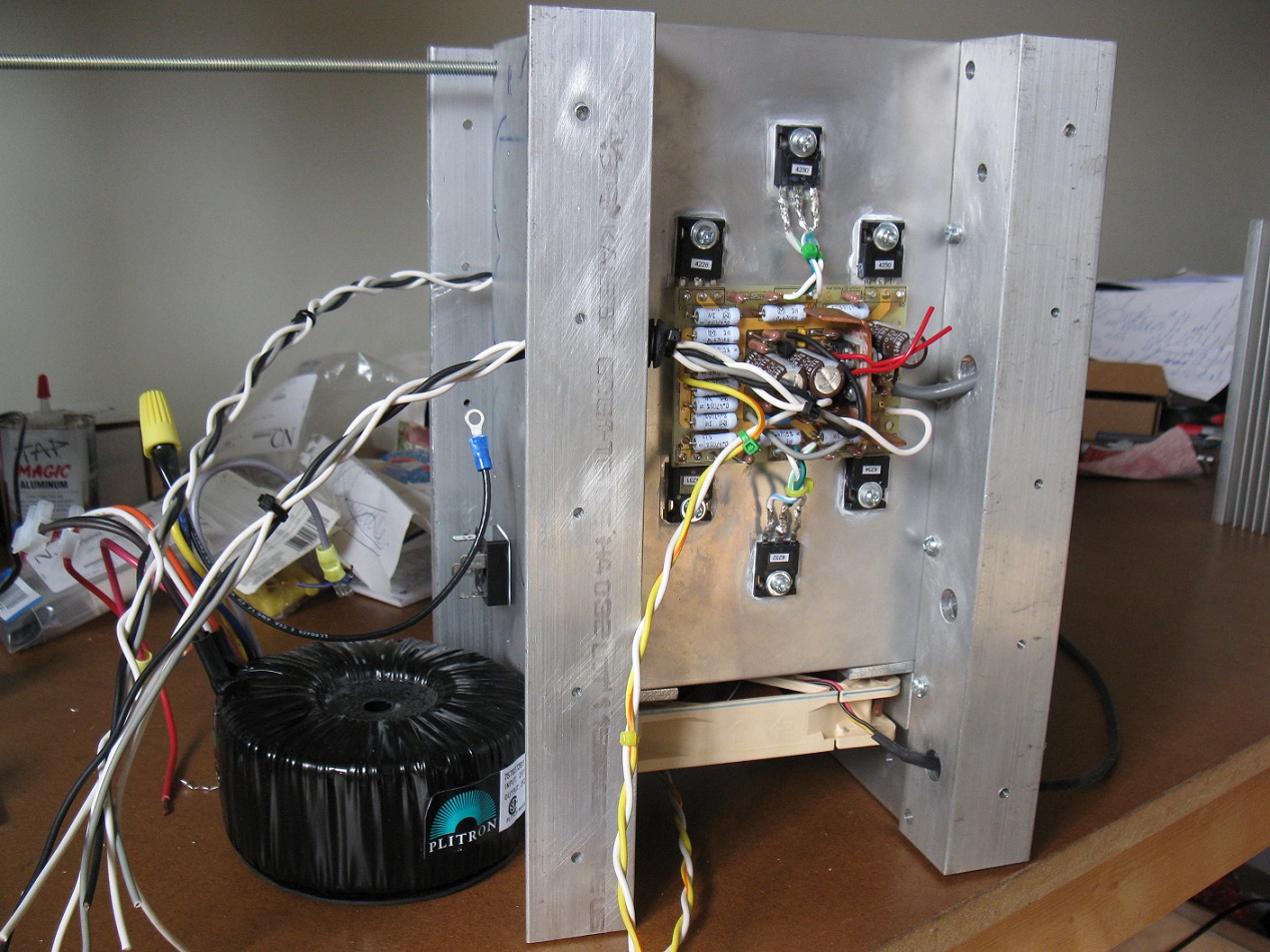

So as not to open a new thread on the subject: does anyone know the manufacturer of the amp board, because the three mosfets opposite each other would suit my chassis planning very well.

This is the chassis I want to use: BRZHIFI BZ2607 series double radiator aluminum case for power amplifier|Amplifier| - AliExpress
I want to distribute the MosFets on both heat sinks - the PCB then in their middle. Since the PCB side length is shorter, I would have to extend the Mosfets connections. How long can the connections PCB -> MOSFET be?

my estimation is that you can squeeze 70W of heat in that one case
leads can go from pcb to mosfets, but put heatshrinked gate resistor for mosfet on end of wire

since we are already talking Alephs: I have those Aleph30 pcbs fully assembled and collecting dust (they were used only for a year). Next Winter I hope to be making a mini Aleph to drive the mid/top section of my new speakers.
I was planning on making AlephJ with SemiSouths but the speaker section will be 4ohm impedance. When I see amp power output into 4ohm dropping below that which it does into 8ohm I kind of have a feeling that the amp is not really suited to drive a 4ohm load even when it comes to distortion (wrong?).
I also kind of remember Generg saying that the Aleph30 would have been his preferred amp to take to a deserted island (in my experience too the midrange was very nice; bass handling was poor). So I thought rather than selling off these A30 boards maybe I modify and try them: What do I need to change?
As I remember my original Aleph30 ran on +/-25.5V rails and had 3 output fets biased at 0.7A each. On say +/-17V rails do I only pull two out and re-bias the one left for something like 2A and then reset AC gain or is there more to it? Can you have a quick look at the schematic or should I move my question to miniA forum? Hvala.
