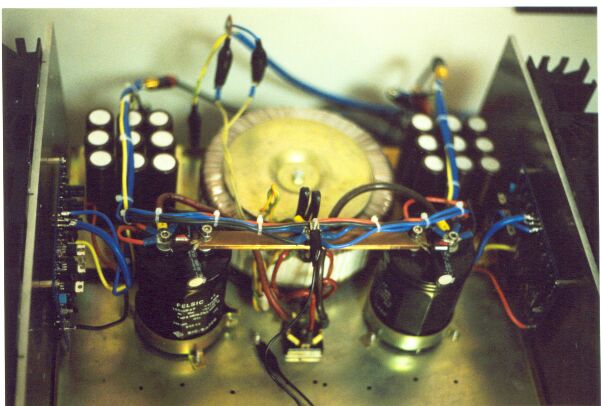

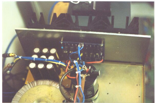

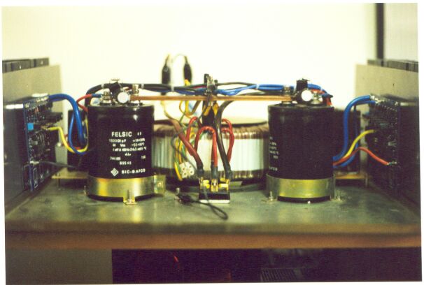

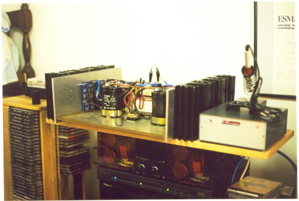

Hello to all,
Here the pictures of the prototype are, they lack to add 2 condensers of
150.000 uf.
A thing that was me very well was to put 9 condensers of
2.200 uF Nichicon URZA in parallel with 150.000, in high and sharp means, transparency. Not small condensers of 0,1uF...
Greetings.
Angel.
NOTE: Lament my not well English one.
150.000 uf.

Very nice, the big capacitators doesn't look very large (dimensions). Which voltagerating does these caps have?
The condensers are of 150.000uF 40V FELSIC it marks, but those of others
you mark they have similar dimensions, AEROVOX, etc...
Thank you Josep recommends you the detail of the condensers of 2.2000 uF it was
very good their result, guaranteed.
