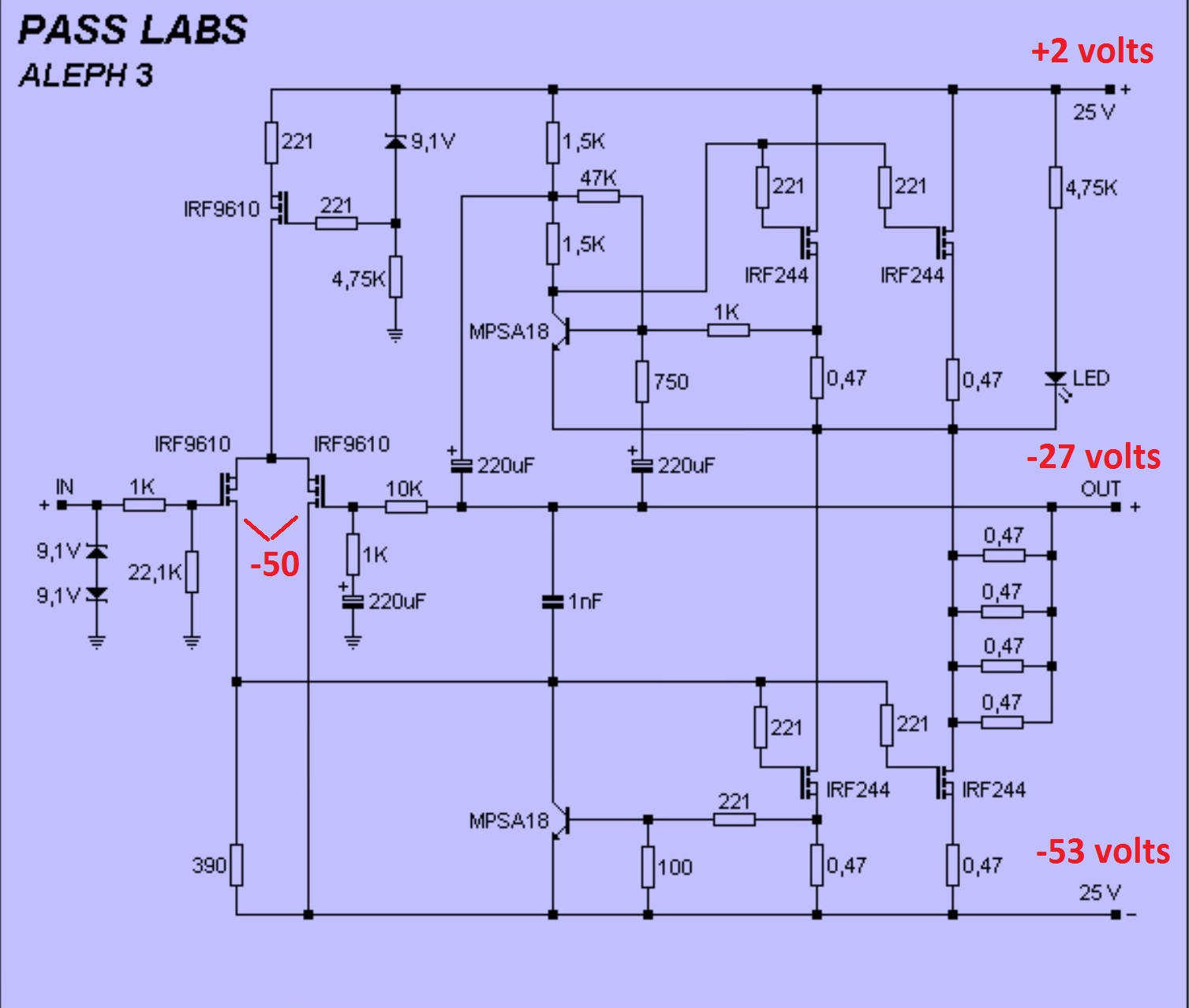

For starters, as always, post pics. Ideally post a schematic of the actual build showing wiring and with voltage measurements annotated.

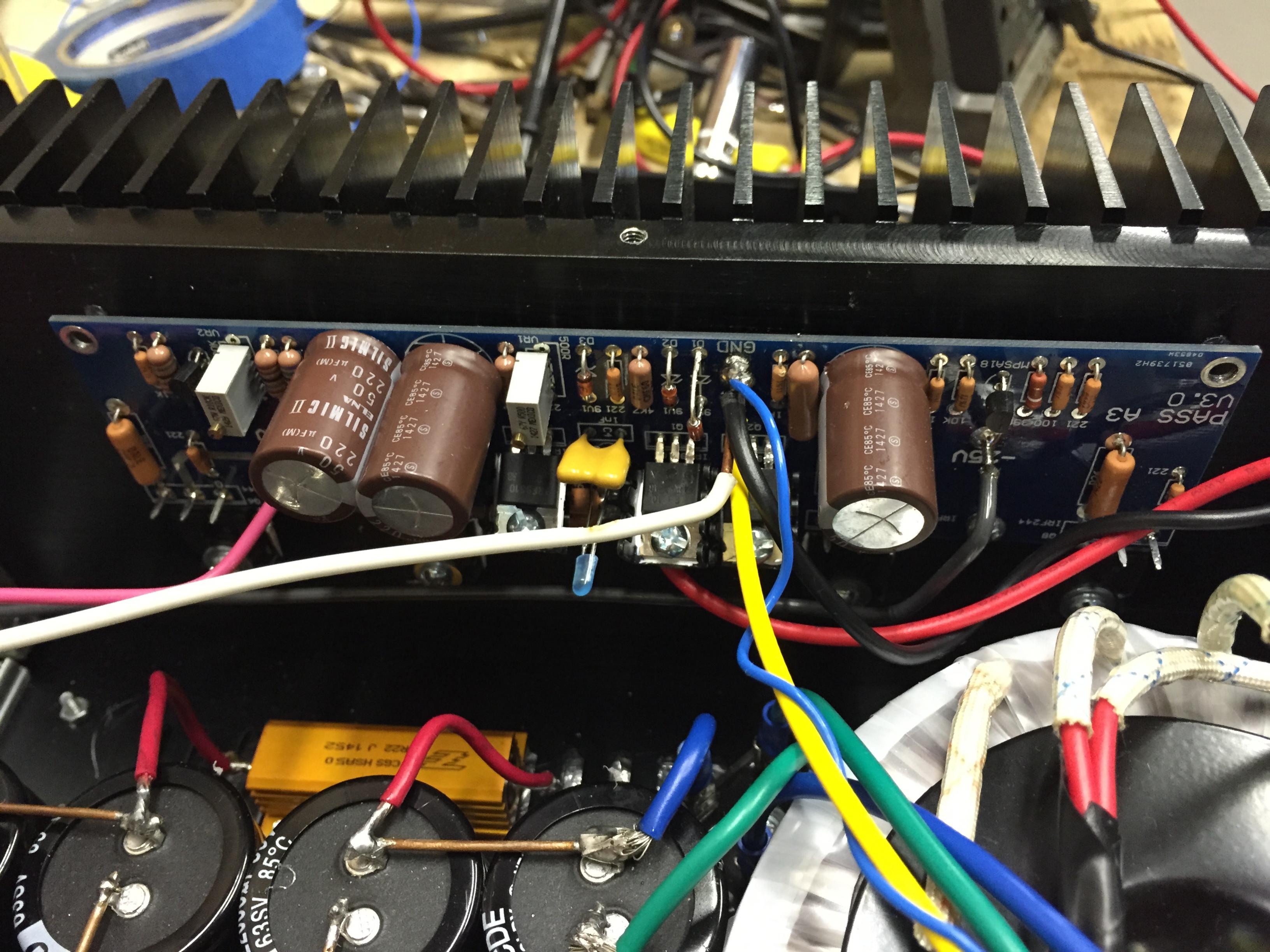

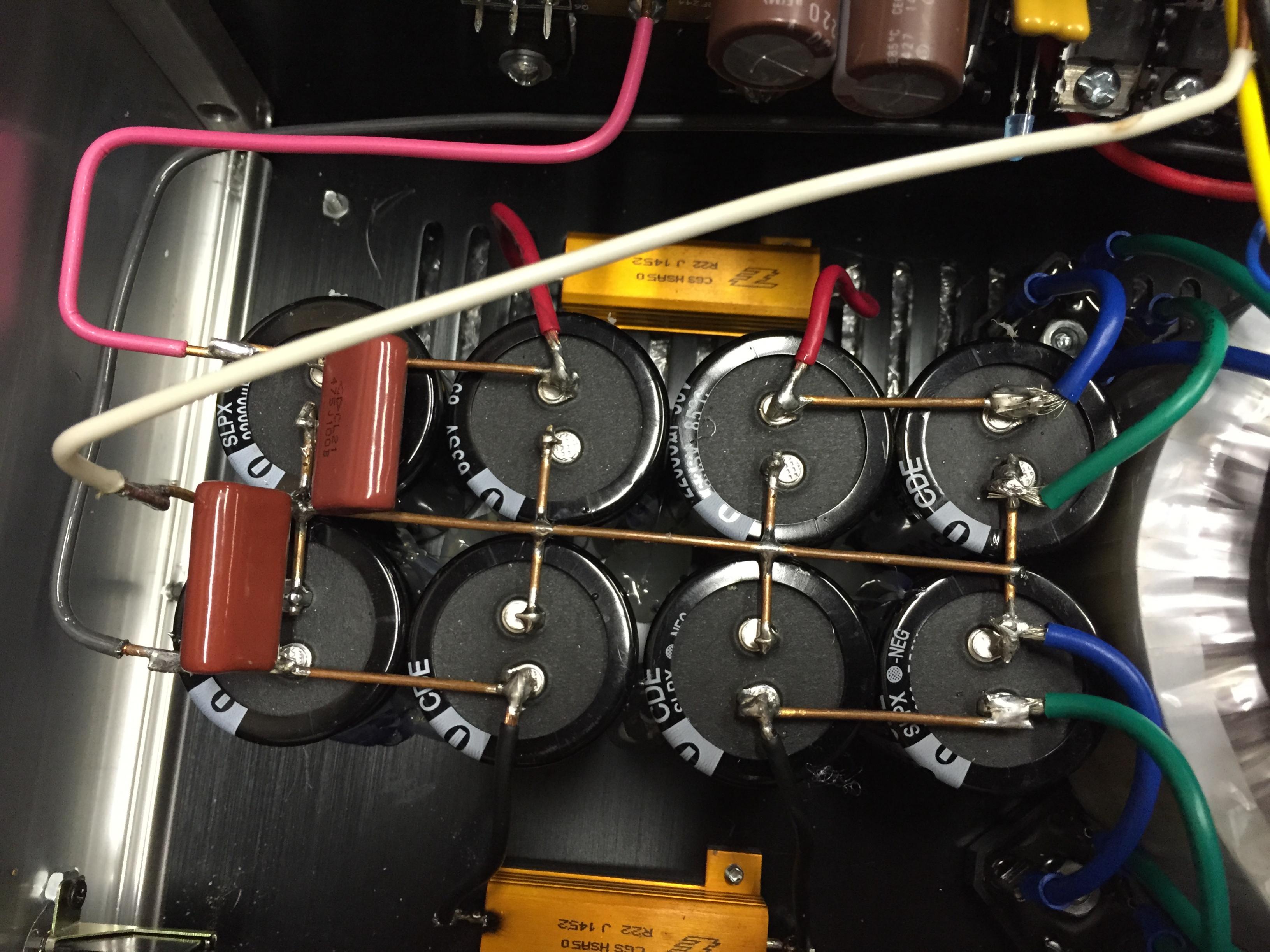

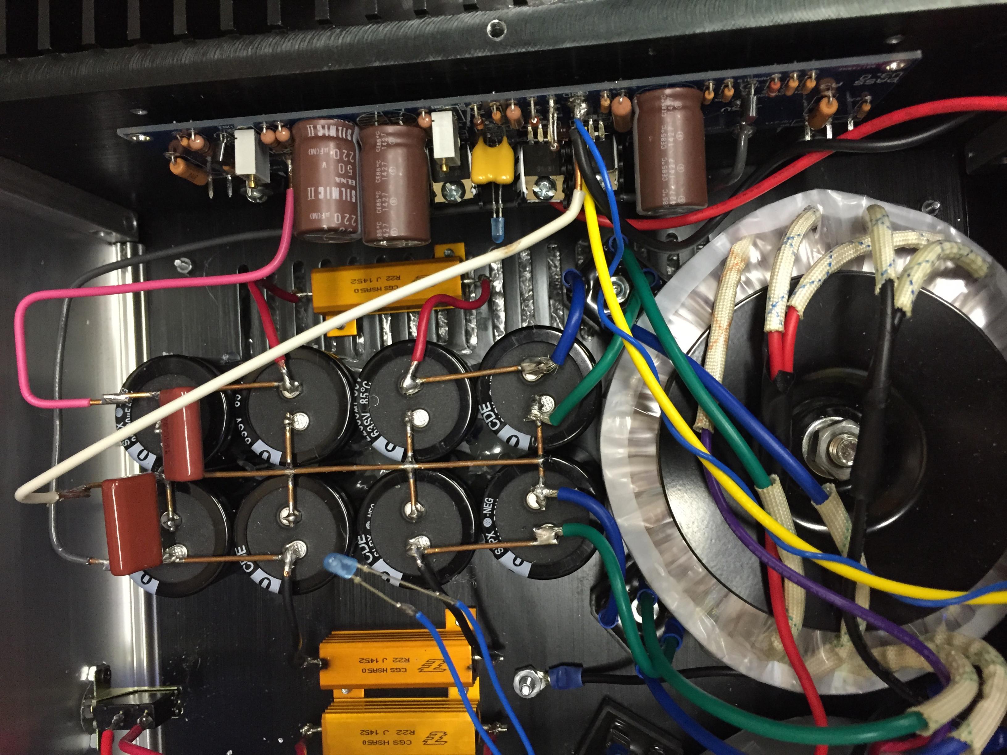

Here are some pictures as well as a schematic with measurements. Only difference as far as I can tell in the schematic is that I'm using 2 variable resistors to adjust bias and offset. All the measurements are done checking voltage using chassis ground.

using solid core fatties soldered to pcb is recipe for disaster
remove them , remove pcbs from heatsink and inspect is there any damage to traces

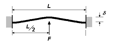

Solid copper is a rigid body compared to stranded, a wire will act as a cantilever at the solder pad.
Aka, fixed beam at both ends with uniformly distributed load.
Combination of vibration, cross-section area moment of inertia (I), and mass.

Sounds like you have a mis-wiring somewhere. Start in the power supply.
Check the transformer secondary wiring is correct. Amp off. Unplug the power cord from the amp. Unplug the secondaries from all the bridge rectifiers. You are looking for continuity. Find the pairs of secondary windings. Use a meter on Ohm reading or continuity reading. If you connect the probes at 2 leads and get a reading or a beep, they are a pair. If no reading or beep, they are not a pair.
Remove all power supply connections to the amp boards. Be sure you do not let a power supply (PS) wire drop into the chassis or touch anything. Remove connections from 0v on supply bank.
All this is a precaution. Measure the Plus and Minus supplies to 0v reference. At this point, we can't be sure it's a place between the cap banks. Use VDC multi-meter probe and test 0v on the cap bank to the ground lug on the IEC connector. It's also an assumption that the ground lug on the IEC isn't being fed voltage directly. Once you know 0V is 0V at the cap banks, then test the Plus and Negative side of the power supply banks. Both side should read the same voltage.
Before connecting any power to the amp boards, go over all the wiring for the amp boards: plus to speaker outs, where does the speaker ground go to? Amp board or 0v at amp cap bank? Check input connections to the amp boards. Pay attention to power ground and signal grounds where do they go?

It looks as though I've made a terribly embarrassing, and potentially dangerous mistake. I didn't use proper isolation on the transistors to the heatsinks. I've corrected the problem and the amp works as designed now. I'm feeling like I got away with one at this point. I'm waiting on a few CL-60s for the power supply and then after I clean up some wiring I think I'll be done. Except, I might remove the variable resistors, measure them, and replace them with low noise fixed ones. Is this something worth doing?
