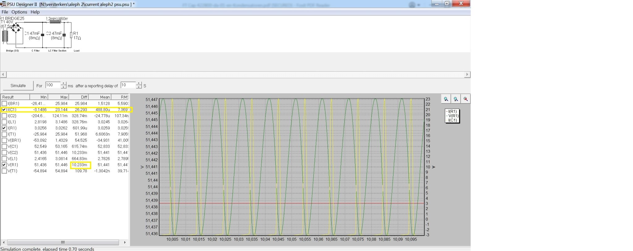

The power supply currently consists of:
  • Talema TRT1000240 1kVA 230V primary 2 x 40V 12.5A secondaries
  • Standard GBC type bridge rectifiers
  • CLC :
    • 47000uF/63V F&T GM
    • Intertechnik aircoil 2.2mH 0R46 (1.4mm copper)
The first problem I noted was of course that in this configuration, the rails will be much higher than spec (according to psu designer about 51V with an 11mV ripple). As the mains voltage where I currently live is 240V, I can expect another 2V, giving me rails of just over 53V. I understand from the service manual that the circuit will adjust bias automatically, resulting in a lower bias, so I expect dissipation to remain 300W per monoblock.
What alarmed me is that according to psu designer, the ripple the first 47000uF cap will see is double the rating of the cap (max. 13.2A according to datasheet). Not good.
The amp has not seen that many hours (I have too many amplifiers 😎) but the first cap could be seriously aged by this maltreatment. How can I check the condition of the cap? If it is still OK, I assume swapping the hard driven first cap with the hardly stressed second one will prolong life?
Obviously, the ripple the first cap sees has to be significantly reduced. Ideally the rail voltage should be lowered as well (the circuit will automatically increase the bias to accomodate for this). Just adding capacitance does not seem the best solution.
I remembered something EUVL said about adding resistance in the psu (when I tried to get rid of hum in my Aleph H). I played around with psu designer and came up with the following simple solution: Convert the CLC design into RCLC by adding 0R75 resistance before the first cap. (N.B. I also tried LCRC using the same values, but psu designer showed excessive voltages experienced by the bridge rectifier and a higher ripple at the load).
According to psu designer, with the RCLC psu the first cap ripple is less than 50% what it was previously (now within datasheet spec) and the rail voltage drops to 45V (from 51V). The resultant load ripple (simulated as 17R in CLC and 13R is RCLC to give about 150W dissipation per rail, to compensate for the circuit automatically adjusting the bias to keep dissipation constant) hardly changes (I surmise it is probably more dependent on the size of L and C2).
I assume this solution will add quite a bit of heat (psu designer calculates 6A RMS at 4V5 RMS through the 0R75 resistor, so about 54W per mono block). I will have to add fans for these Aleph 2s anyway, and especiially to survive the extra heat. I have some old PC fans of various sizes but am unsure if placement in the enclosure will give enough relief. Has anyone tried this?
Having had plenty of trouble with radiated noise recently while testing a newly built pumpkin in my shed, I am wondering if the placement of the coils in my amps could be improved upon. Ideally I would move the transformer and coils to another box (perhaps even try a regulated psu) but a 4 box stereo amplifer really is a bit too much. I have attached a photo of the current layout (don't take any notice of the old soft start to the right of the bottom coil; it has since been replaced by an NTC).
Will a steel cover over the transformer (if I can find one that big) and/or coils (assuming I have enough room to do this) make a big difference?
Any suggestions are welcome!

Regarding the concern of the first big cap in the CLC filter absorbing too much ripple current:
The big caps used in early Threshold amplifiers were industrial rated Mallory. They will have a longer life and higher surge voltage rating than most components from the era. To help them out, make sure you use an appropriate thermistor in series with the primary side (240V) of your transformer. I recommend MS22 20005. They will dampen the initial current inrush as the caps are charging and will be warm during operation. The residual resistance will continue to lower the primary voltage slightly.
I also recommend wiring some large 22 uF film caps in parallel with the big electrolytics. These will share some of the ripple current and help reduce the high frequency impedance of the big caps. Don't expect the PSU designer software to accurately model the ripple current distribution; it is really just meant for simple estimates.
Reactions: chermann
I echo ZM's suggestion on this one:
https://www.diyaudio.com/community/threads/the-aleph-design-reloaded.267857/
CLC is fantastic. Consider adding an RC to the CLC. So CLCRC. Try that in the PSU modeling tool. Aim to shave ripple. Don't try to burn off too much voltage, you'll have HOT resistors at A2 current levels.

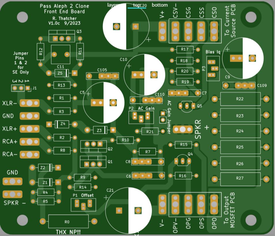

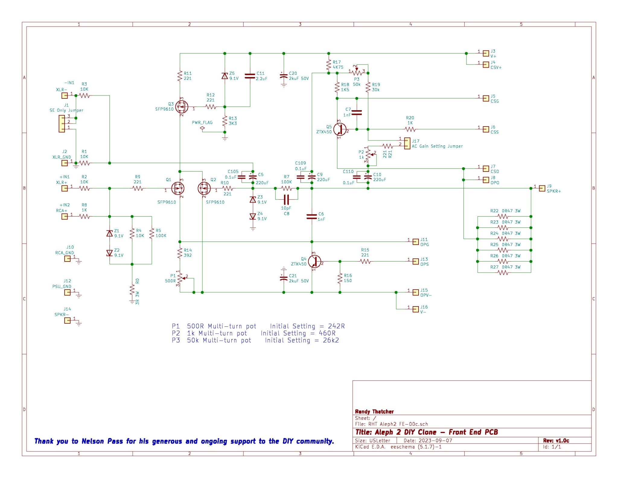

If you want to play around with the front-end board, your timing is perfect. Yesterday I updated an Aleph 2 front-end PCB that I did a couple of years ago for a DIY member's Rawson re-build. This new board has all of the enhancements built into the "Classic Aleph" boards in this thread https://www.diyaudio.com/community/...or-modern-ums-chassis-builders-thread.382316/, but in a front end only board. It has pots to adjust bias, AC gain, and offset, AC Gain test jumper, film bypass caps (optional), additonal rail caps, etc.
I'm getting some of these boards made to upgrade a Rawson F2 soon. If you want a pair they're yours for cost of shipping, or I can send some gerbers to you.
I also have a large stash of matched classic Harris/Fairchild SFP9610's if you're interested. Matched from a batch of 850. These are the ones Papa prefers in the IRFP9610 family. You could try to hunt down toshiba's for the LTP, too. That's a bit trickier, though.

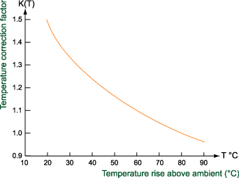

Heat
I realise the 4U 400mm enclosure does not have enough heatsink capacity to keep the 300W standard Aleph 2 output cool, let alone if I am going to lower the rail voltage without replacing the transformers. Having said that, I don;t want to buy new enclosures and would hate it if I had to change my amps to a smaller Aleph.
I remember that heatsink ratings are normally specified for 85 degrees C and a derating factor needs to be taken into account at a lower temperature (heat transfer is dependent on difference between heatsink and air temperature). The Conrad Heatsink website has some information about their heatsinks. Reading that it becomes clear that the 85 degrees often quoted is not absolute, but the rise above ambient!
https://www.conradheatsinks.com/technical-details.html#thermal
Conrad specifies their heatsinks ratings at 80 degrees above ambient and for 25 degrees above ambient a derating factor of about 1.4 is appropriate.

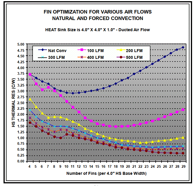

The 4U 400mm enclosure has 4 heatsinks, so effectively 0.38/4=0.095C/W. Taking a 1.4 derating factor into account, it comes to 0.133C/W. So, at 300W I can expect a 40 degree increase (which is only a bit less than I have found with my Aleph 2s).
I also remember that heatsink efficiency is greatly increased by airflow. An article I found on the Digikey website (https://www.digikey.com/Site/Global/Layouts/DownloadPdf.ashx?pdfUrl=F51974C9A6D544F1A7D8F119514B67FF) contains a graph that clearly shows the incresed efficiency at increasing airflow rates.
While this is just an example, it had got me thinking. Could this be an option?
Rather than a babysitter (as suggested by Zen Mod) under the amp, I am going to try increasing the airflow over the fins. I will mount ten 40mm fans underneath a 40x400mm aluminium strip and attach the strip underneath the fins.
Keeping the fan speed low (i.e. no noise) I still hope to create enough airflow to significantly increase the capacity of the heatsinks.
It will take me some time to work this out properly, but I think it is an option worth trying. If anyone else has attempted a similar approach, please let me know what your experiences were.
Front end
@rhthatcher Thanks for your very kind offer! I had recently looked at the pdfs in the "Classic Aleph Amplifier for Modern UMS Chassis Builder's Thread" (great by the way!) and was a bit jealous of the neat way you incorporated adjustment of DC offset, AC gain and bias current in those boards. Not to speak of the improvements (e.g. cap across zener).
I had to replace leaking psu caps on my Aleph P1.7 preamp and psu boards recently (also built by my late friend using KK boards at the same time, around 2006) and had some issues with one track lifting on the amp board. I was able to fix it, but a fresh board will be so easy to work on! I will send you a PM with my email address.
I have discovered that some parts my friend used in both the Aleph 2s and P1.7 were not great (e.g. the leaking cheap Chinese capacitors in my P1.7 and the cement resistors in the 2s), so I have no idea if the 9610s were properly matched (I can see on some photos that they are International Rectifier parts, marked 444P 1B 09, so I assume from the same batch at least). Your perfectly matched Harris/Fairchild 9610s are very tempting haha! Expect a PM soon 🙂
I bought 50 IRFP044N years ago, but have never got around to matching them (I haven't learned to match mosfets yet). They are in their original plastic strips (yellowed by age), so I assume they are from the same batch. If I get some really close matches I may consider replacing the output mosfets, assuming at their lower max. 55V drain-to-source voltage the 044s can be used in this amp. I don't which parts my friend installed and the way they are mounted (between the pcb and the heatsink) I can't even see them to check without dismantling the amp.
I assume if I check the resistance of the source resistors and check the voltage drop when the amp is warm, it should give me an indication if they were properly matched. Also, when I replace the resistors I will have to remove the boards from the heatsinks anyway. I think I will need to learn about matching and check the matching of the ones that are installed.
With respect to the caps to use in the front end I will refer to them using the original service manual part numbers.
C5: I assume it would be best to use a bipolar for C5 (IN- circuit)? Would a Muse bipolar ES be better than a Silmic II, Nichion FG or KZ?
C9 and C10: If I read the schematic correctly, the top of the caps would be at a higher potential than the bottom, so a polar rather than bipolar seems more appropriate intuitively. Do I read the schematic correctly? Is there a preference? I am not at the stage yet in my learning that I can determine the potential across the cap, so don't know what voltage rating would be appropriate. Can someone enlighten me?
@Zen Mod I only have 220nF MKC. Worth using one for each electrolytic, or do I need to add a few at each cap?

@TungstenAudio Thanks for the tips. I think the quality of the caps my late friend used are not the issue (they are big F&T 47000uF 63V cans).
What worries me is that psu designer predicts a ripple of -3 to +23A! At a ripple rating of 13.2A this seems much too high.
@rhthatcher Because my transformer is rated at 2 x 40V, my rail voltage is too high (psu designer predicts 51V). It is for that reason that I am trying to drop 5V with added resistance in the psu. According to psu designer, the ripple at the load (constant 17R load) is only 10mV, so I assume it is not really an issue. Going to RCLC only improves this marginally.
If I add 0R75 before the first C, the ripple seen by the first cap drops from 26A to 13A (within spec of the cap). I also drop my rails to about 45V, which is where I would like them to be. If I do decide to try this setup, I will use two 100W 1R5 in parallel for each rail. They will have to handle about 13W each, so should be fine. It is just the extra heat that will be a problem haha. But for that I have a cunning plan (see previous post).
one is enough
it just happens that I learned from Pa - when you find interesting part and you can buy it in quantity, you'll find many places where to put it
so, I'm buying Philips 1uF/100V MKC in 1K quantity, whenever I'm down to 50

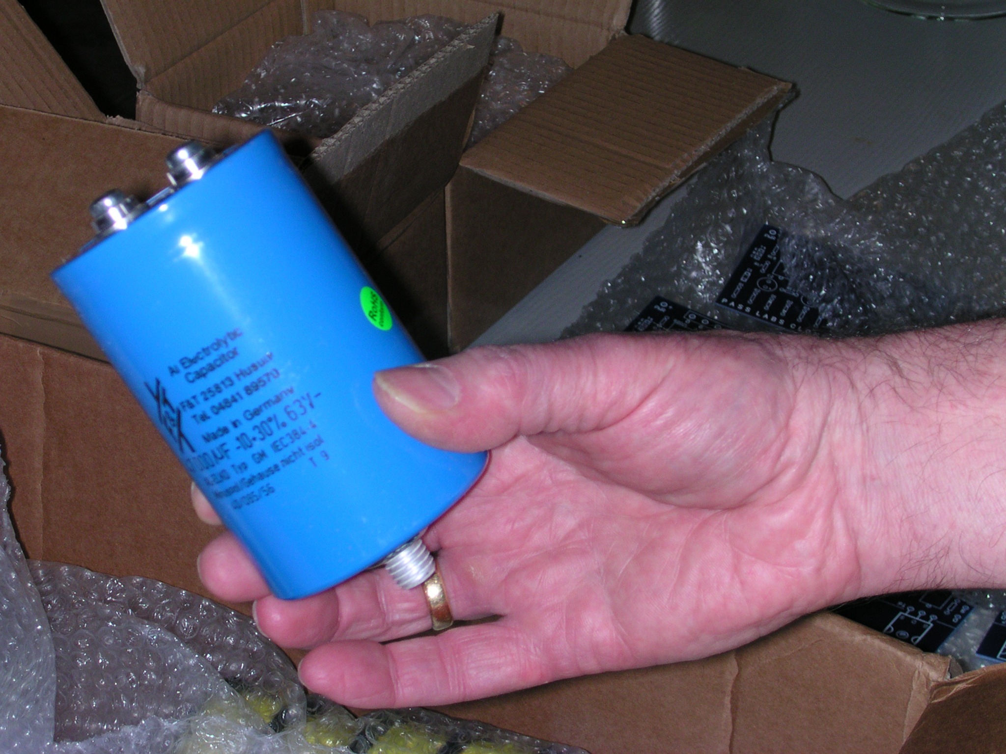

My Aleph 2 psu currently has 4 x F&T 47000uF/63V GM caps per monoblock. For as far as I can make out on photos they are marked "40/085/56 T 9". I can't find info to read the code. Does anyone know what the age could be? They were bought new in 2006 but it is unknown the dealer (not a big distributor like Mouser) had them on the shelf.
Has anyone used F&T GM caps in their poweramps before? Worth replacing?
Your thoughts are appreciated.
it's simple as this
if there is no hum and you're happy with bass - they're not "dry"
if you connect (temporary, but in proper way and with shortest wires possible) set of 50uF motor runs, and you don't hear substantial difference in highs, they're having decent low ESR on higher F
ZM boasting - I still have 10 or so Philips 47mF/25Vdc caps, having printed on them claim of 10A++ ripple current @ 20KHz; go figure - I don't care when these are made, I know they must be good whenever I'm going to put them in use
set of these (2+2) are singing in my own SissySIT; sadly or not, no space for motor runs in case
The amps haven't been switched on for a while but I am pretty sure there was no hum, so if that is still the case I will assume the large caps are not dry.
