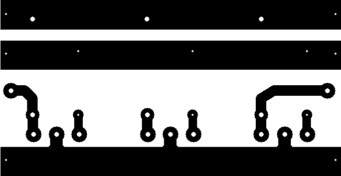

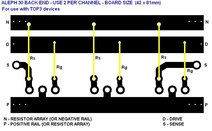

Here comes layout for the Aleph 30 output stage. Use this one if you have mosfets with TOP3 (TO247) package for example IRFP240. The layout posted above is for TO-220.
/Freddie
(I just did some changes to the layout, the holes were too big)

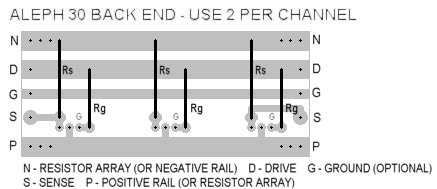

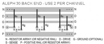

Grey,
I just finished making the layout for my Aleph 5 using yours as a starting point (thank you very much). I opted for double sided prints with a ground plane (saves etching fluid.........), using one eurocard (100x160mm) for two front end boards and one eurocard for four output boards. The advantage with euroboards is that you can get them with a thicker copper layer (70 mu).
There´s one thing I didn´t understand in your layout, the "from output devices (CS sence)" is used twice. Why didn´t you connect the emitter from Q5 with "from output devices" on the print itself?
And another question: What´s the advantage of R0? It´s used with the 60 but not with the Aleph 5 or 4.

William,
Since you're using a double-sided board, you can run the emitter of Q5 on the other side of the board. I set myself the task of making a single-sided Aleph board. I have nothing against double-sided PC boards, and in fact usually keep some around, but I found that I didn't really need it for this project.
If you think you see a way to sneak a trace from the emitter of Q5 around to the top of the resistor array, by all means do so. However, if you're using a double-sided board, a larger board, or run a connection to the interior of the board (instead of connecting at the edge), you've changed the rules of the game.
To me, doing a PCB layout is like assembling a jigsaw puzzle. I don't have any fancy software; I do the layouts by hand, trying several different versions, then keeping the best portions of each. It's a nice mental challenge. My goals are:
--No interior connections.
--Keep connections to as few edges of the board as possible. This isn't really strictly necessary, but it makes service easier if you can unbolt the board and get underneath while it's still connected. In this case, I managed to keep connections down to three sides, one side exclusively inputs, with no high current wires nearby.
--Keep signal traces as short as possible.
--Keep the overall board as compact as possible, while allowing for heat dissipation. I cut my boards to size on a band saw. If you want to use a larger board, then other options might present themselves.
--Use as few layers as possible.
--No jumpers allowed.
--To the extent possible, keep components lined up. This is purely esthetic--it makes my eyes happy to see nice orderly rows like that. I was particularly smug when I managed to get that long row together across the middle of the board. Not that it matters to anyone but me. Bear in mind that at the time that I did the layout, I hadn't really considered that anyone else would ever see the layout but me. As far as I knew, there were only two homebrew Alephs in the world, mine and Mark Finnis's. It never entered my mind that there would be so many other folks who would take on the building of an Aleph, or that I would be posting my layout online. I just did as neat a layout as I could imagine and went on from there.
Note that large regulated power supplies generally run an output and a separate voltage sense. The sense connection is connected to the load with a light gauge wire, as there's no current draw to speak of and hence no voltage drop across the wire. In this manner the sense/feedback circuit within the power supply is able to get an accurate reading of what's going on at the load without having to worry about heavy losses across the output cable.
That's similar to what I did with the Aleph layout. A fairly heavy wire (I forget what I used, 12 ga. maybe? doesn't really matter, it's only about 2" long) for the actual output, and a much smaller wire (about 20 or 22 ga.) for the sense.
The purpose of R0 (along with R1 & R8, which I opted not to use) has been covered before. R0 is there to keep ground loops from forming. You can omit it and jumper straight to ground if you like.
