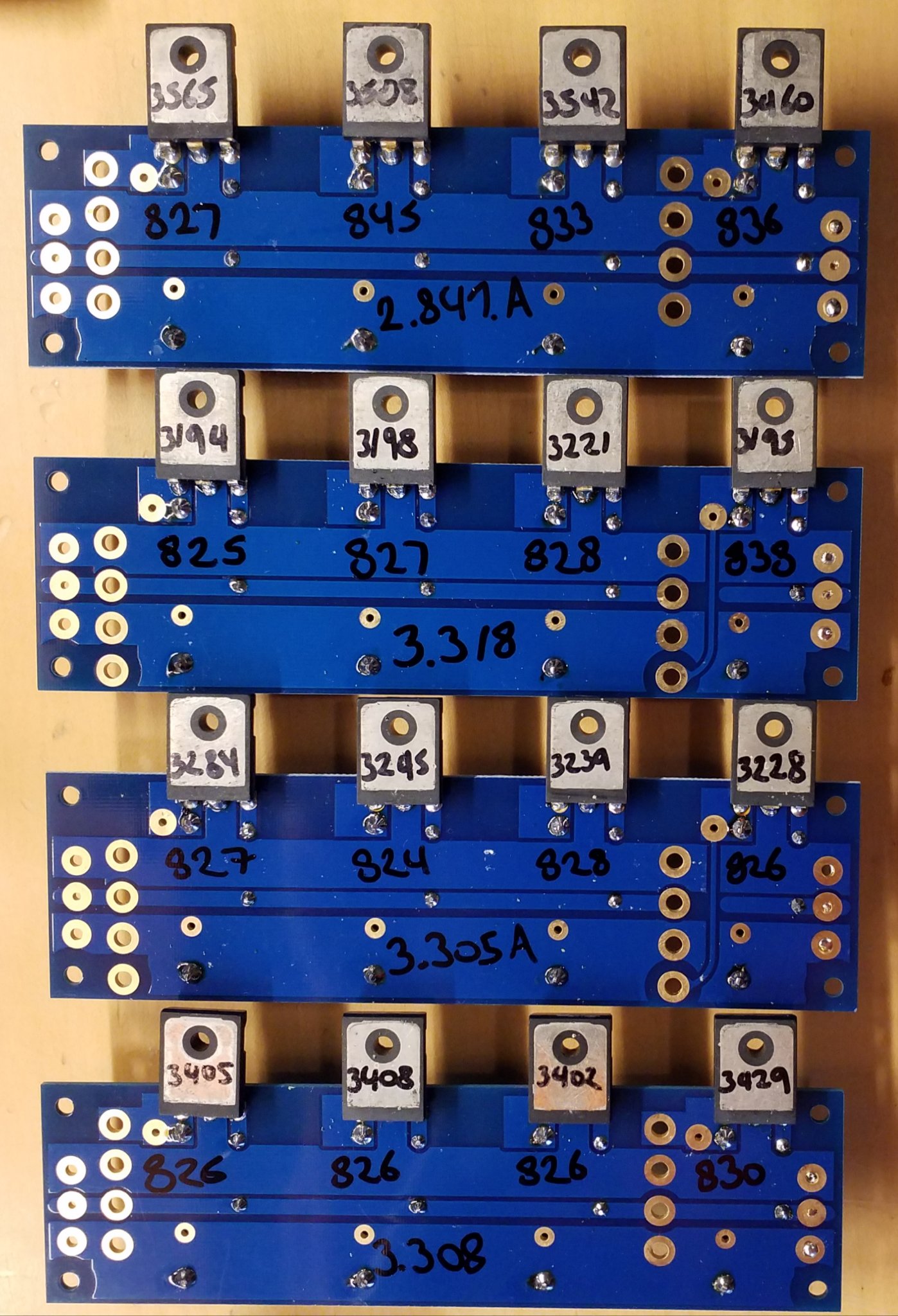

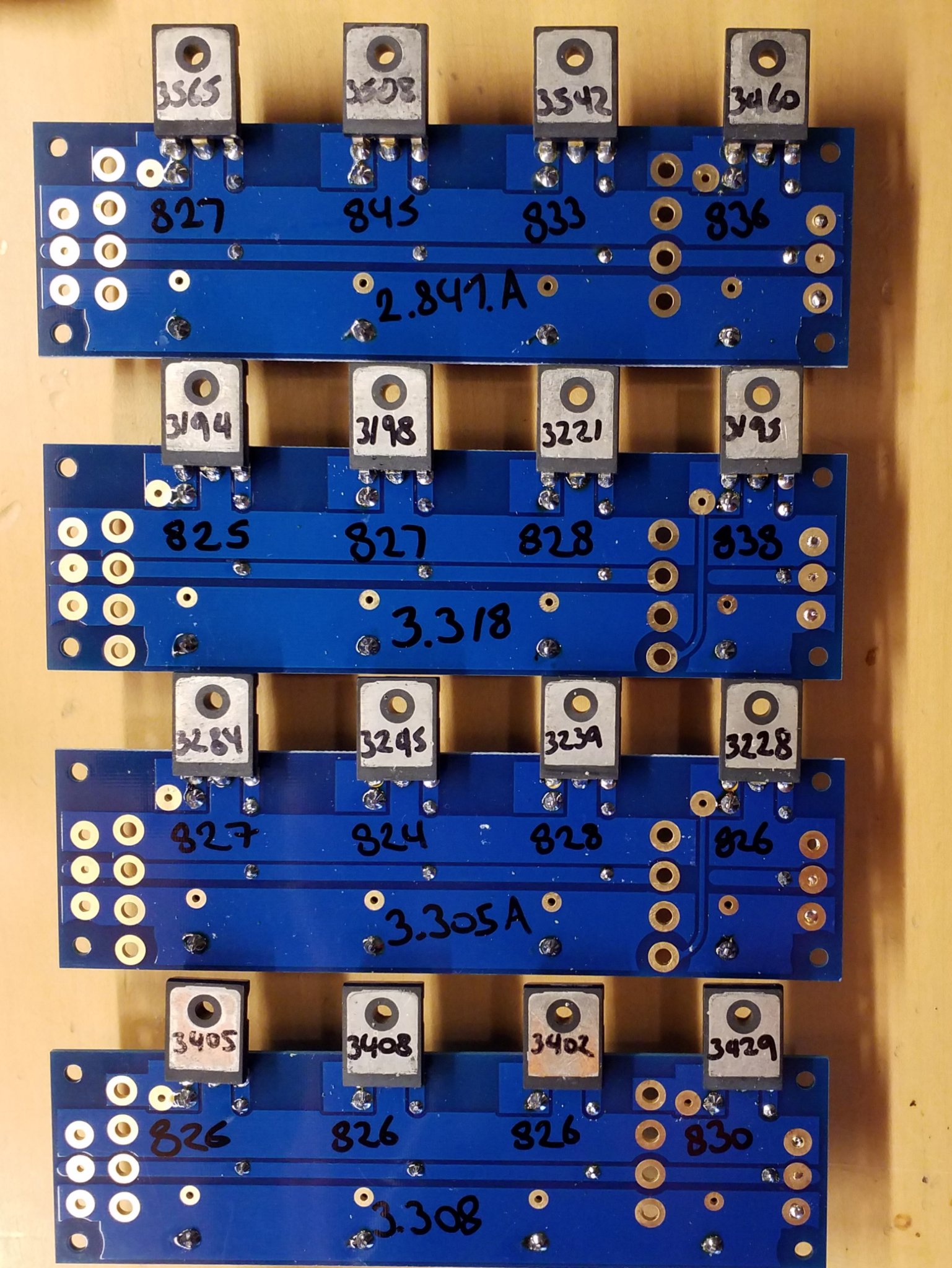

Sorry for hijacking this thread, but it was the youngest.
I have theese aleph 2 boards and tested them today with 15 volt, just like regular nmos test.
I wrote the currents in each emitter resistor under each device, a few boards look of, but are they to way off?
I know half is CCS other half gain , but could be swapped.
Number way down is the collective load current.
looking in quartets, all numbers are more than close enoughfew boards look of, but are they to way off?
if you're going to combine quartets to get octets, just choose closest quartets to pair
so, you're good to proceed
note - I'm looking at 8somthing numbers, assuming that's mV across 1R
worse case is 827 vs. 845, inside quartet ...... and that's under 2.5%
nothing to worry
Thanks zenmod for verifying what I thought. I will pair them up to match best , and that's it, I do have more irfp240 from same batch but the win of more matching is negligible.
Just for fun, I have many of the emitter resistors, they are 5% I could level out the worst boards, with well chosen resistors or ?
