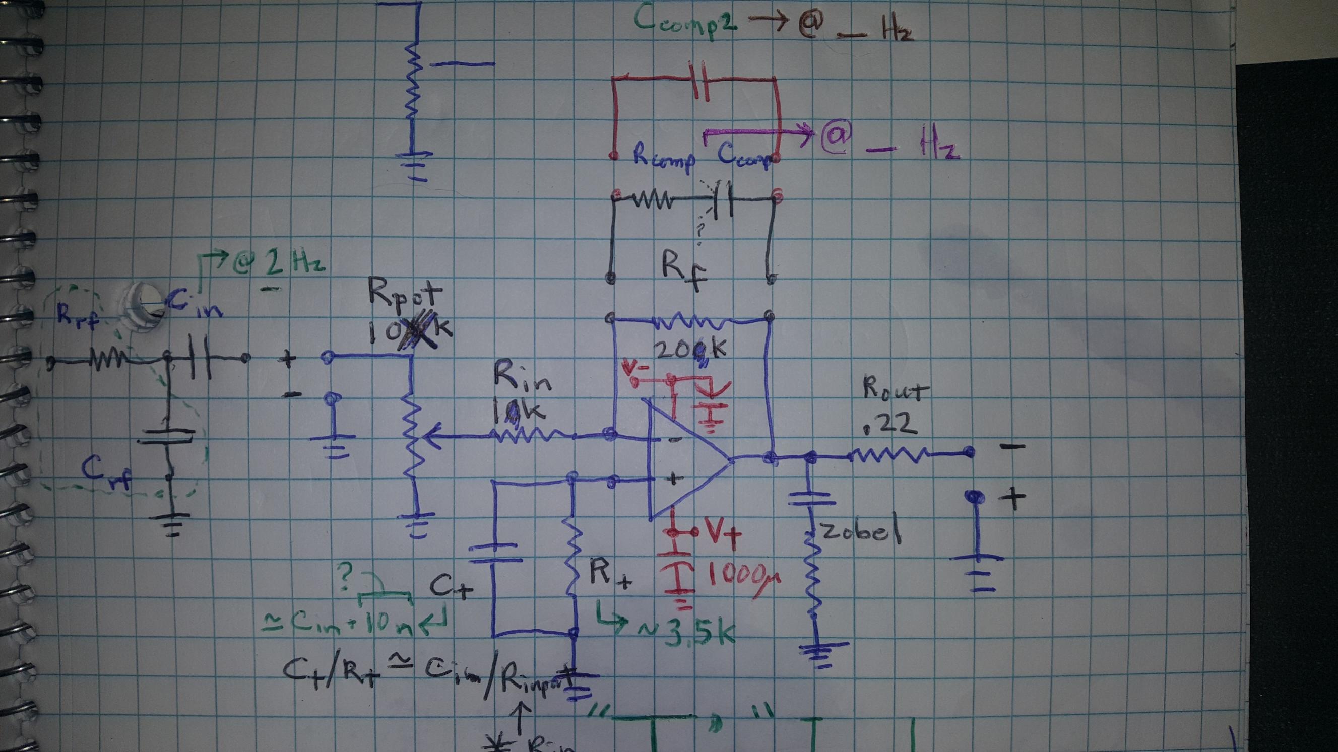

Hun, so this is a REcreation of " "T's" Inverted GainClone ". It obliviously wasn't his, but rather somebody took his idea of an inverted gainclone power amp and thru a pot on the front ...
Doh! [1st Task: why is this 'amp' unstable? ]
So I recall T noting (re his power amp) that using an opamp [no matter signal or power] in invert. config. has some advantages:
A) You can choose the values on the +input so they match the -input's (better balance; tweak by actual measurement)
B) Invert. operation provides that nifty virtual ground that, because of the fet input, physically ACTS almost IDEAL [acting purely mathematical, with no real-world 'fudge' factor] and thus has these tech. advantages ... blah, blah, blah, ... I can't recall what he said.
...oh, oh , and I thought:
C) Well, because [in this particular case] the pot sets the input impedance, Rin and Rf can be dropped by an order of magnitude to provide better noise and more current through the resistors [and junction] that provides further benefit by ... blah, blah, blah, I can't recall what I thought. ;}
D) So I'd like to correct and develop this circuit and build it and do some basic testing and listening and ... and, d o i t m y s e l f , ... if ya know what I mean ...

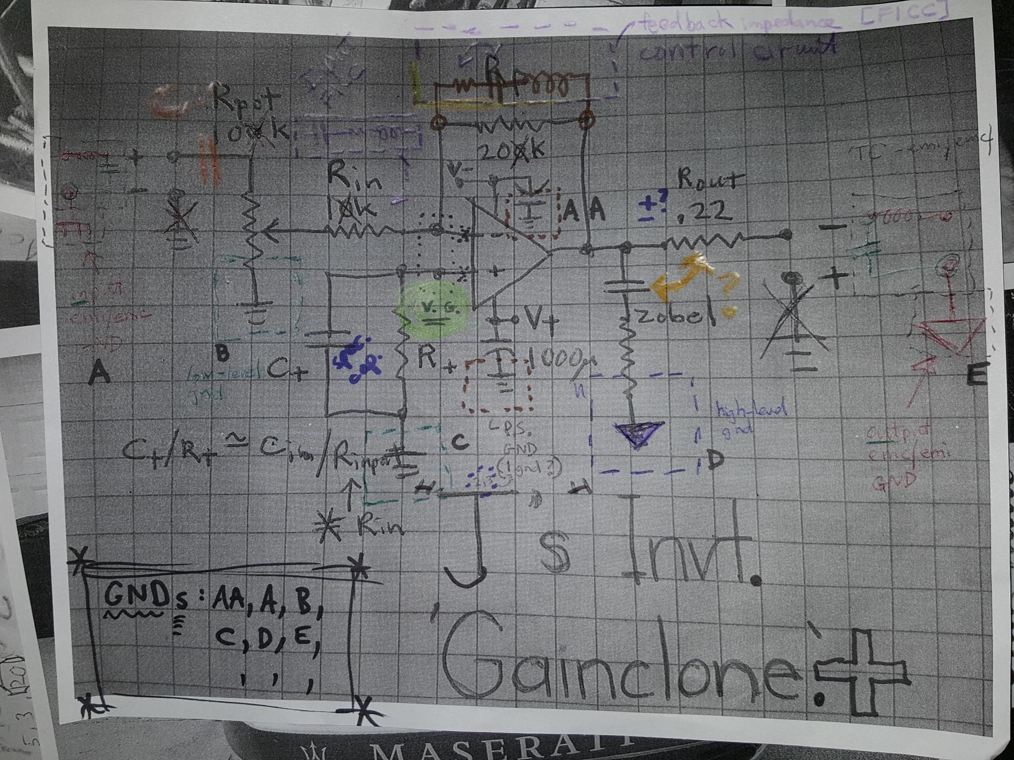

Alllllmost therrrrrreee !!11!1!
Go given that inductors are inherently hf blocking I just applied generic HF filt. to all inputs and outputs [except ps ...]
Also realized that thus there's way more that just the usual low level and PWR GND.
So it's a work in progress, ... er, ... will it explode?

In all cases, the volume at middle the gain is less than 10. Go to the first post and replace the volume by 10k or less.
