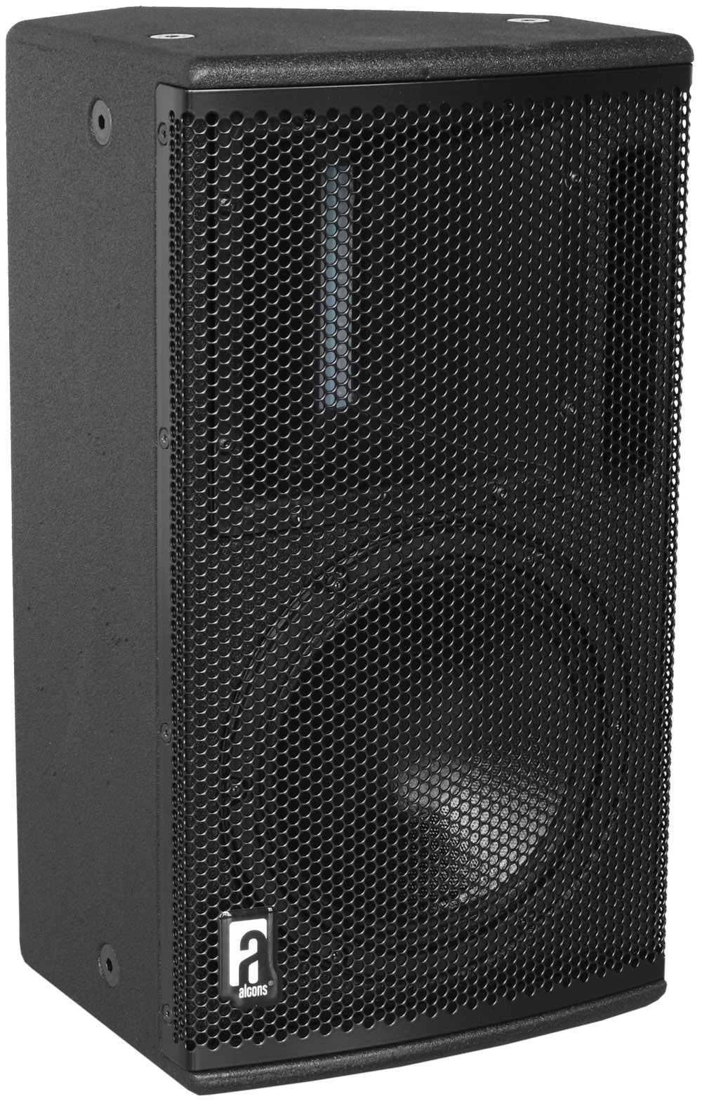

Alcons RBN-Series - ultimate sounded high frequency Loudspeakers; where to buy
I cannot find offers of follow ribbon models:
1) RBN401
2) RBN601 and the largest ribbon driver of the world:
3) RBN1801
Alcons Audio launches its largest ribbon driver RBN1801
alcons audio - evolutionary audio solutions ®
only complete loudspeakers are to find, e. g.
Kompakte Alcons SR9 2-Weg Box jetzt lieferbar
but also without price offers
Who knows delivery sources that can offer both complete loudspeakers and only the ribbon drivers?
As far as I know, Alcons drivers are not available to anyone, not even OEM customers, only as finished Alcons speakers. I know a few speaker manufacurers who have tried for years to buy Alcons drivers... with no luck so far.
