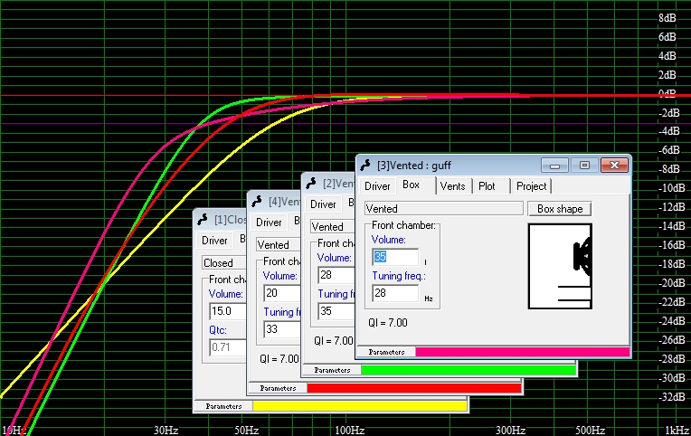

For sealed, I'd like Fs to be lower, 25Hz or less, so I can get decent bass without much equalization. This driver is better ported.
The driver can be used sealed or ported. It is suited to a 1cuft vented
box or a 0.5cuft sealed and stuffed box, both very compact for a
10" driver. Yellow and green are the standard alignments. I've
also shown a a compact and slighltly larger vented alignments.
28L detuned to 30Hz also looks pretty good to me.
Low tuned vented IMO gives you fast and deep bass, you can
see that the 35L tuned to 28Hz slaughters the 15L sealed
box for low bass extension and will for maximum output.
For sealed one would usually use 15L to 25L per driver.
30 to 35L sealed will give near critically damped bass,
so I can't say that won't work, it will, and very well.
rgds, sreten.

Hi Sreten,
That's what I wanted to hear! 🙂 I'm planning on building a 35L sealed enclosure - WinISD reckons 35x35x39cm 🙂
Reckon that'll give pleasing results then?!
Is this good?!
Will room modes mean that it'll sound 'decent' in real terms?
It will sound good, but bass will be lacking below 50Hz (in room). It almost needs a separate subwoofer. For low playing sealed, I like at least 12" drivers with low Fs.
I like Streten's green or magenta tunings best. Most bass in music is higher where group delay is lower, so it will sound fine and give you decent bass from that driver.
I find even with sealed alignments low bass can sound slow in rooms because of the standing waves in the room.
