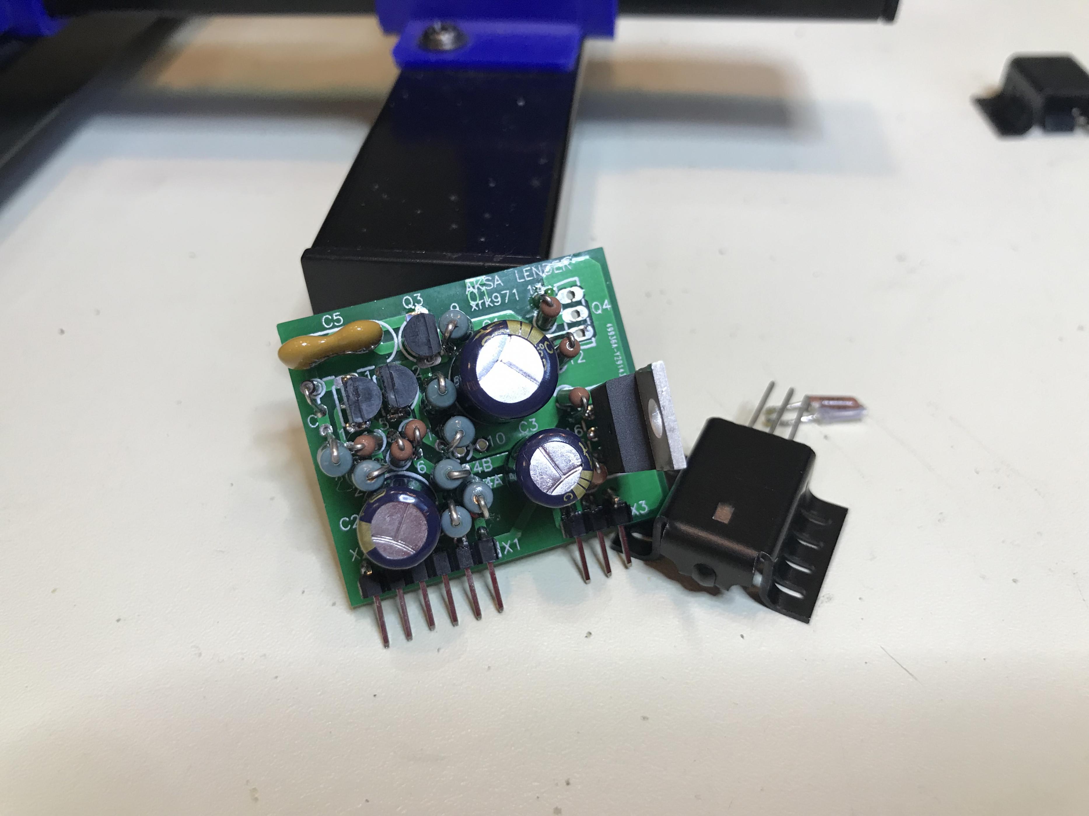

Thanks for the photo X. Wondering if C125, 135, 126, and 136 will need to be mounted under the main board to make everything fit like you did in your HPA build. I'm going to see if I can experiment a little with fitment tonight.
Yes, those capacitors will have to be mounted under the board especially if they’re the Silmics. I had a terribly difficult time trying to position the transistors in order to hold heat sinks in between all of the capacitors.🙁
Ah ha! I have Nichicon KZ's but same relative size as the Silmics. Ok, looks like under the board they go! Thanks Vunce!

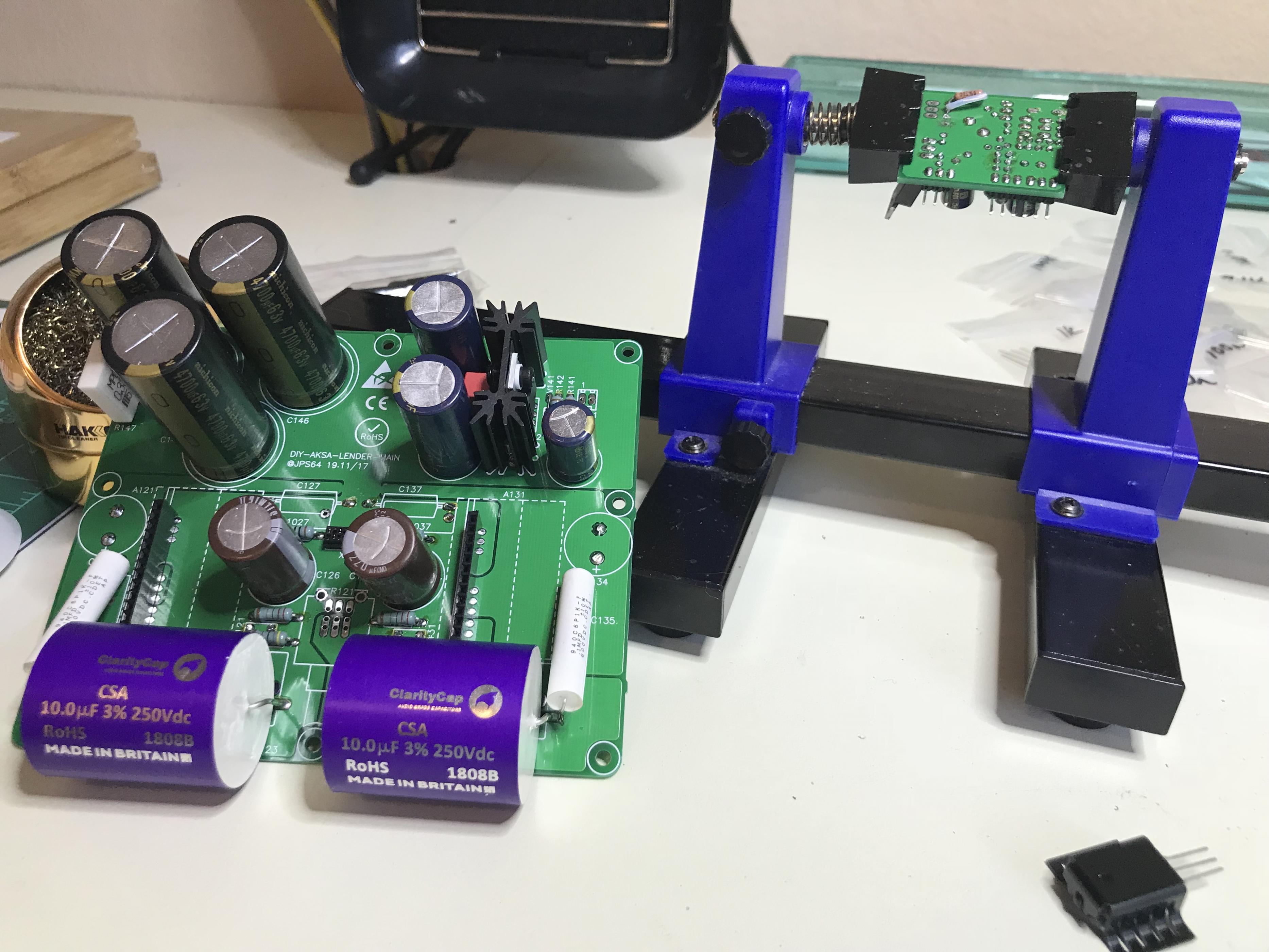

Any progress on your build? I'm curious to know if you are up and running and how the Toshibas are working with the mods to R14 and R15. I'm about to attempt the same configuration. Hoping to get some soldering time in this weekend.
I haven't had much time to work on it, but I have made a bit of progress.

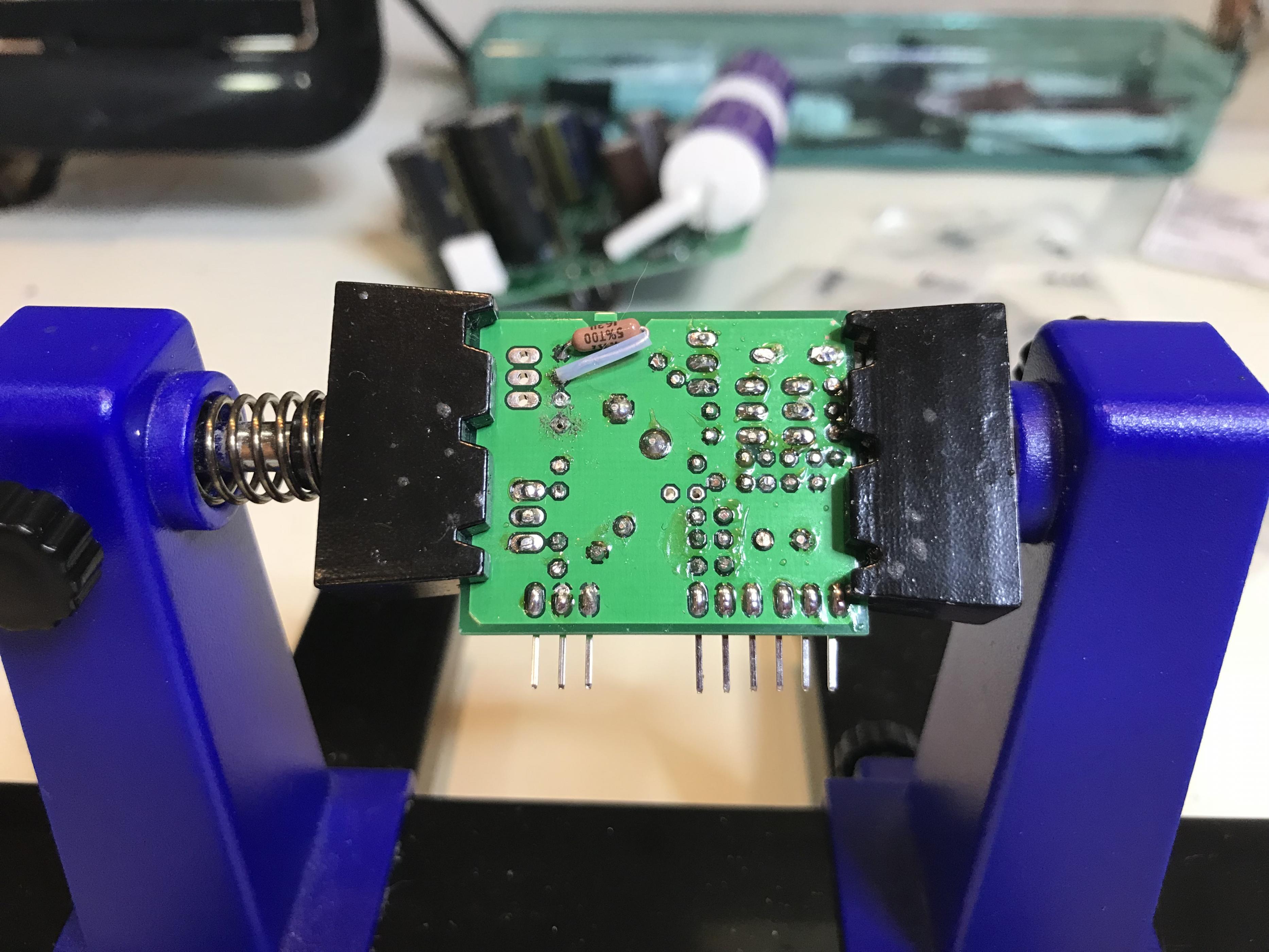

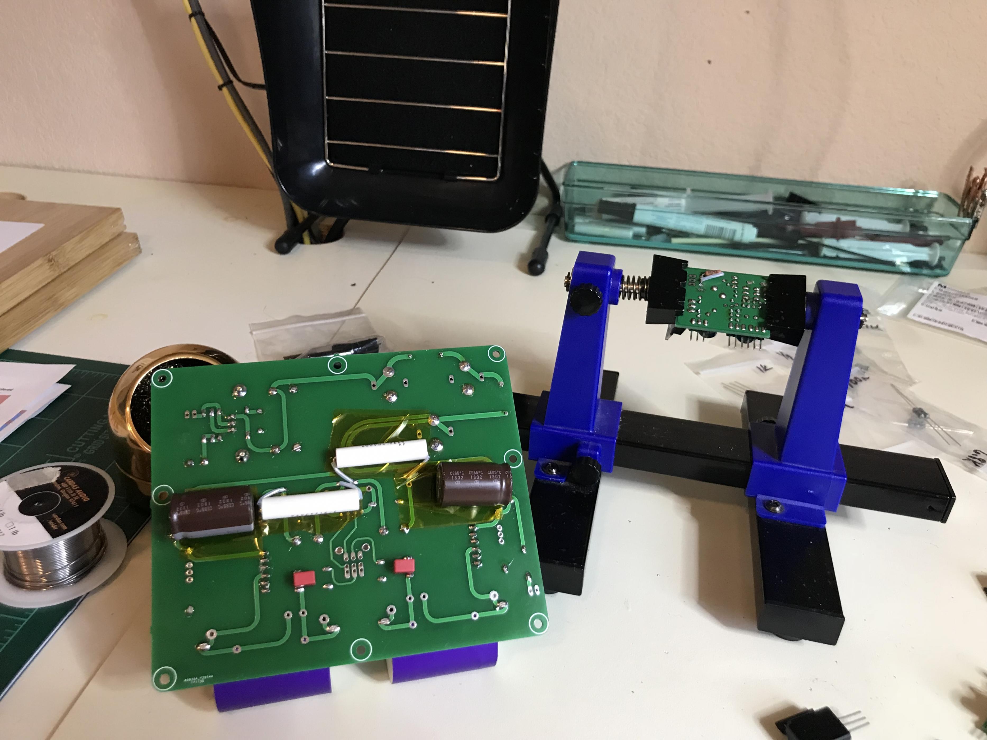

The last film caps came in and I got those mounted, I moved some of them and some of the electrolytics to the bottom of the board to leave room for the heatsinks on the daughterboards.
I'm moving the daughterboard resistors R12, R14, R15, and R16 to the rear of the board, laid over to allow room for the heatsinks I have on hand. I think I will have just enough room to make it all work.

Looking good Gable! Nice choice and fit on the CDE940C's. They're a great "budget" film cap. I was afraid they were too long so I went with Vishay 1839's instead.

Thanks! I was hoping I could make them fit, thankfully they did. They really are awesome film caps for the price.
