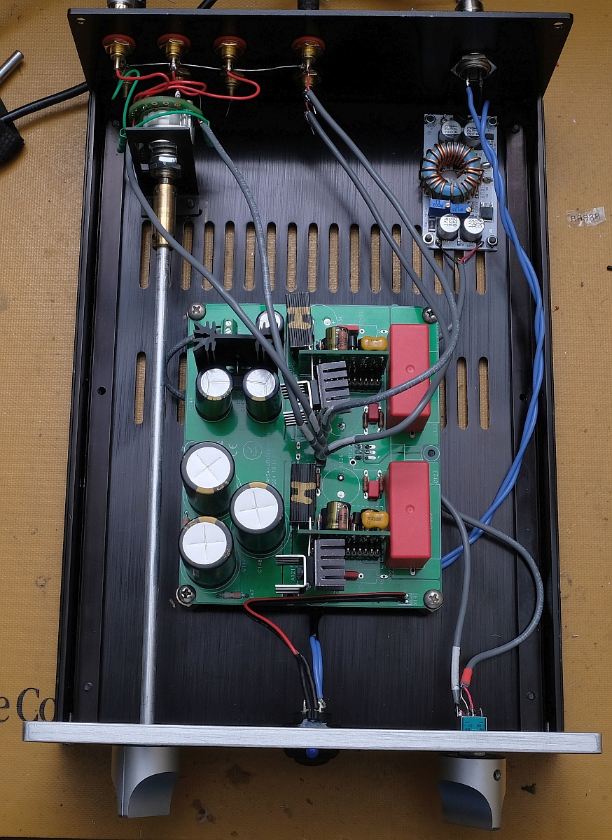

Well finished the case yesterday, assembled, with all of the wiring in place. Turned it on and yes, it works (also worked bench testing earlier). Started changing out DBs and now no amplification.
So started trouble shooting each side with a different DB (I built both high and low gain versions), nothing. The signal will pass through the circuit without the preamp being turned on. Same level in equals same level out. Also the pot has no effect on the signal whether the preamp is on or off.
Not sure what I did. I removed the active devices from both the MB (only two there) and the ones on a DB and checked them, all are working.
Checked the DC-DC converter, ok there. Output of the Cap MX, also working, ripple still holding at around .3mvdc.
At loss here.
After several hours I am thinking perhaps just order more boards and start over.
Thoughts, suggestions
David
So none of the DB’s work now? Is there any noise or hiss at all or silence? With DB’s installed and amp turned on, is there any bias current flowing? Check by measureinf voltage across R14 or R15 on the TH DB. On SMT board it is R116 and R117.
If there is current flowing but no sound - check on MB if your audio in vs audio outs have been switched. The inputs are on the inside of the 8pin connector and outputs on the outside. Half of them are GND on side closer to volume pot.
The signal should not pass through the circuit without amp being turned on. That sounds like you may have wires on 8 pin connector backwards. Signal is on ground which is all connected together.

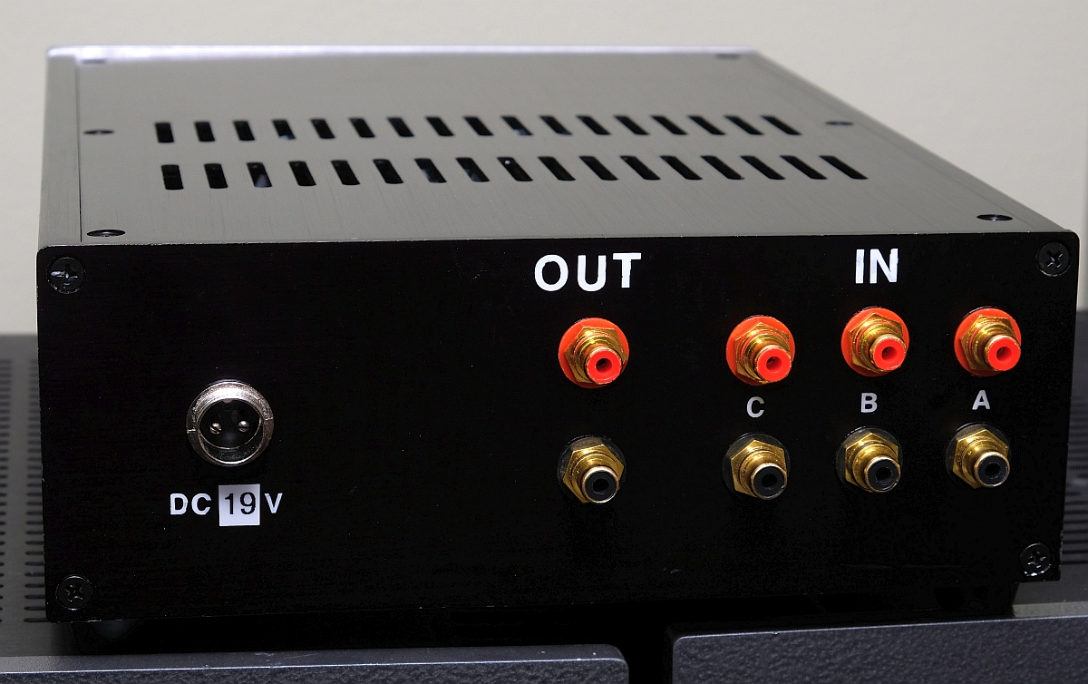

Well X, it turned out to be none of the above. Been spending a bit of time trouble shooting individual channels and discovered why the preamp worked when I completed it yesterday.
In the process of changing the RCA cable going the amp, I moved the Left channel RCA chassis connector and those little plastic collars that are supposed to keep the connector body from touching metal did, just enough to cause an intermittent short to ground.

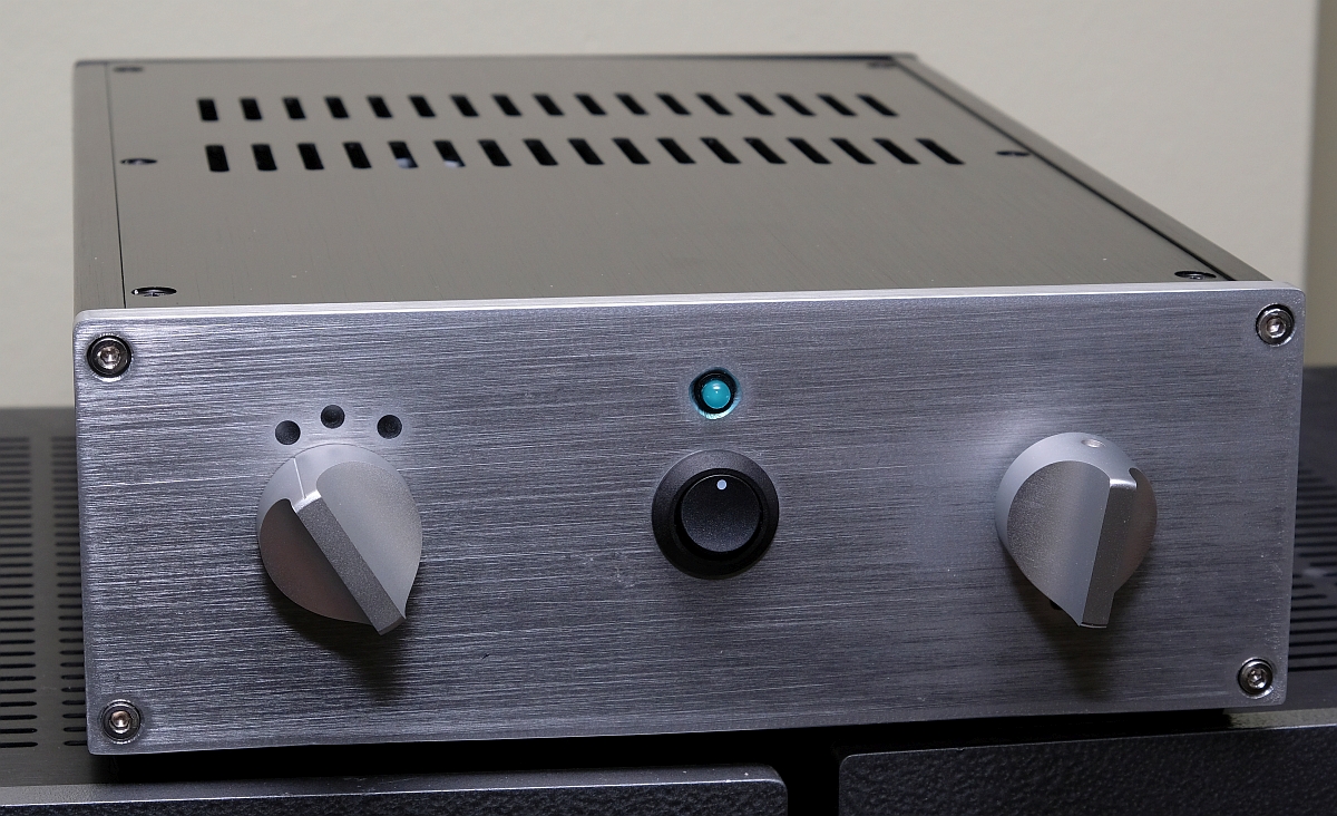

Thanks Gable. It is, came off of Allie Express. I bought it for my ImPasse build and those that know tubes better than I said it would be a bit tight with the transformer, PS, and preamp board so close together. Hum and such would occur. So I saved it for later. I had to cut the sides and front and rear panels down by about 2" and drill new holes. Never again, too much time and my fitment of the holes is awful.
You might check the cases on that site, very reasonable even with shipping costs added. My cut down exterior dimensions are 12"x8.5"x3 (LxWxD). The various other bits came from Apex Jr. and Parts Express.

That is a lot of work! I'm still planning my build for now, I'll poke around for similar cases.
