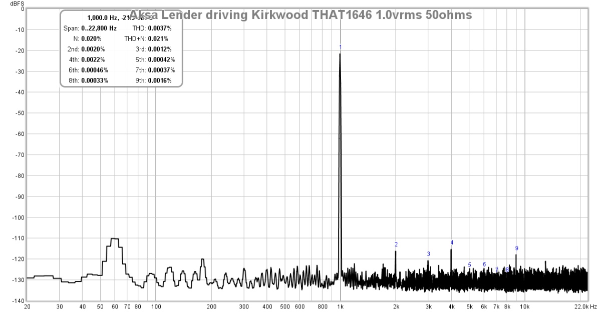

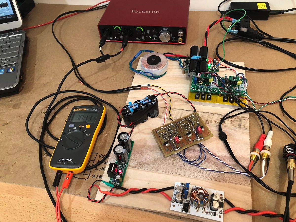

An experiment here using Aksa Lender as the brains to drive the exoskeleton body suit comprised of a Wayne Kirkwood THAT1646 Class A 0dB gain buffer headphone amp. Here is 1.0vrms (2.83vpp) into 50ohms load. I am measuring about 0.002%THD and some higher order stuff is rising up. The Kirkwood amp is a zero global feedback DC coupled complementary output amp operating in Class A. It sounds quite good - very direct and muscular. Another example of a use for the Aksa Lender are headphone buffer amps with low gain.
Setup, HPA uses basic toroidal trafo (10VA) and makes dual rail 15v with 7815/7915 regs - hence some 60Hz mains peaks:
attachment.php
FFT for 1.0vrms into 50ohms, about 0.002% THD but not the most beautiful harmonic profile:
attachment.php

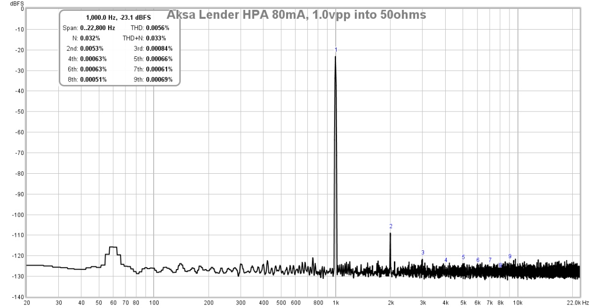

Same FFT but for Aksa Lender with 2SA1837 configured as headphone amp running at 80mA bias, slightly higher overall THD of 0.0056% but much cleaner and more appealing harmonic profile:
attachment.php

Sorry MKS, I normally use just the 4.7uF Wima MKS but since the board has a big opening for a huge cap, and I had these Chi-Fi polyethylene caps on hand I thought I would try them. They sound quite good - I am comparing side by side to a DC coupled Schiit M3 and of course, the Aksa Lender sounds better even though it is cap-coupled through and through (in and out). Probably noting to do with my super ChiFi input 1uF 400V MKP caps. 🙂 The nice thing with cap coupled amps is that you never have to worry about blowing out your cans if the amp burps DC. The cap multiplier has a soft start ramp up that absolutely is silent with regards to turn on/off pop. None, zilch, no relays or time delay circuits needed.

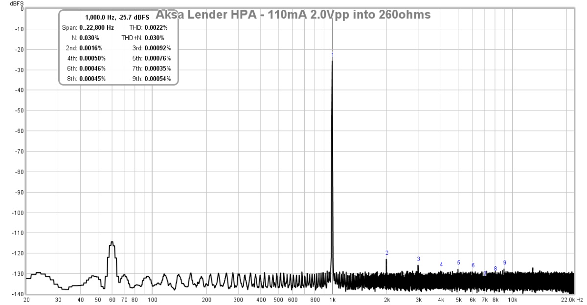

I just re-adjusted to gain to 16.6dB which is needed for lower sensitivity DT880-250's and it sounds superb now. I dropped bias current down to 110mA. I think that a SE Class A design, always sounds so smooth compared to class AB amps.
With a 260ohm load, the amp is now measuring about 0.0022% THD for 2.0Vpp:
attachment.php

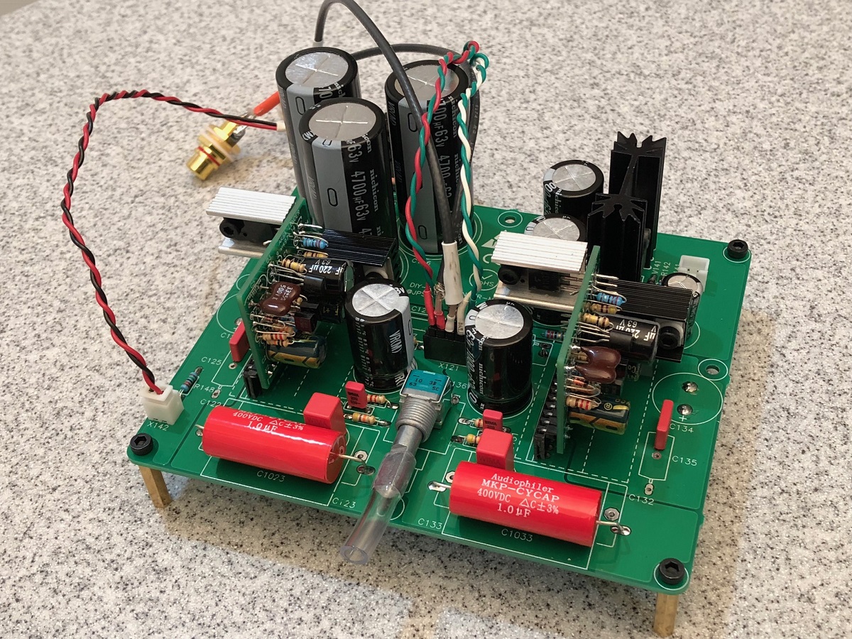

This is the heart of the amp - the Aksa Lender SE Class A with LTP-Lender input stage on a small daughterboard. Here, in HPA mode, I am using my favorite genuine Toshiba 2SA1837 for the output. Perhaps the best BJT ever made for audio?
657047d1516059914-aksas-lender-preamp-40vpp-ouput-gb-aksa-lender-hpa-amp-cores-2-jpg

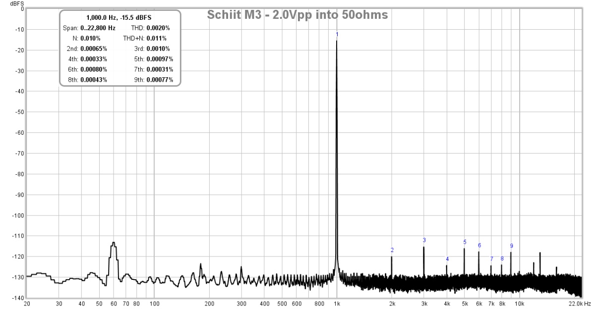

The M3 has very low overall THD, about 0.002% for same 2.0Vpp into 50ohms, but has higher 3rd order than 2nd order, and higher orders 5th, 7th, 9th crop up, albeit very low levels. But I think we can hear these things. The M3 is a fine sounding amp, and a superb value, and if it was all you had, you wouldn't know any better. But, listening to the Aksa Lender HPA side by side, I can really hear a difference. I think I have amassed enough HPA's to have a second round of a virtual HPA blind auditions thread. I have a hybrid tube/SS amp from Massdrop coming next month. That should round-out the comparison...
Here is the M3, measured with same rig at same settings:
attachment.php

Look at the photo above - that’s a TH board with suitably sized heatsinks for TO220.

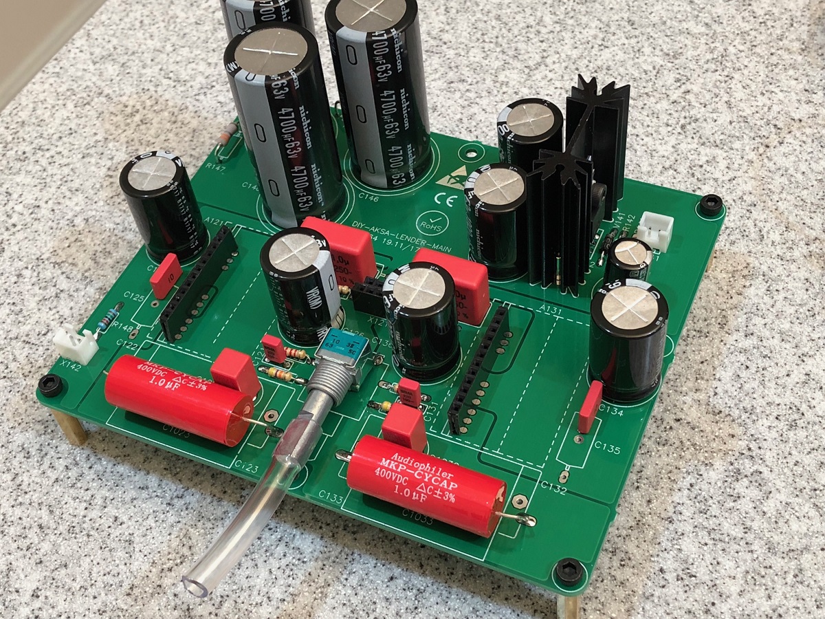

And look at the main board that the daughterboards plug into, all TH. The core amp is small for a good reason, it lets you have a low cost swappable module for flexibility and a tight layout keeps things electrically quieter.
657048d1516059914-aksas-lender-preamp-40vpp-ouput-gb-aksa-lender-hpa-amp-main-jpg
There’s not a single SMT part on this version of the amp. There is an SMT option for the daughterboard, but that’s an option. Most people get the TH version.
