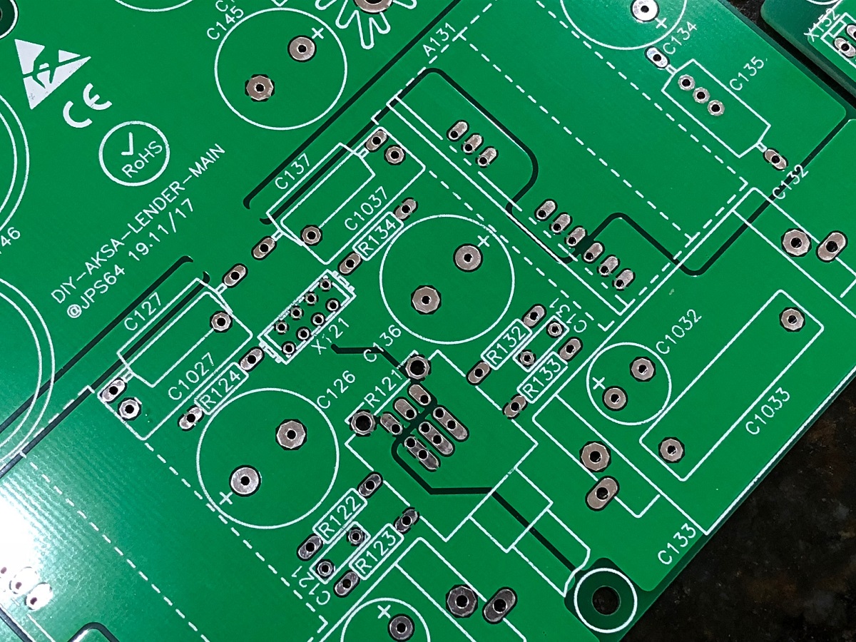

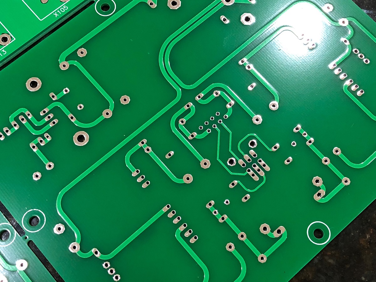

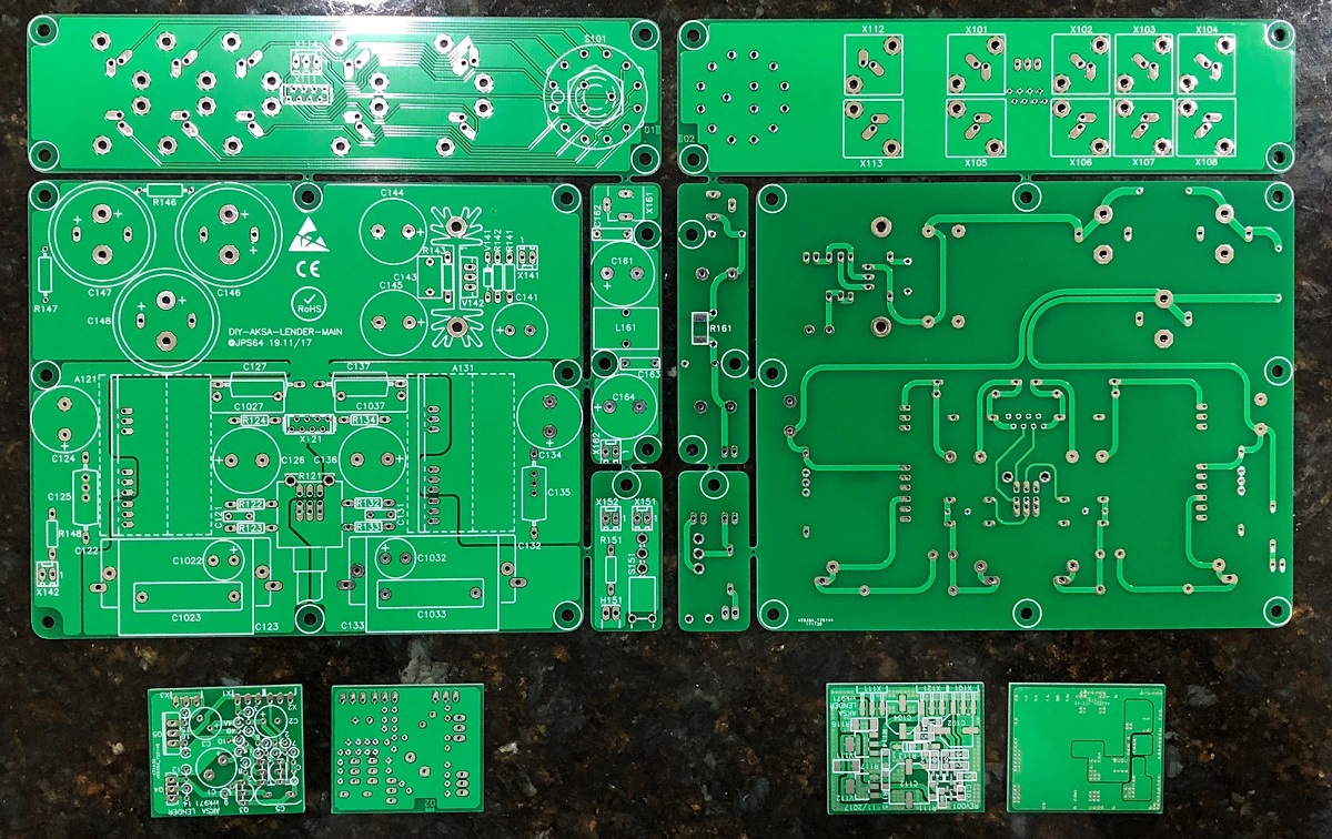

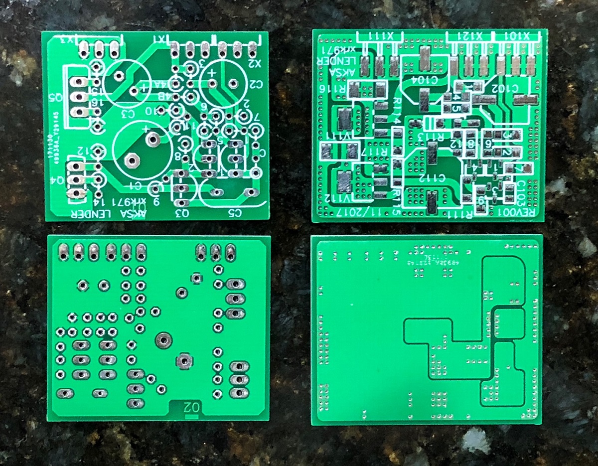

GB #1 PCB's Arrived!
The boards arrived and they look great. I have never had such a big heavy shipment before - amazing how much FRP, copper, and lead weighs.
Again, thank you to Aksa for the design and JPS64 for the layout! This is truly a superb "professional" layout - very similar to what you would see in a final end-product. You will notice extensive use of copper pours/ground planes, separation of signal and power ground planes, nice connectors to allow the boards to be placed in the users' case with the most flexibility as to where input/output jacks go, etc.
I think I will have to separate the mother and smaller break-way sub-boards in order for it to fit in a reasonable size package for shipment. As is, the MB is a little over 6.2in x 6.2in square shape which is an odd size to fit in a standard padded envelope.
Here are some photos...
attachment.php
attachment.php
attachment.php
attachment.php
For the purposes of testing out the boards, I will install the essential parts and leave off the connectors etc as I don't have them yet. But I should be able to verify that the preamp circuitry, cap Mx, etc all works. I am waiting for my order of the essential parts like DN2540, BSP129, electrolytic caps to arrive.
For those of you having a hard time sourcing the MELF resistors, JPS64 said that he will provide a set to make two SMT daughterboards for 3 Euro. He did check with Mouser (USA) to verify that they were in stock before he finalized the layout. There must have been a big project somewhere in the US that wiped out all the stock. Send JPS64 a PM if you would like a set. Or perhaps we can start a MELF resistor GB list here even.
Metal Electrode Leadless Face (MELF) resistors, because they are round and can roll or eject off the end of a tweezer, they are also known as Most End up Lying on the Floor...
KOA SPEER makes them too. I suppose in the future 0805 pads would be useful as it allows either low cost easy to find chip or MMU (0102) MELF to be used.
RN41, RM41 | KOA Speer Electronics
From Wikipedia, advantages of MELF:
Despite their handling difficulties, and in the particular case of MELF resistors, they are still widely used in high-reliability and precision applications where their predictable characteristics (e.g., low failure rate with well-defined failure modes) as well as their higher performance in terms of accuracy, long-term stability, moisture resistance, high-temperature operation far outweigh their disadvantages.
