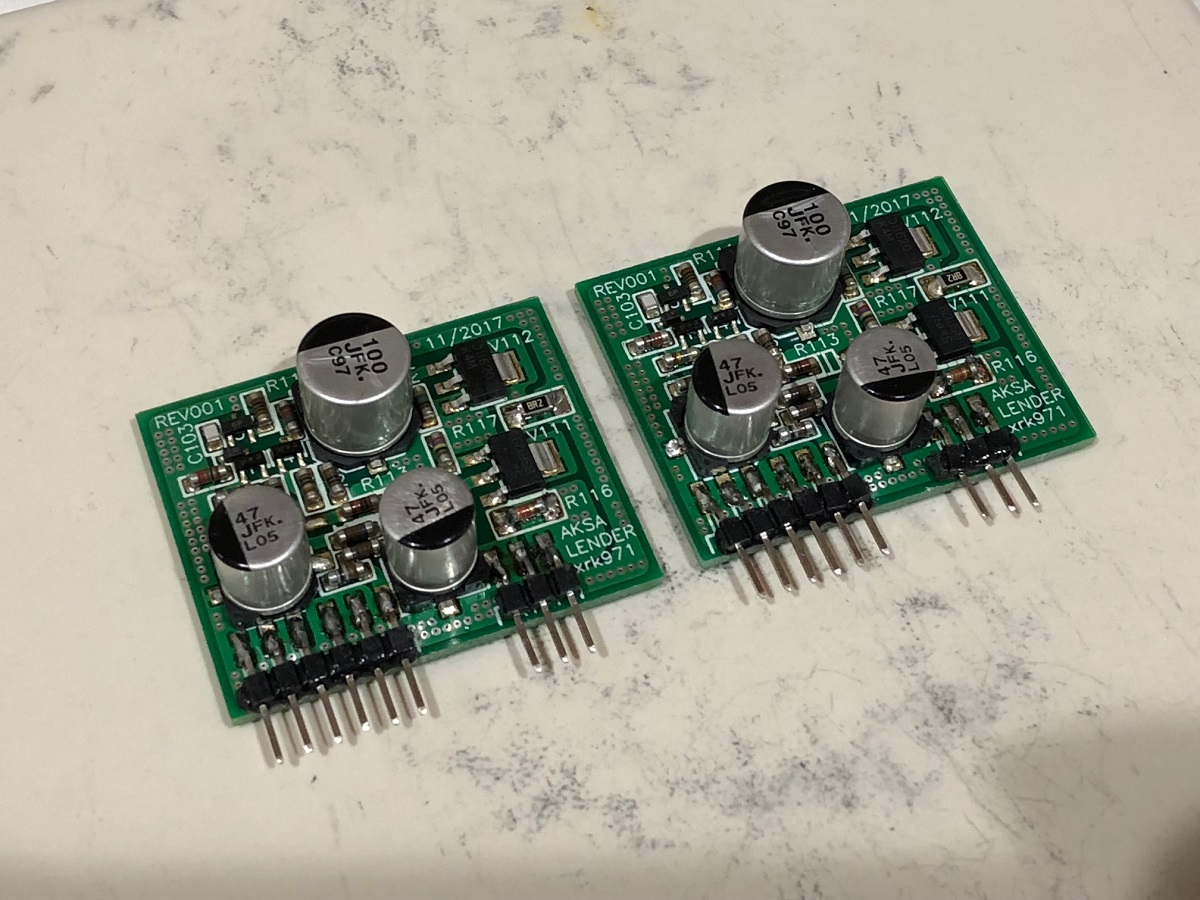

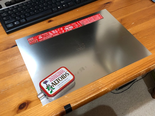

I should make a build guide thread - it might help clear up some of the unknowns and hurdles that many people might have. I am waiting for my order from Mouser to arrive with some of the special parts like the 8-pin board to board header cable. I am about to embark on a MELF build to satisfy my curiosity that this will all work. I happen to order the solder paste stencil. It's pretty comical how big of a sheet of stainless shim stock they put it on without trimming it down... 15in (380mm) x 11in (280mm) for a tiny 30mm x 40mm board. I am not sure if I should just take tin snips to it because it leaves ragged edges. Those little holes in the middle are the stencil patterns 🙂

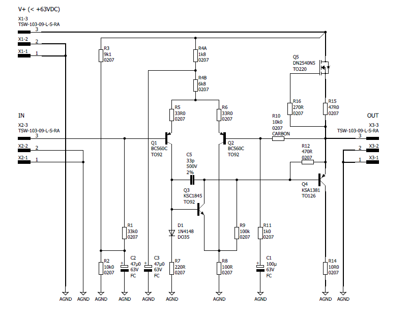

I built up the original SMT daughterboards with the MELF resistors. They are much trickier to install than rectangular chip resistors. My biggest problem was forgetting to use the corrected schematic. The correct assignment is R2=33k and R3=10k. The other thing I learned was that the standard (non SMT) header pins cannot be reflow soldered as the plastic part melts. They must be done manually with an iron. Getting through all that, the amp works fine and is singing now with the MELFs. I am running 10k/1k for feedback so now at 20dB gain vs 22dB previously.
The solder paste and hot plate method worked very well and neatly for the MELFs.

Sorry I wasn’t clear, the TH schematic and silkscreen is fine. That’s what you have above.
The MELF SMT silkscreen needs to go with this schematic:
Note that schematics are not the same between different daughterboards. The images I have should be labeled with the board type. You will notice TO92 designations on the LTP.
Ha, thats a pretty awesome, I wonder how much extra they had to pay for shipping on that. I assuming it couldn't be shipped rolled. In the past I've had good luck with OSH Stencils. I've ordered their laser cut polyimide, so not as durable as your typical metal stencil, but good for a pasting a handful of boards.
For this build, I'll probably use a fancy new solder paste dispenser I bought in on via Kickstarter (I-EXTRUDER smart Solder Paste and Fluids dispenser for PCBs by Artline International —Kickstarter). I haven't had a chance to use it yet.
The new SMT 0805/1206 daughterboard has been verified to work.
Those look great! For the SMD chip resistor version will there be an updated BOM specifying the footprint for each resistor?
