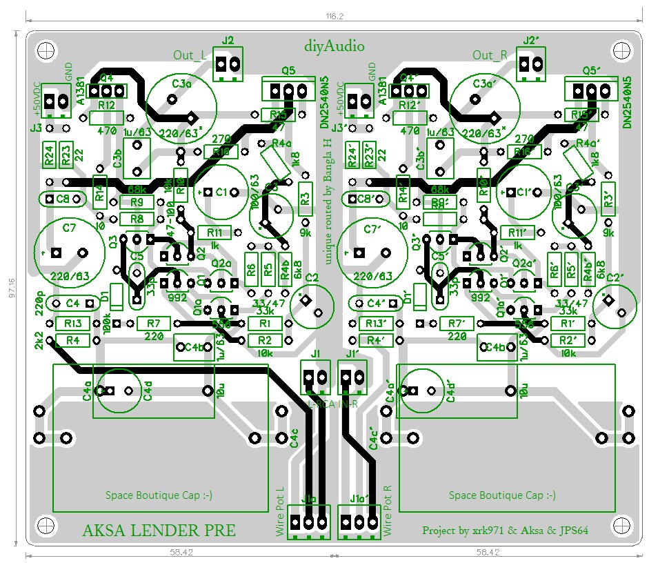

I have worked on layout my own Aksa Lender Pre for MoFo use, but not started.

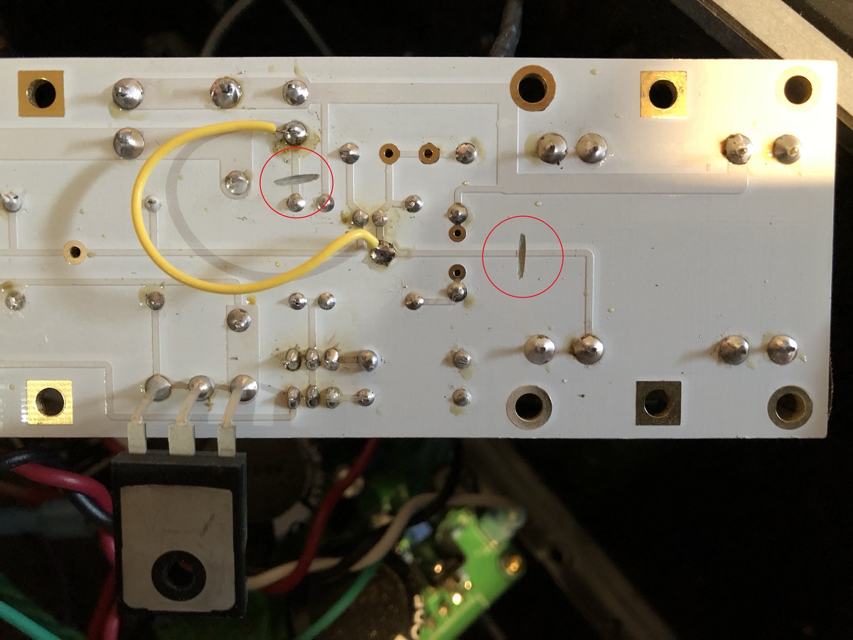

I had a free hour to try something, and certainly for those of you with an existing M2 and an Aksa Lender preamp in-hand already, you can try too. Takes no time at all. Cut the trace from Edcor to 10uF coupling cap C2. Cut the trace from input jack to JFET front end. Solder jumper from input pin to C2 positive terminal where trace was cut. Connect your Aksa Lender pre to the amp's RCA inputs. Turn on and enjoy.
This is the best I have heard the M2 sound - the noise and any hum is gone gone gone. Silence ears pressed to speaker cones. The music is engaging, dynamic, and with a zero global feedback power stage - very natural and with superb imaging and soundstage. This is going to be a fantastic amp.
Cut traces with Dremel tool (took 1 min), wire jumper (took 2min), re-assemble on UMS heatsink (took 10min).

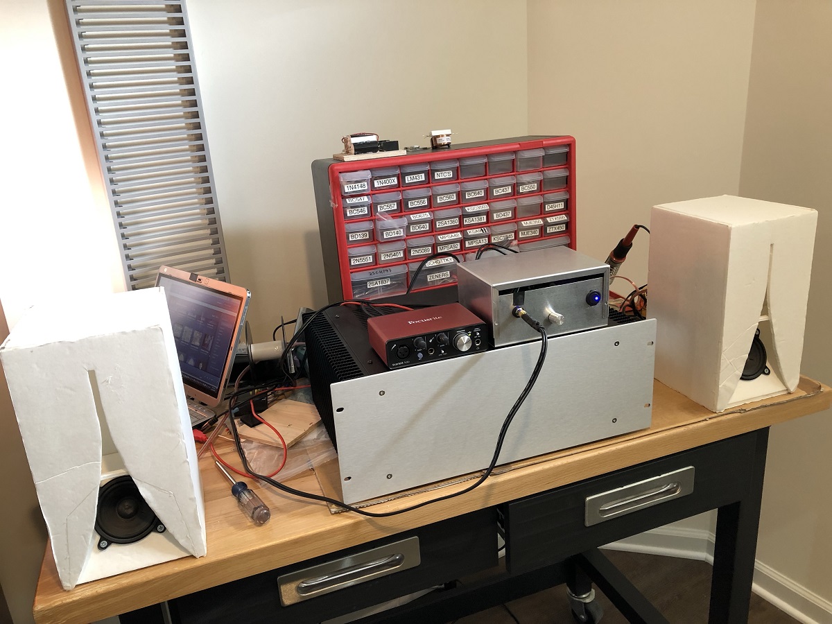

Testing with 0.40x Karlsonators with 3FE25:
attachment.php
So the concept is now proven and I did not have to build a proto board!
Hi Bangla H, your layout looks very nice. You gave me a set of Quasi boards (Prasi layout) a while back and that’s how I got started working with Hugh. Let me know if you would like a set of Aksa Lender Preamp main board and daughter boards. I’ll send them out today if possible.

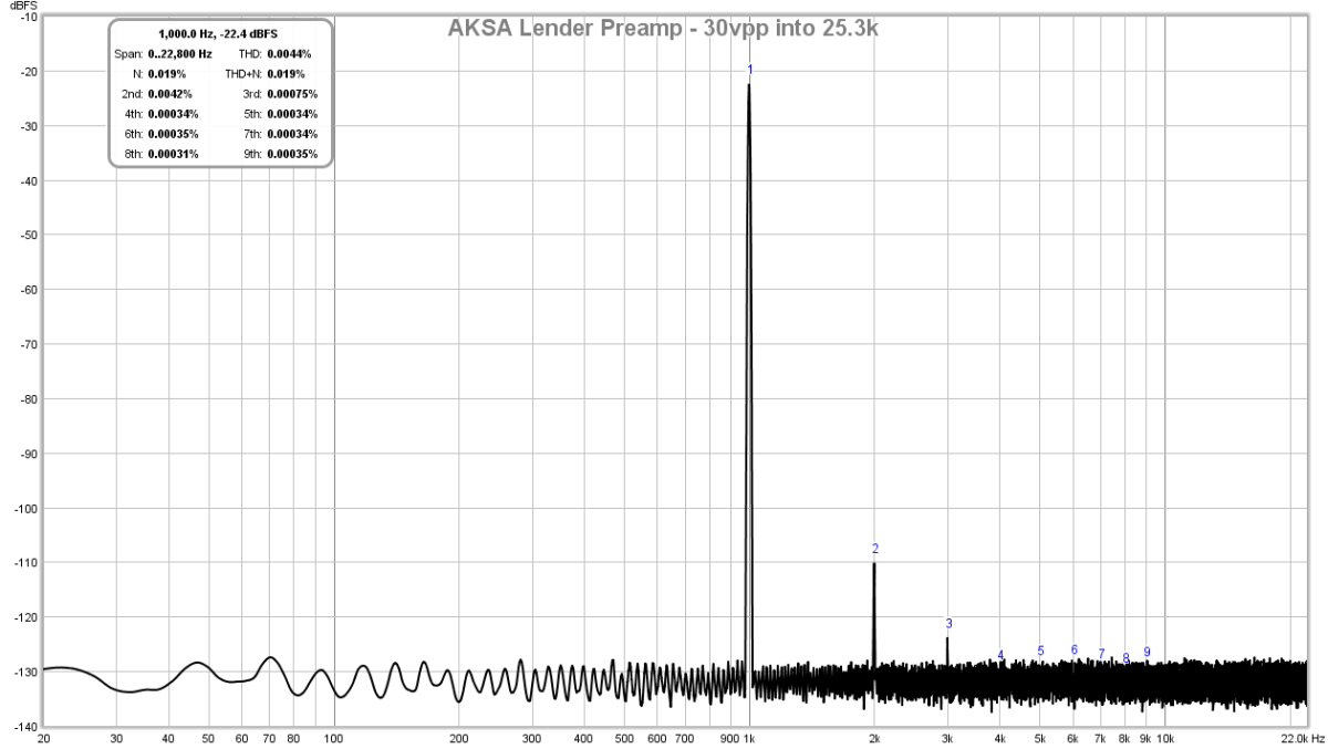

Assuming we want to drive the M2 output stage to 30Vpp (about 11wrms) then here is the front ends performance. We will have to see if the M2 can keep up but seems that we were getting similar but higher values of THD on simulation:

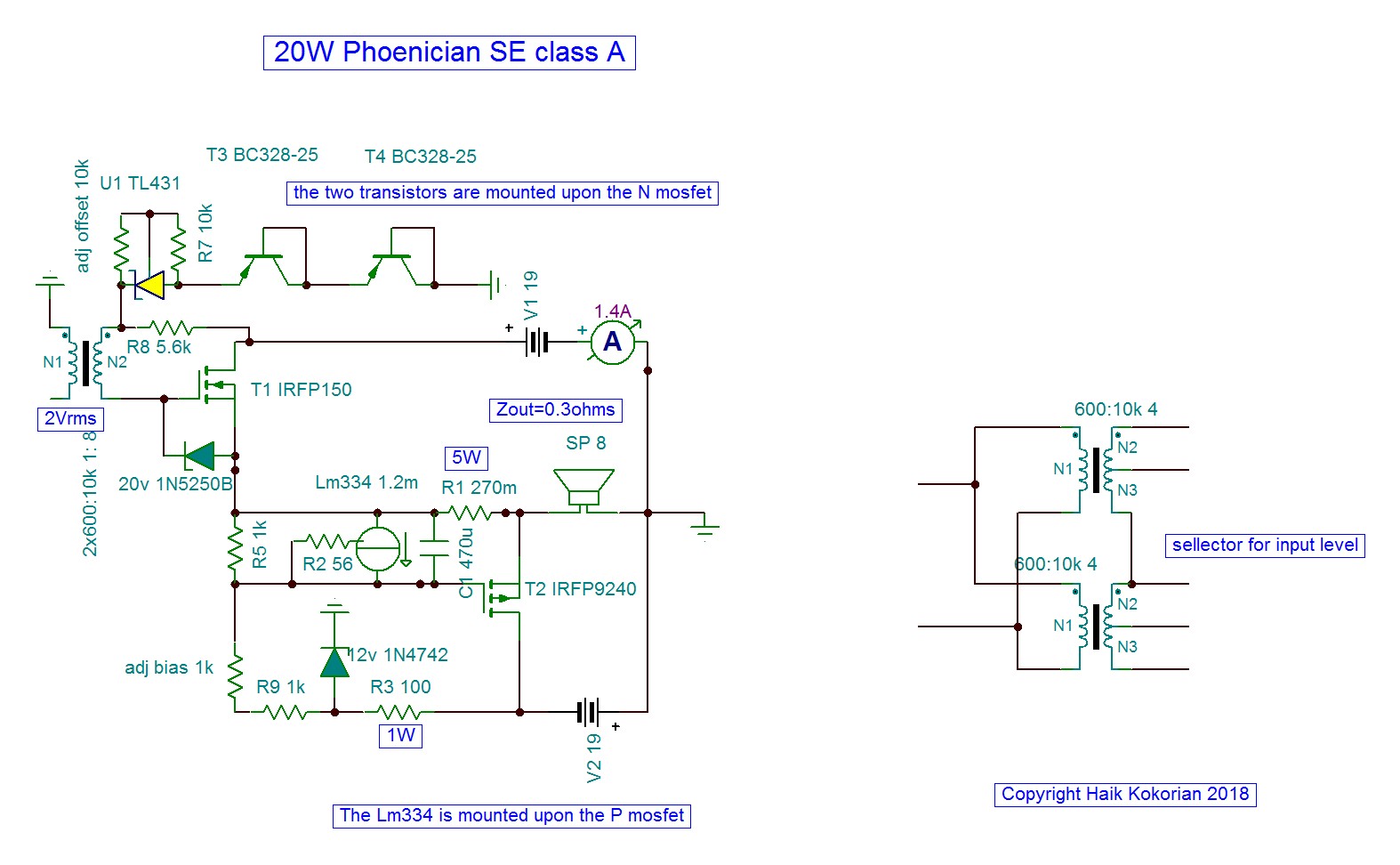

Thanks, Mark Johnson for the suggestions. We have been debating whether or not to run the front end single rail or dual rail. The preamp is single rail, and the ALPHA 20 and ALPHA BB have the dual rail variant to be consistent with given PSU dual rails. We could do that here I suppose, but I wanted to be able to re-use the old tech already developed and that was the single rail preamp daughterboard. Let me think about it. You were not the first to suggest this. However, filtering of the main rails from the front end really needs to be done well to keep it clean as the SE Class A nature of the front end picks up any variations in the power supply as noise.
If we went dual rail, we would basically start from the ALPHA 20 layout and replace the PMOS Aleph output stage with the M2 output stage. Here is the schematic for the same Aksa Lender front end but implemented in dual rail and with global feedback:

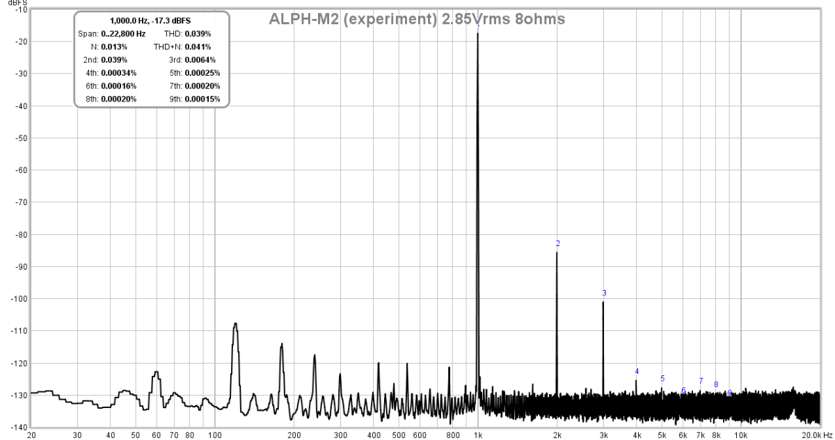

Btw, here is how the Teabag M2 output stage measures with the Aksa Lender preamp front end for 2.85Vrms into 8ohms. Nice profile but the M2 output is higher in overall THD - but at 0.04% and dominant H2 and H3 -16dB less, and nothing else - this should sound really nice - and it does. Since it is a no global feedback design, it is expected that the distortion will be a bit higher but that's quite alright as the profile looks wonderful.

Since you are discarding 2/3rds of the M2 anyway, why not throw away its "No Feedback" arrangement too? You can quite readily include the output stage inside the feedback loop of the overall amplifier. Or arrange a couple of jumpers / DIPswitches which allow you to listen to the amplifier BOTH ways: (1) output stage not included in NFB loop; (2) output stage yes included in NFB loop. Maybe your preference will be a complete surprise.
By the way, this is a small tweak upon the WHAMMY headphone amplifier, with lower value source resistors (thus higher standing bias current) and WHAMMY's 4N35 optoisolator biasing loop. Replace the IC opamp with discretes, done.
