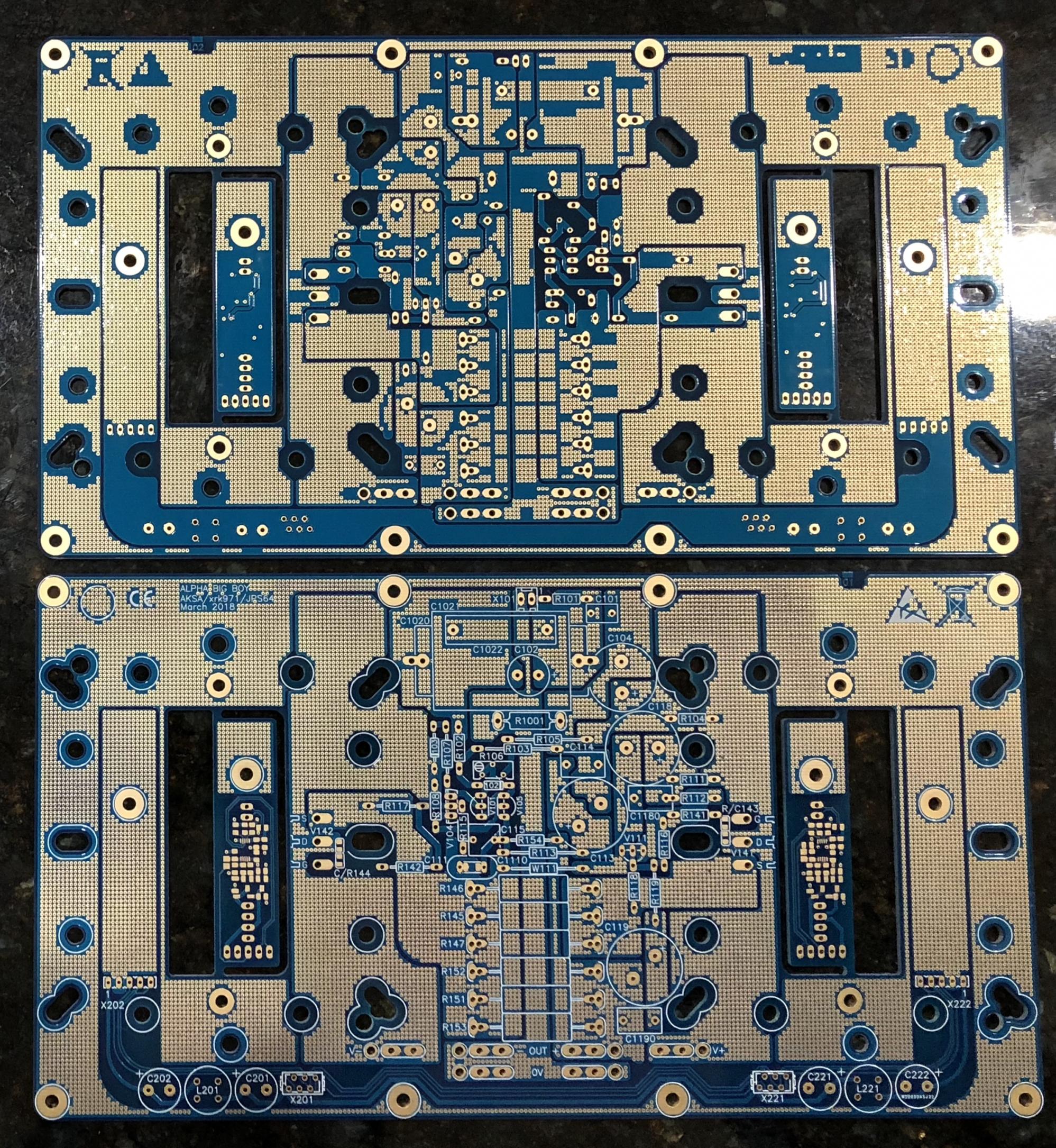

Hi Danny,
Good questions in the other thread. The Alpha 20 has the feedback from the node upstream of the Aleph current sense resistor. Whereas the Alpha B.B. takes it from below the Aleph sense resistor to decrease output impedance. I am asking Hugh to confirm if the modifications to provide 4ohm drive are still directly transferable to the 20w PCB.
Here is the schematic associate with the production board now in GB2.
And very good responses from Hugh !
Now I know how the ccs works and how to simulate it in ltspice,
there's more in ltspice then FFT
I think the PCB will be alright for the 4R version, the schematic is the same except some resistors and caps that have another value.
As for the damping, I'll do some simulations to see the effect of where to take the fb.
If I decide for the BB style fb I can connect one leg of the fb resistor to the pcb and the other to the output.
