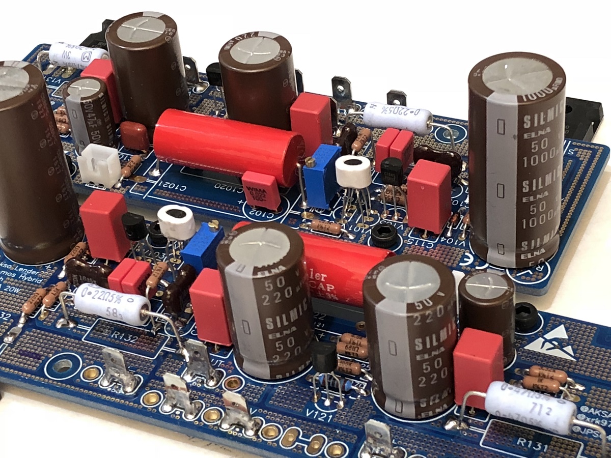

Schematic for 20W ALPHA:
Parts placement:
3D render:
Example build with Vishay-Dale/Wima/Silmics:
Another example with non-premium resistors:
Alpha 20 with 1.31amp bias and 2.86vrms into 8ohms gives 0.0069% THD, 0.0059% if using all Vishay-Dale:
BOM and Schematics here (note that there is error on R108, should be 47R not 470R, and for R131 and R132, use Pan ERX 3W 0.47R and 0.22R, respectively for 1.35 amp bias:
http://www.diyaudio.com/forums/soli...rid-aleph-alpha-amplifier-51.html#post5348523
Corrections to previous BOM in BOLD

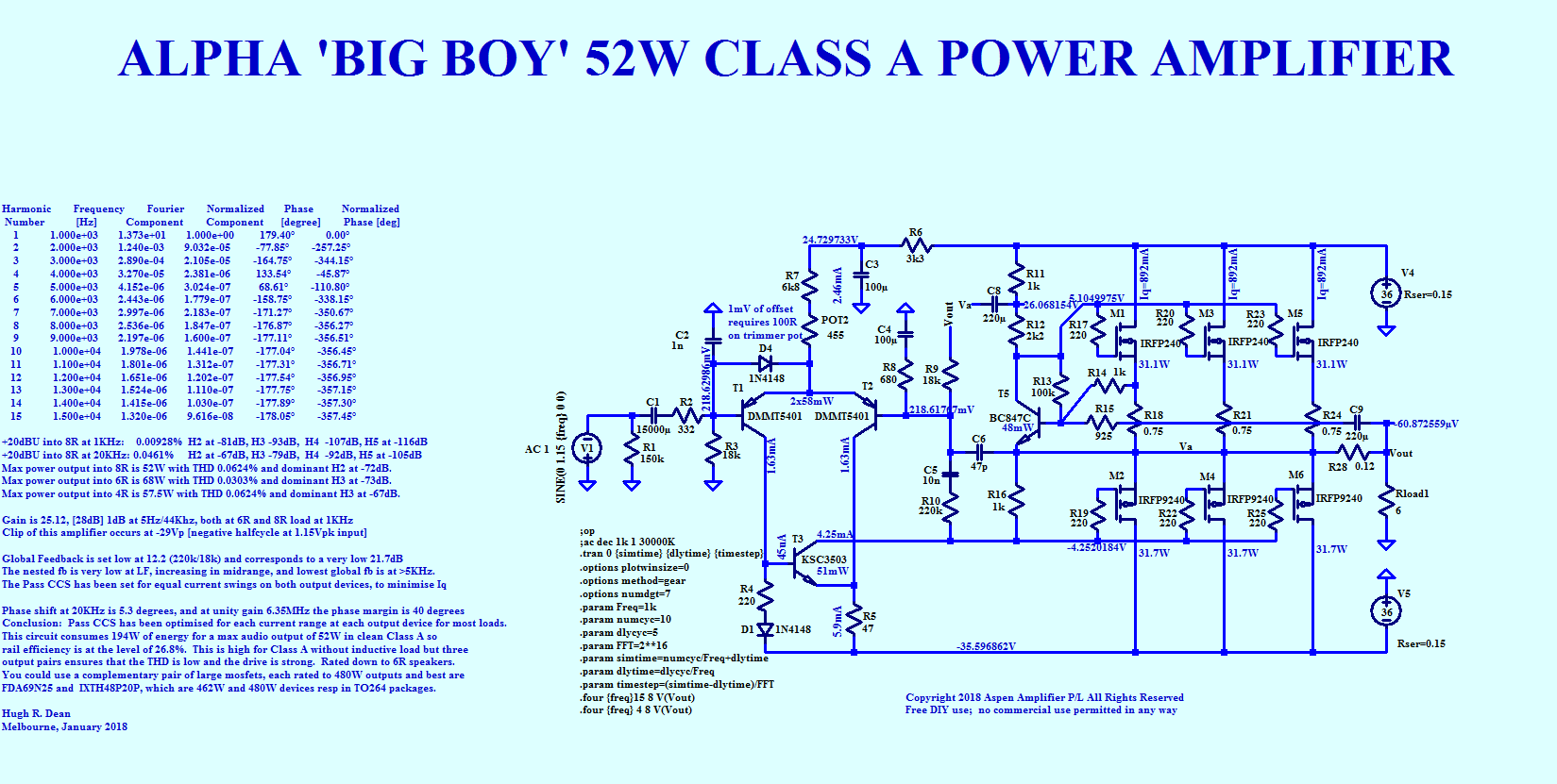

*** 52 Watt Version ***
Here is the 52W Big Boy (BB) version of ALPHA coming up soon. Waiting for beta test to verify functionality.
Edit April 4, 2018: as-built schematic for Alpha 20 for 1.35amp bias.
Edit April 15, 2018: ALPHA BB GB is proceeding. Cost of 1 pair of 2mm thick FRP, 2oz copper, ENIG finish is $60. Shipping in US is $8, Canada is $17, everywhere else is $24 (10oz weight 240mm x 130mm size is expensive to ship).

V121 is a critical part of the dynamic Aleph CCS by Nelson Pass. Take that out and it is no longer an Aleph. The power efficiency will go down, and the name will not be ALPHA, but ALPHC (doesn't have quite the same ring, does it?) 🙂
I say why not change it to LM337 then V121 is unnecessary and it is not an Aleph output stage. It becomes an XRK971 output stage. Oh well I did try to nudge you a little into being daring and making some changes see if it affects the sound at all.

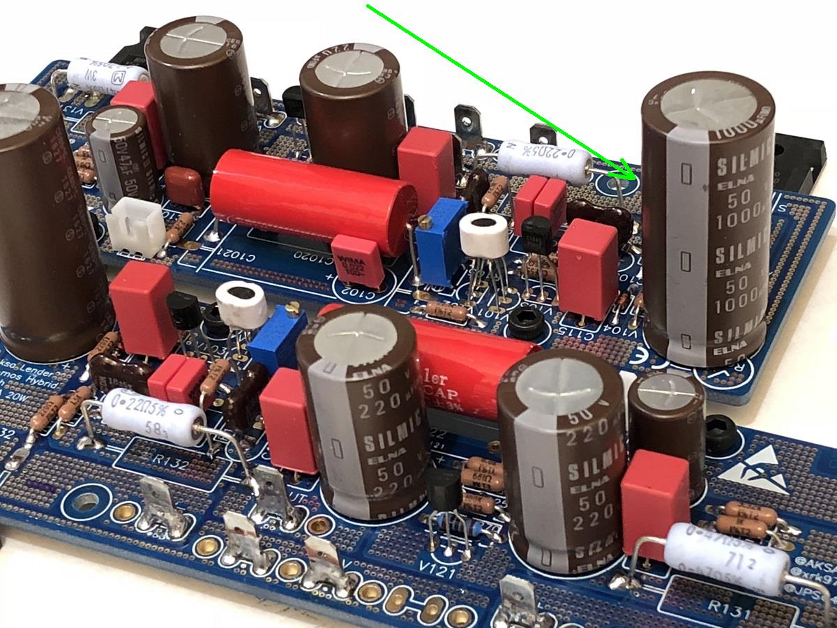

I placed the capacitors order from S Korea based on the circuit was drawn by X for this amp and some other projects.
Just realized now when I was checking out this thread the picture X posted (why that capacitor size so large) it is 1000uF not 100uF.
Instead the 47uF I ordered 100uF.
My fault I did not found the BOM when I placed the order so I used the circuit was at hand
I also used that to do my layout with the 3 pairs.
6 Weeks until the package arrive if I order it again another 6 weeks. Yeak.
I have at home some Panasonic FC type, not my favorite I think to test the amp it will do the job.

It is my fault, I used the BB circuit, not the Alpha, I did not see there is some difference between the two.😱
Just compared the two schematics now.
The 1000uF 50v feedback shunt cap, can probably be made 220uF with no problem - Panasonic FC is a fine cap. I know what you mean about overseas orders though. Sometimes best to order several values so that it can be used on other projects too rather than on a per amp basis. Good luck with your Alpha build though.
