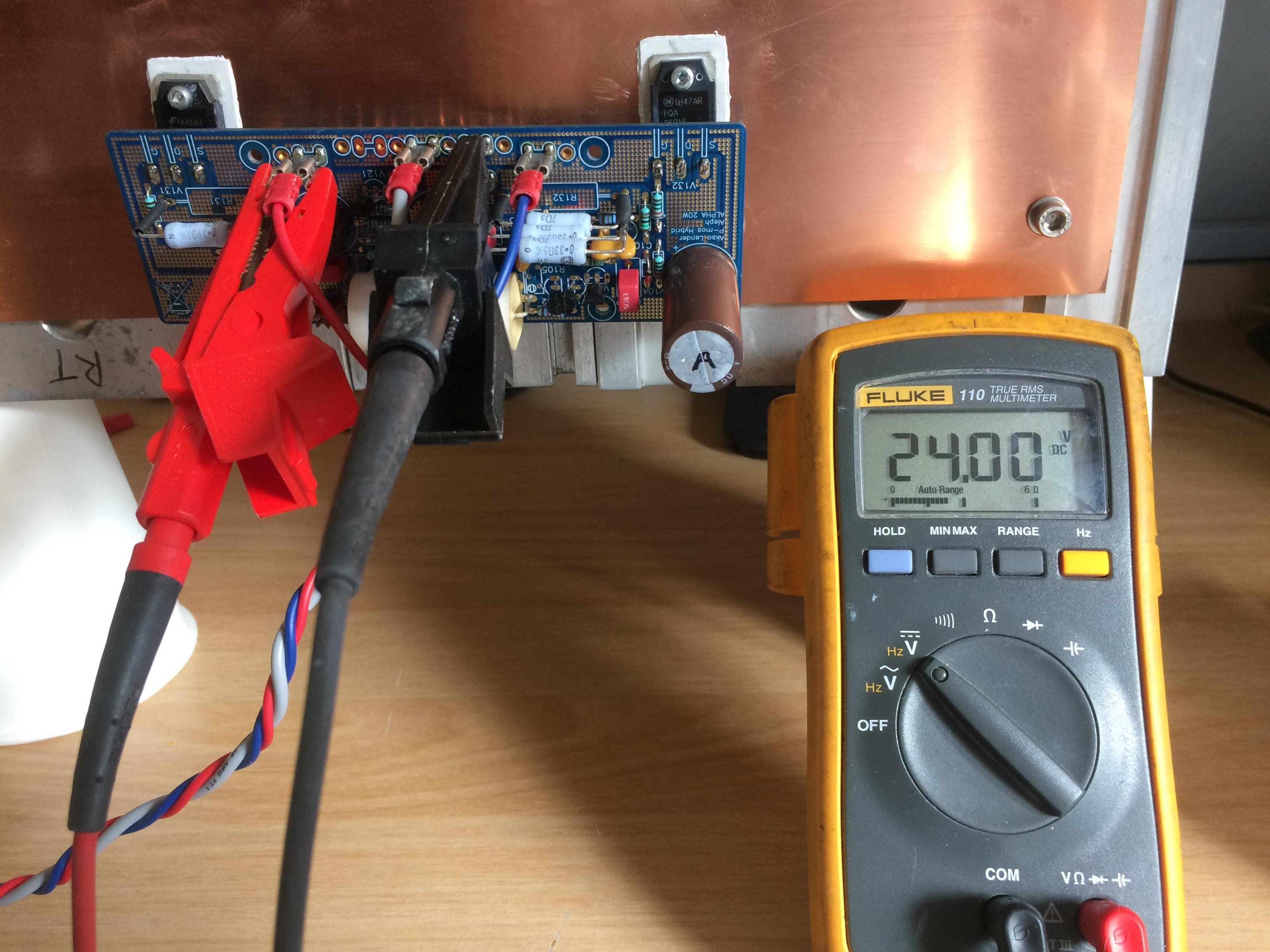

X and I have slightly different ideas about the power supply. Both work, so you can hear my idea.
On the original design of the ALPHA 20 I just assumed I'd be using a cap multiplier and watched X struggle with the voltage sags which took power from the amp.
So I used Duncan's power supply software to examine another option.
I can up with a CRCRCRC, using all 15000uF 50VW caps and 0.15R resistors on BOTH resistors on each cap, one on positive electrode and the other on negative.
Using a 18Vac secondary on the transformer with source impedance of 0.2 ohm, and running 1.5A quiescent, voltages at C1-C4 were:
C1 22.56V with 770mV of 100Hz ripple,
C2 22.00V with 151mV of 100Hz ripple,
C3 21.53V with 36mV of 100Hz ripple, and
C4 21.06V with 10mV of 100Hz ripple.
Of course 21V is a bit low for a 24V amp, so I suggest now a 22Vac transformer which gives you 26V dc with 12.8mV of 100Hz ripple.

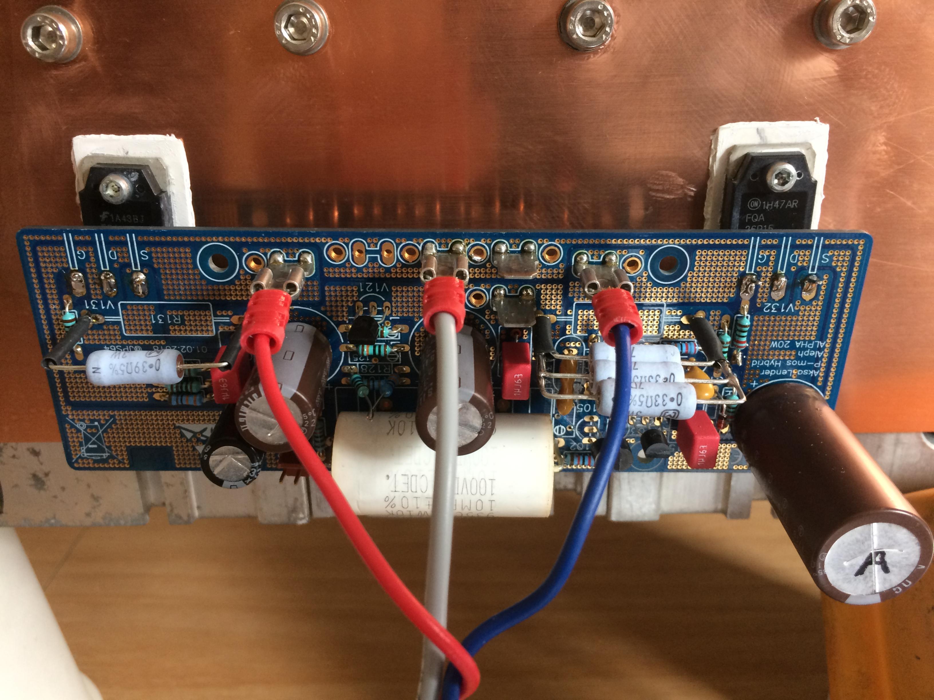

There is a slight bit of hum coming from the speakers if I put my ear to them, but I don’t think it would be audible if less efficient speakers were used.
I think I hit all the main details, now it’s time to enjoy this DIY treat😀
Today, I went back into my ALPHA20 to solve the slight noises I can hear with my ear right up to the speaker. Even though I can’t hear anything from 4 feet away, it’s in my head that it’s there 🙄
I referenced an article that someone (sorry forgot who) posted a link to a while back,
‘Advanced Grounding Guruship’.
When I started to trouble shoot, I realized that the noise was not totally a ground loop hum but RFI/EMI from the 20 LED recessed lights with dimmers in my living area. Even though my system has two dedicated 20amp AC homeruns direct to the electric panel, this interference is still a problem!
So, this is what I added/tweaked:
— Ground lift (bridge rectifier w/1nF cap across ac tabs)
— Single chassis ground (trafo screen, gnd lift, mains earth)
—“Hum Buster” 15R resistor on the backside of each alpha board between signal gnd pad and one of the unused 0V pads.
— Improved shielded input wire from rca jacks to alpha boards.
— Added Russian PIO 0.1uF input bypass caps to the installed Silmic II’s. (Just for fun🙂)
Did anything change??
YES!!
With all LED lights off, the noise floor is almost inaudible with my ear to the speaker. Absolutely not a problem! When I turn the lights on, I still get a slight noise. I think since my chassis is wood/aluminum I will not be able to completely protect it from the LED interference. Unless I insulated with mu metal, but that’s not happening 😀
Today, I went back into my ALPHA20 to solve the slight noises I can hear with my ear right up to the speaker...
YES!!

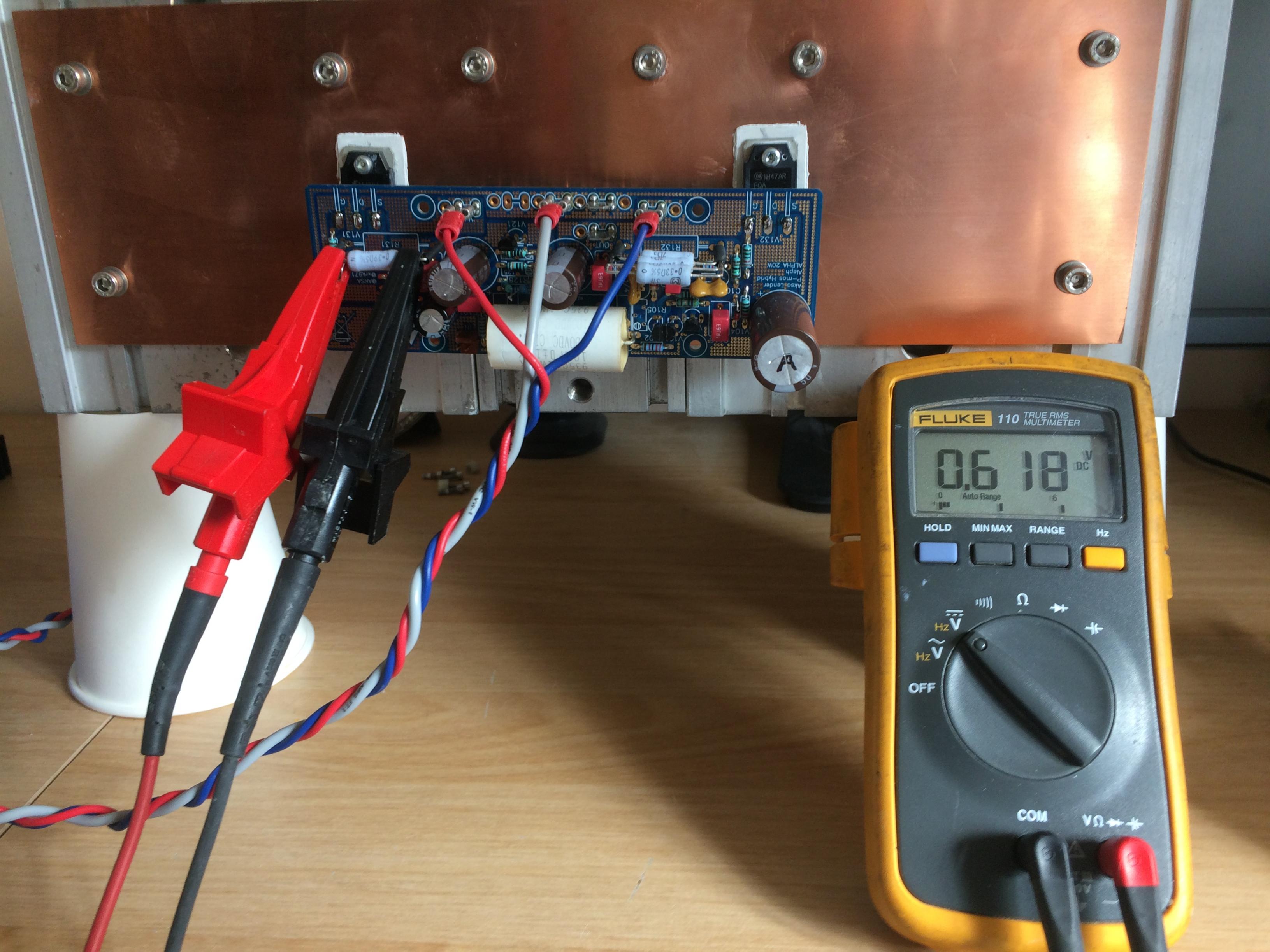

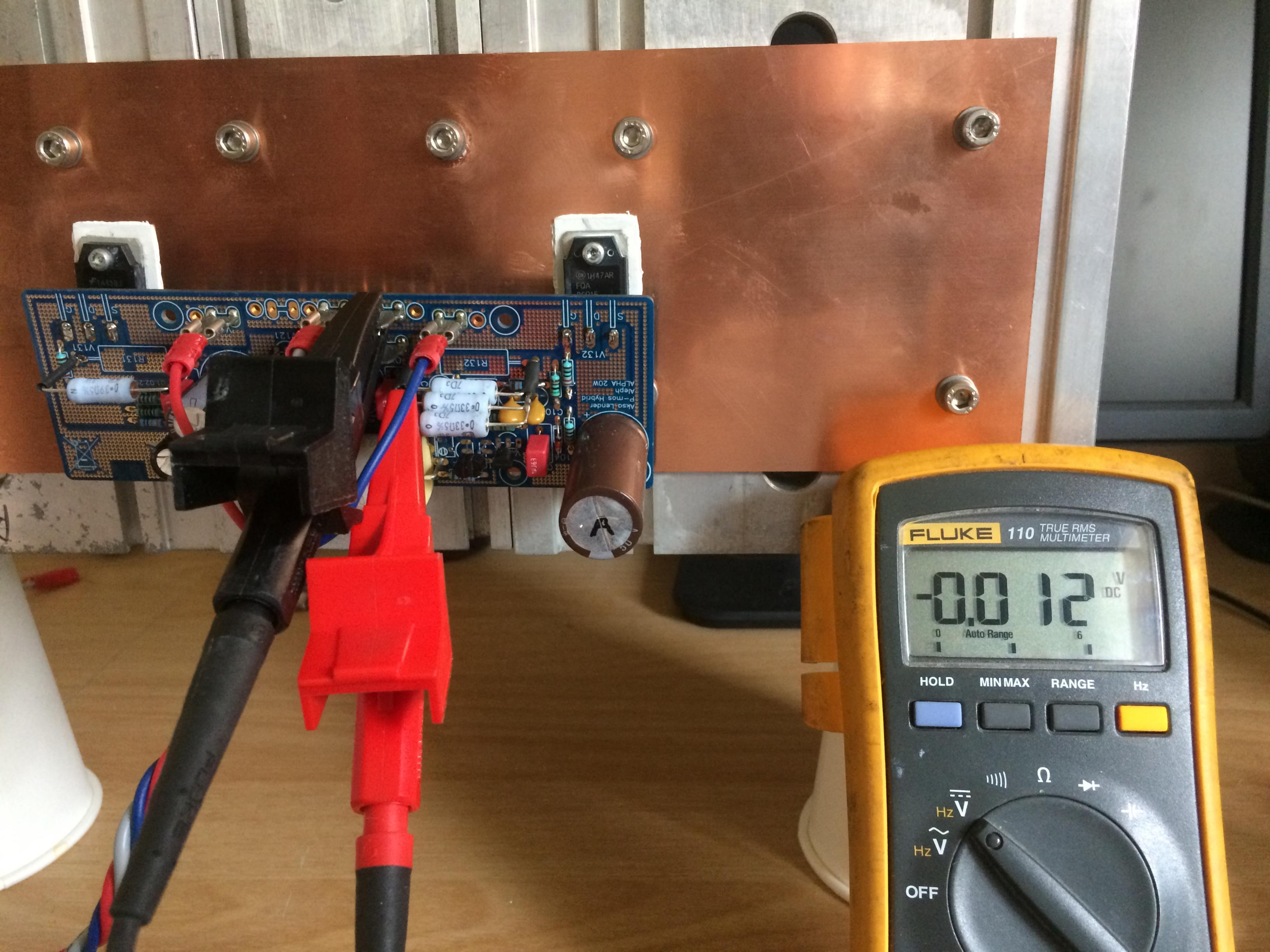

Hi, I have now these values for setting bias:
R131. 0.39ohm
R132. 0.11 ohm
R128. 600ohm ( I estimated this value from one of Danny's posts as I do not know how to calculate it exactly)
This gives a bias of 1.6A
My temporary power supply for testing is 18-0-18 transformer, single bridge rectifier, then 47,000uf ,0.1 ohm 22,000 if, 0.1ohm, 22,000 if per rail.
I measure about 50mV AC on the last capacitor but cannot detect any hum from the speaker even with my ear pressed against it. They are only 87db though.

Hi Alan,
For 0.39r source and 0.11r sensor, 540r fb gives perfect balanced currents for the CCS and the output transistor.
