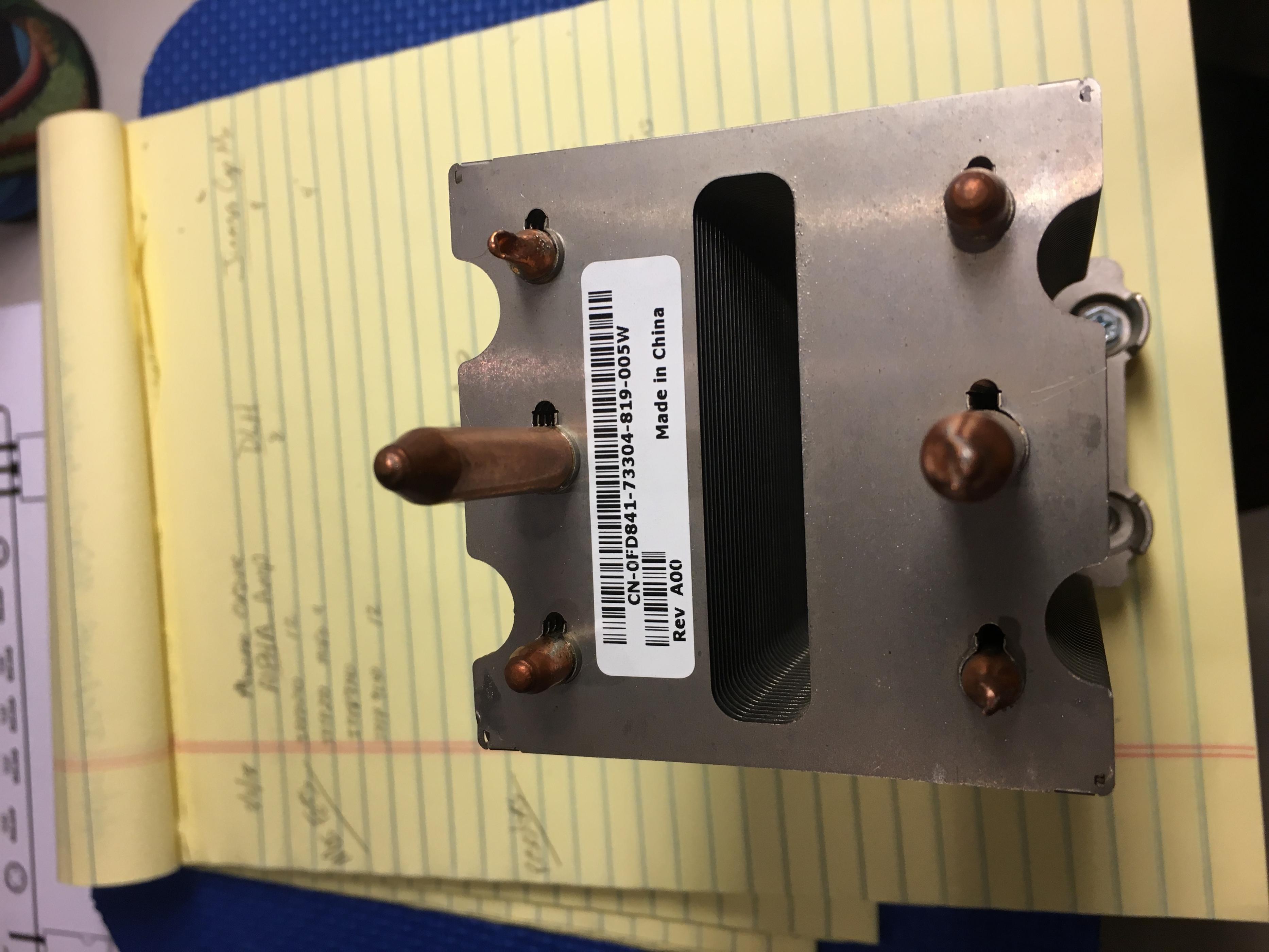

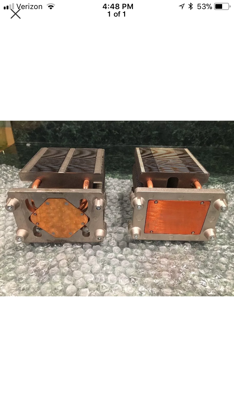

Hi Nick,
I got the Dell fd841 coolers from eBay.
But, There is two versions of them make sure you purchase the ones with 73304 in the model number. That’s the one that has the large copper mounting surface. Compare in the picture I’m attaching.
