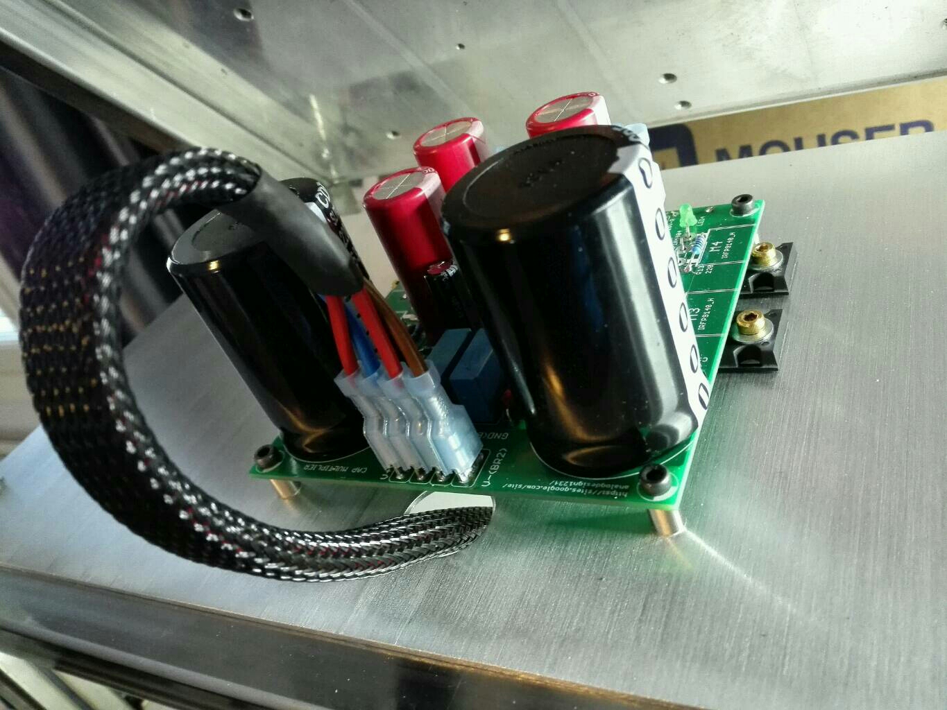

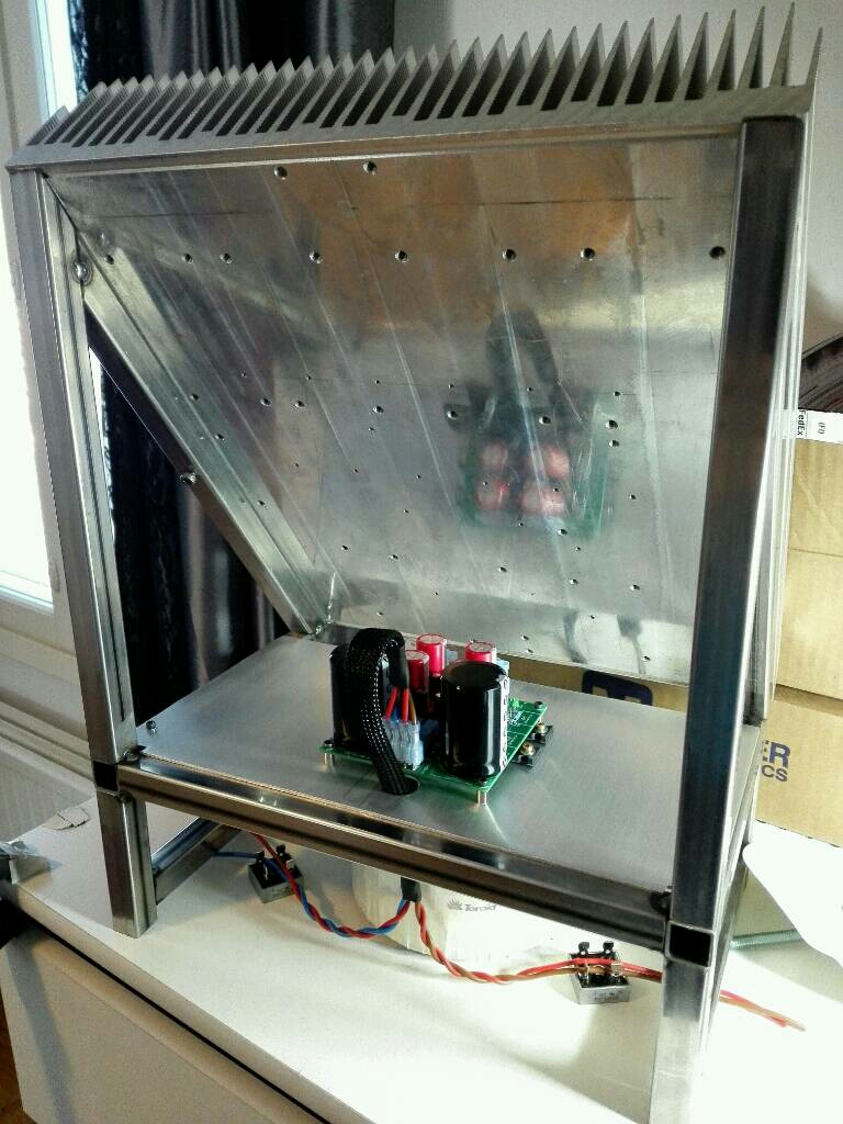

Piece by piece, slowly it's going to get it's PSU and frame ready. Too big toroid just for modeling it's upcoming place. Tomorrow I'll try to add lower platform for trafo and rectifiers (3mm alu). First test will be as "skeleton"-frame, if I get it work right then aluminium sheets all around and dreaming about BigBoy-version 😀

Thanks X! This frame is for prototyping purposes only, so that's why there's only dots welded quickly. Final frame will be Tig welded all over, this is because I usually drill holes in wrong positions and change my mind on layout and stuff before it's finally done 🙂 for example I was thinking external PSU at first. Then ditched that idea and made lower section for trafo. Of course it's lot of work to build working prototype first and then take everything apart for final frame 🙁
Sinks might be enough for BB-version, I used them Alpha 5 60w before. But I was thinking water-cooled BB 🙂?
While in university, I had access to a TIG welder in the shop and lots of stainless tubing lying around and made some nice stuff. It’s a lot of fun and surprisingly easy if you have a half-steady hand. Soldering SMTs neatly is probably more difficult.
Oh, you must been like in candy shop 😀 it really is quite fun. My girlfriend is actually Tig-welder, so she will do weldings for final frame. I will try to find some stainless if I can.
Maybe get the heatsinks black anodized? That will improve thermal efficiency as a radiator. The anodized surface effectively is a non-conductor. My DIYA store Dissipante case is steel with black anodized heatsinks and has no issues. The trick is getting electrical connection for the grounding to be effective. Either has to be via screw threads which are not anodized or use sandpaper to remove coating where ground connection goes.
