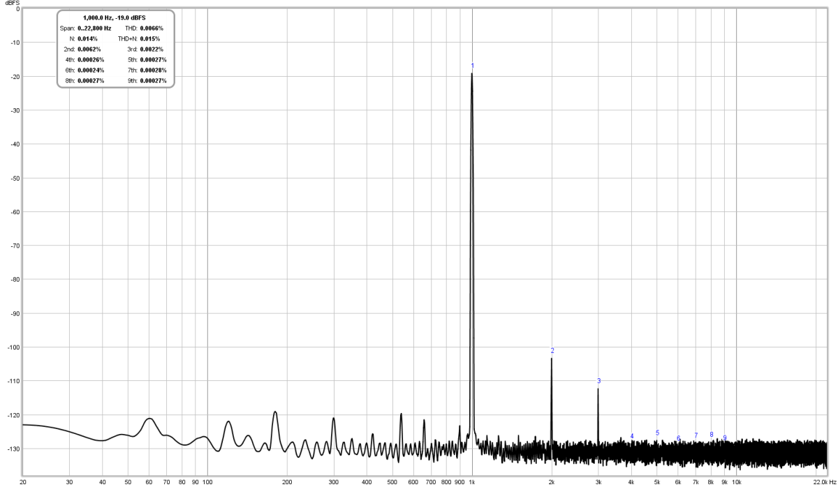

The above things lets you make a measurement like this - the ALPHA20 at 2.87vrms into 8ohms:
661737d1518324741-aksa-lender-mos-hybrid-aleph-alpha-amplifier-alpha-20-2-87vrms-8ohms-fft-png
This is one of the most beautiful FFTs I have seen from a power amp running on a linear trafo based PSU with an F6 (CR-2xCRC) PSU, notice the dominant 2nd order and decreasing higher orders with 3rd order at least 10dB lower than 2nd order, and lack of any higher orders within noise floor of the measurement. The -130dB noise floor is the limitation of a consumer sound interface like the Focusrite. This is where a $40k AP system will allow measurements down to -150dB noise floor, but is that getting you more info that you need to debug the major things?
So here is what this system can tell you - when I run my F6 PSU in stereo, the extra current draw causes the AC line ripple to increase and this is clearly evident with the FFT. This says that if you want this clean performance in stereo, a dual 400VA 18vac trafo monoblock is needed.
Here is 2.79vrms into 8ohms in the second channel with the first one also running at 1.3amps bias:
661770d1518342164-aksa-lender-mos-hybrid-aleph-alpha-amplifier-alpha-20-2-79vrms-8ohms-fft-png
Actually it is still very good with only a +10dB increase but not flat as a board anymore. Just depends on your level of discomfort knowing that there are AC mains harmonics floating around in your signal. Most people would be very happy with this I suppose.
However, this is the 1.31amp bias case. For those chasing even lower THD and wishing to run 2.0amp bias as Hugh has designed it for, you definitely should do dual 400VA trafos and dual PSU's monoblocks.
After reviewing the above data again, and since I am still debugging the noise issue with the SMPS/DC boost/Cap Mx PSU option, if you are looking to proceed with a verified clean sounding and measuring ALPHA 20 at this point, I highly recommend to go the linear trafo route with the F6 PSU until I can solve the noise issue. But note that it is for 1.3amps bias (attained via 047R source resistors vs specified 0.33R).

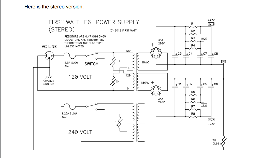

F6 PSU for your reference
I noticed that the F6 PSU is rather hard to find with a search, so here it is:
attachment.php
It has a subtle difference from basic F1 supply from Pass in that there is a split 2x RC on left and right for more stereo separation. Follow it exactly with all CL60 NTCs and topology of where grounding occurs, let no grounds be made inadvertently, control all connections to ground.

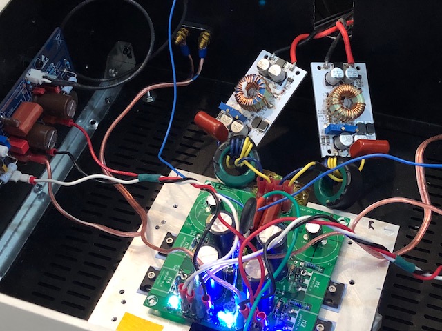

Some progress... after looking at some of the nice links in DC-DC converters that JPS64 posted I tried adding a common mode choke between the DC-DC converter and the cap Mx using 3 turns ea antiphase windings on a 1in diameter ferrite toroidal choke. I added a 1uF 630v MKT capacitor between the outputs of DC converter (really should be on the other side of choke but that would have required taking cap Mx out). Anyhow, it really reduced audible noise in one of the channels and less so in the other. I don’t know why they would be different. But you really have to press your ears to the cone to hear noise. I think for speaker listening it would be fine. I even skipped the output CRC. So it’s a pretty simple system at present with a very modest amount of actual capacitors. Largest are the 4700uF output caps at the cap Mx.
attachment.php
When I have more time, properly earth grounding the chassis and bolting the metal PCB DC converter to the chassis will probably help some more. Right now chassis is floating relative to earth ground.

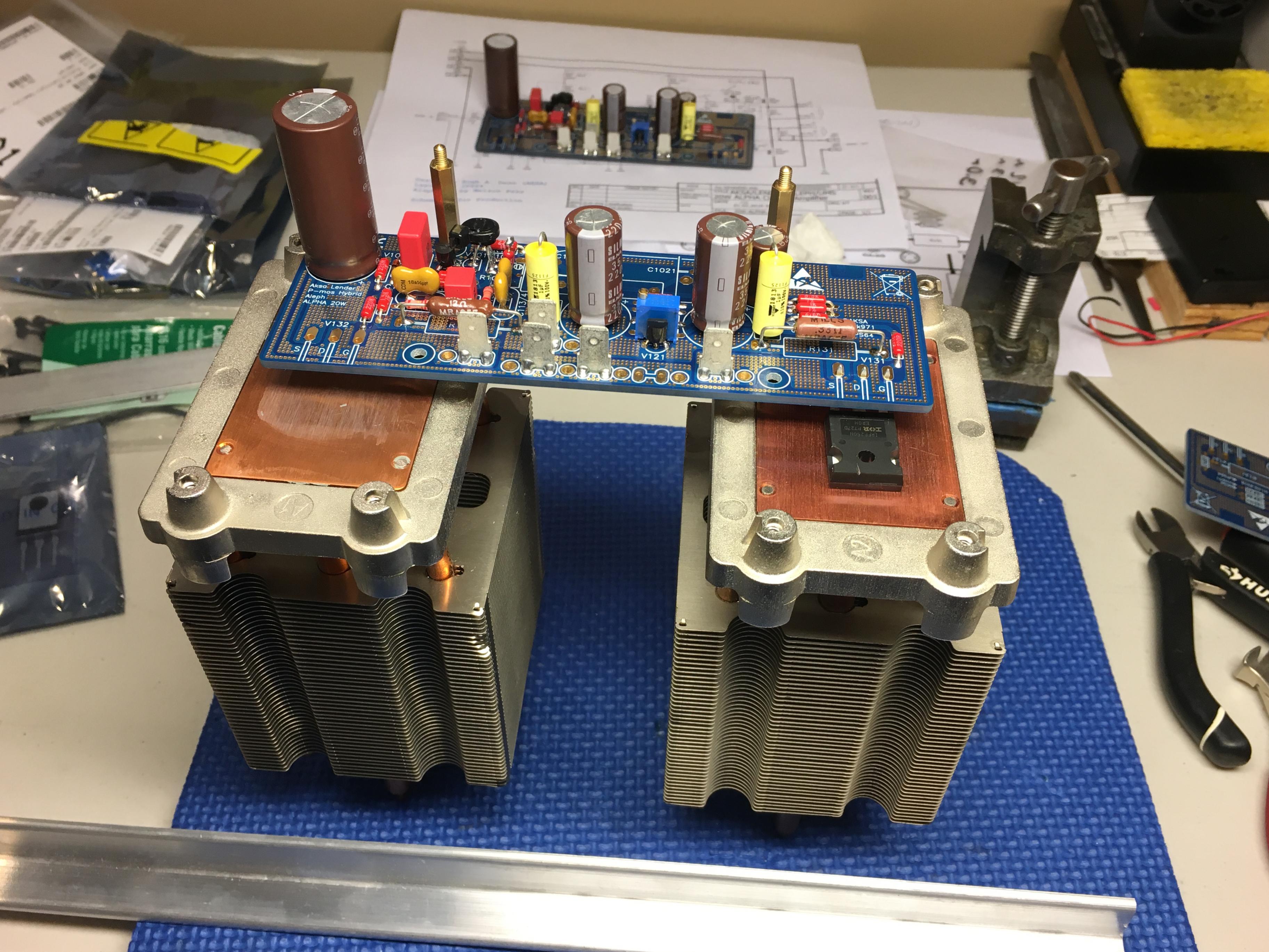

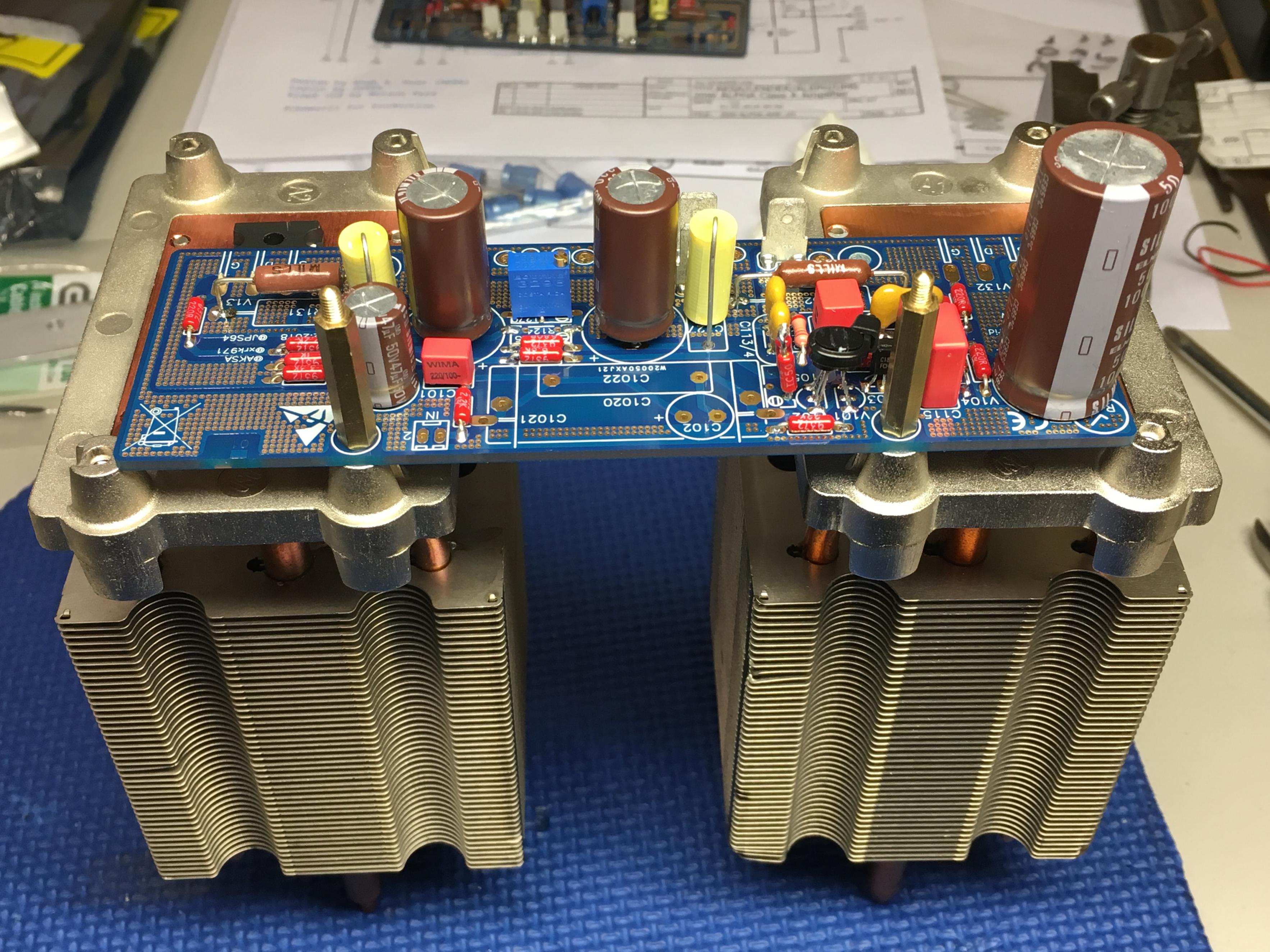

So this is what I came up with....
3/4”x3/4” Aluminium angle stock will run parallel and attach the two CPU coolers above the mounting bosses to create a rigid frame. Below(copper plate side) the ALPHA board will attach using only two of the four mounting holes.
3/4” Aluminium flat stock spanning both coolers will be used to clamp the MosFets to the copper surface as close to center as possible. Two of these ‘modules’ will be made. At this point I could make a pair of mono blocks or join them together into a single chassis. I have to figure out what type of power supply I will settle on. I’m going to try the smps route first.
That looks very good Vunce. Excellent use of existing boss on cpu cooler to mount the board. I had to drill and tap two 4-40 threads on the aluminum frame of the CPU cooler to clamp the MOSFETs with L shaped aluminum clamp. If you can mount side by side PCBs and use just two CPU coolers that would be cool. Very nice work. You got some premium resistors there!
