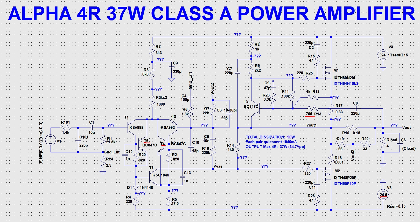

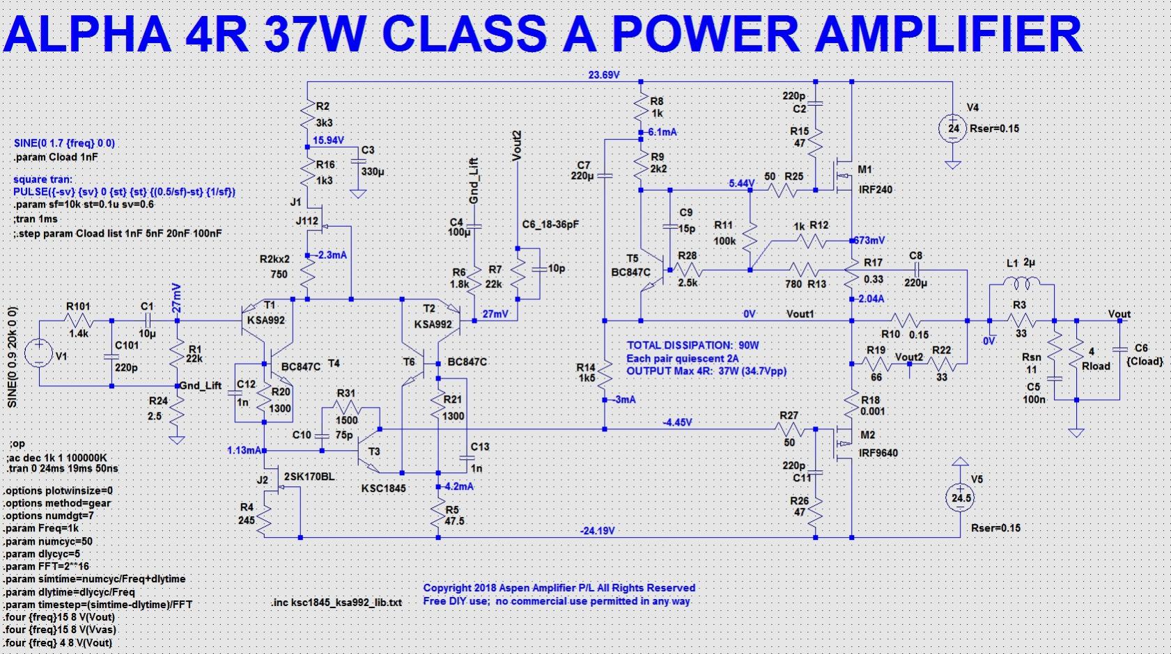

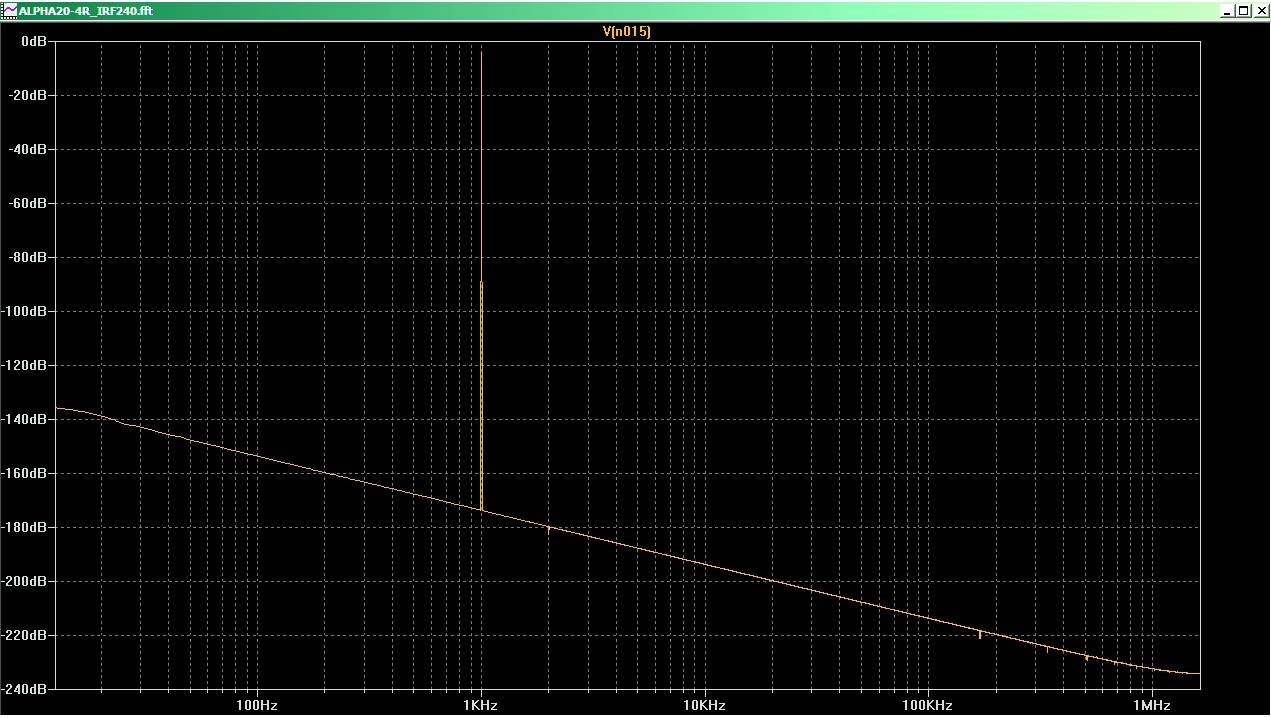

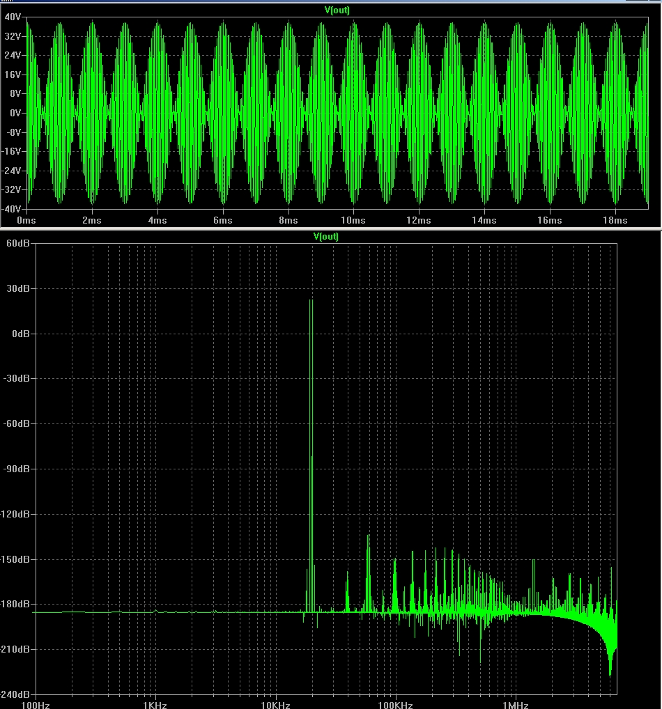

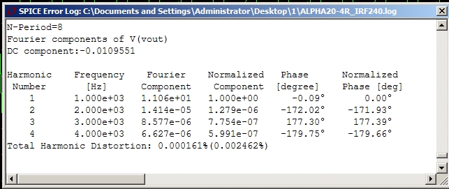

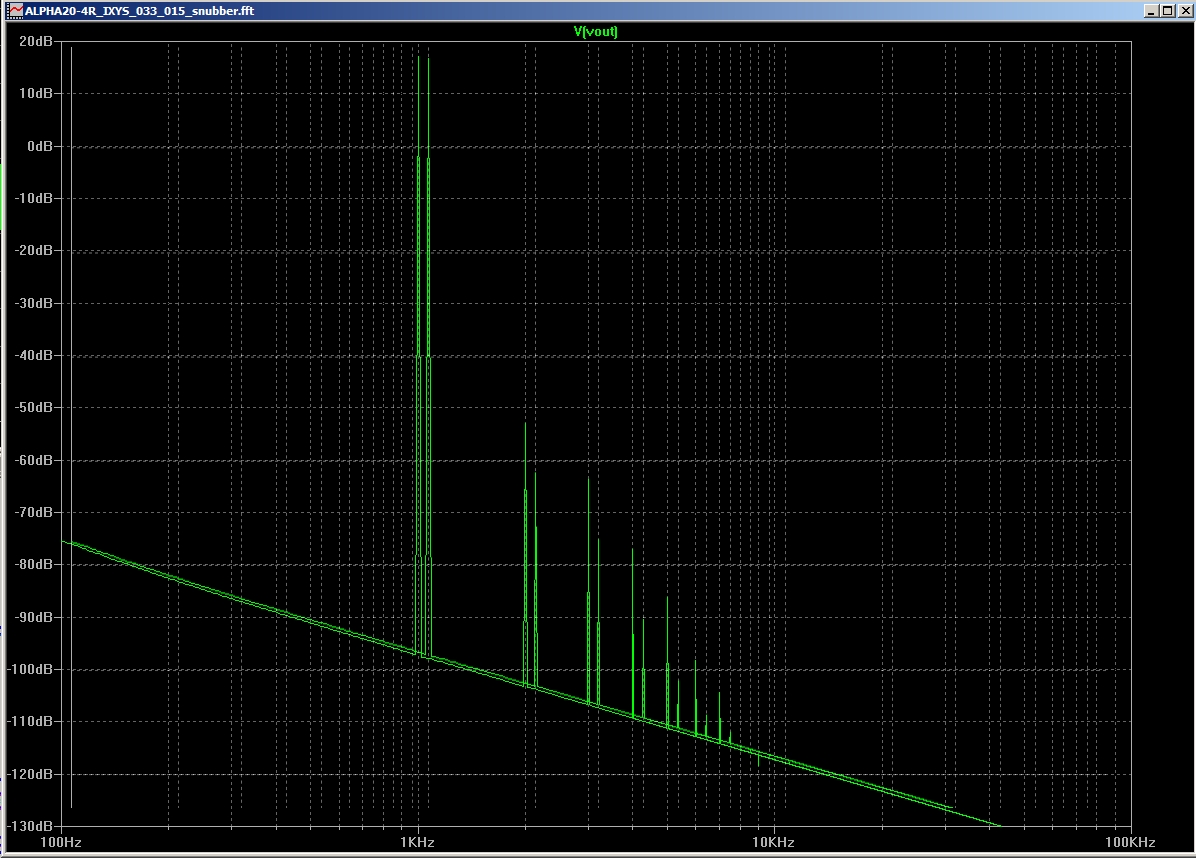

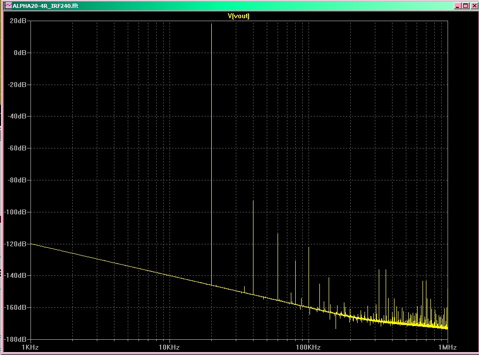

Hi guys. Forgive me for getting into the topic. I am learning a little to work in the simulator. Distortion in this amplifier has been significantly reduced.
Good results. However, to be sure it's 'better' you must build both versions, standard your enhanced version, and then carefully audition it.
It is not sufficient to produce simulations to assess an amp; there is the psychoacoustic aspect, and you MUST audition it.
Good techniques to reduce distortion, looks good, but BUILD IT rather than proclaiming it superior to the original. Then tell the forum how it compares!
HD
HD
