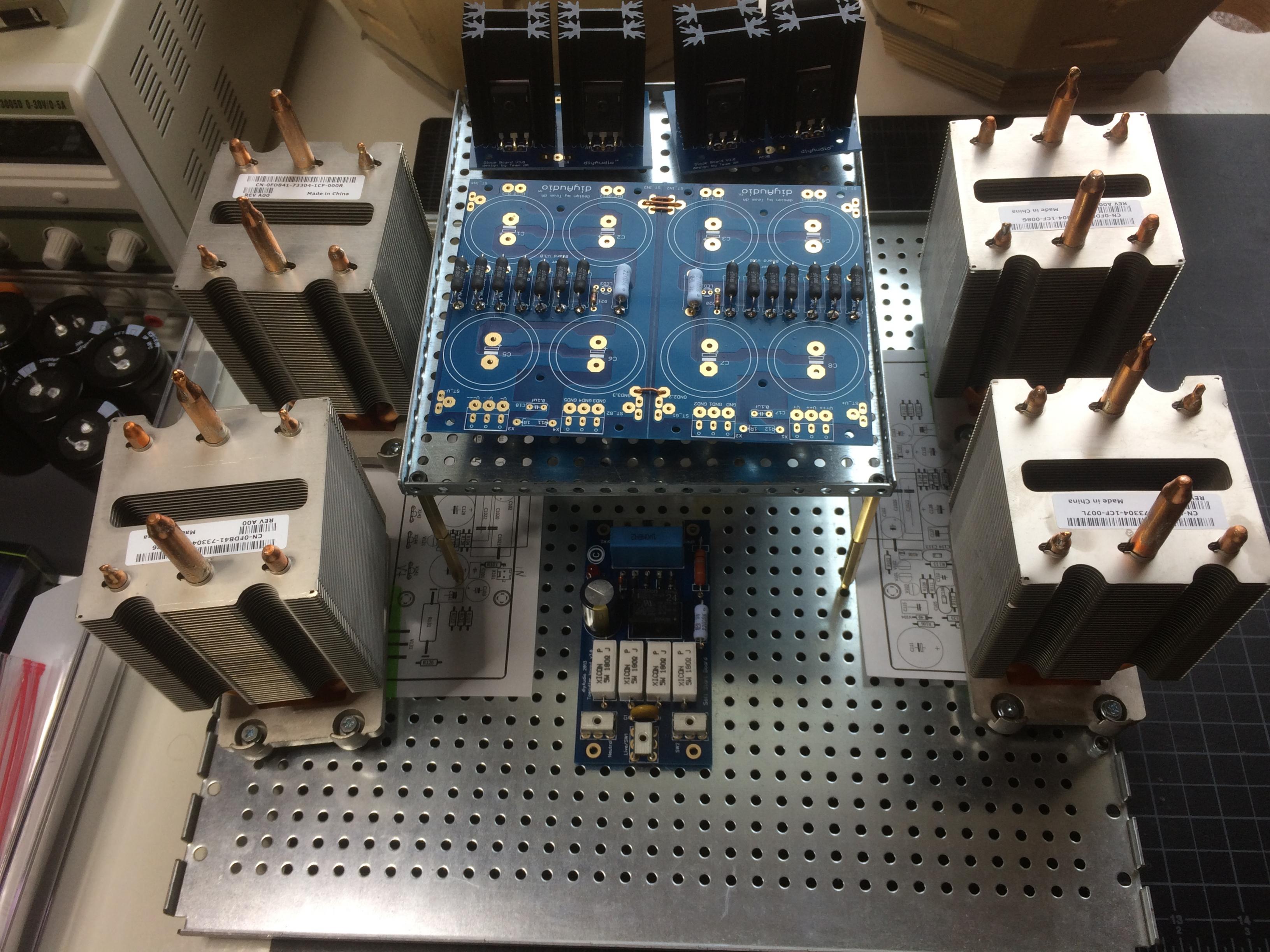

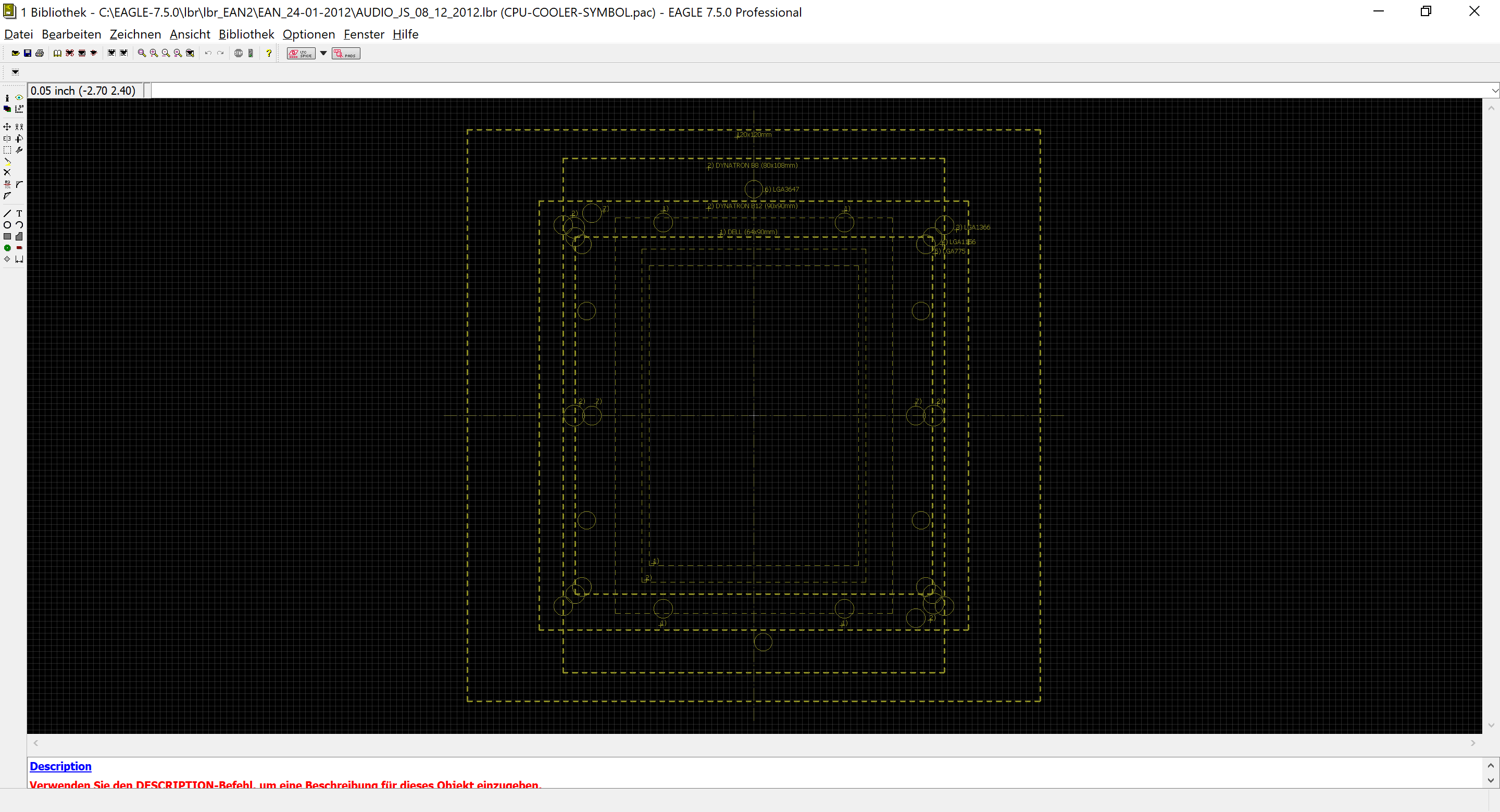

The attachment shows the templates for the possible CPU-cooler. The builder could buy what they want, it´s lost time to do a list, sorry X (the list would be to long).

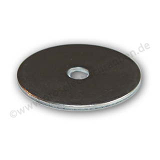

The CPU-cooler datasheets don´t give details about spacers, don´t give much details at all (only says compatible to a type of CPU socket; 9mm is the gap you measured for the Dell CPU-cooler, admitting 5mm thickness for mosfet, 2mm PCB thickness, we´ve 2mm gap for clamping):
- decide, according template what cooler you want to use; small plate or bigger plate is the only important point to consider
- smaller CPU-cooler plate needs for 3 mosfet version adapter plate
- mount bended mosfet(s) but don´t solder them yet
- use mica or what you want for thermal coupling

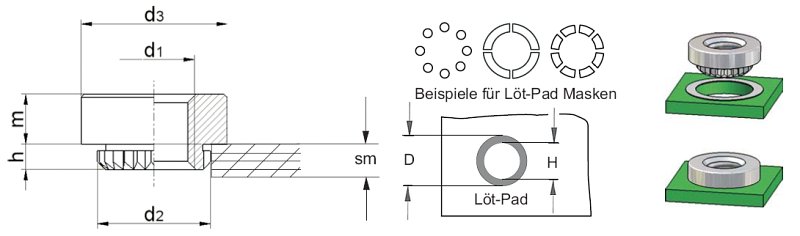

- clamp them using DIN916 screw (KFT nut press-fitted into PCB) and big washer
- secure screw
I would recommending NOCTUA NH-D9L (NF-A9 fan, 4p. connector, 12V, PWM, TAC) and only two mosfet version.
In fact, we´ve to built different versions.
In fact, I´m still braining...
Comments, suggestions are welcome!

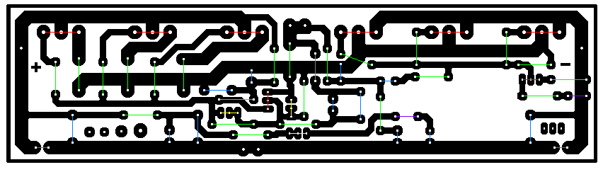

Almost finished...
I need to find a good replacement for DMMT5401 transistor.
I have some old Toshiba transistors at hand I have to look them up.
Still missing the input because the mentioned transistor, I did work a lot on this layout, not much room to maneuver around 😀

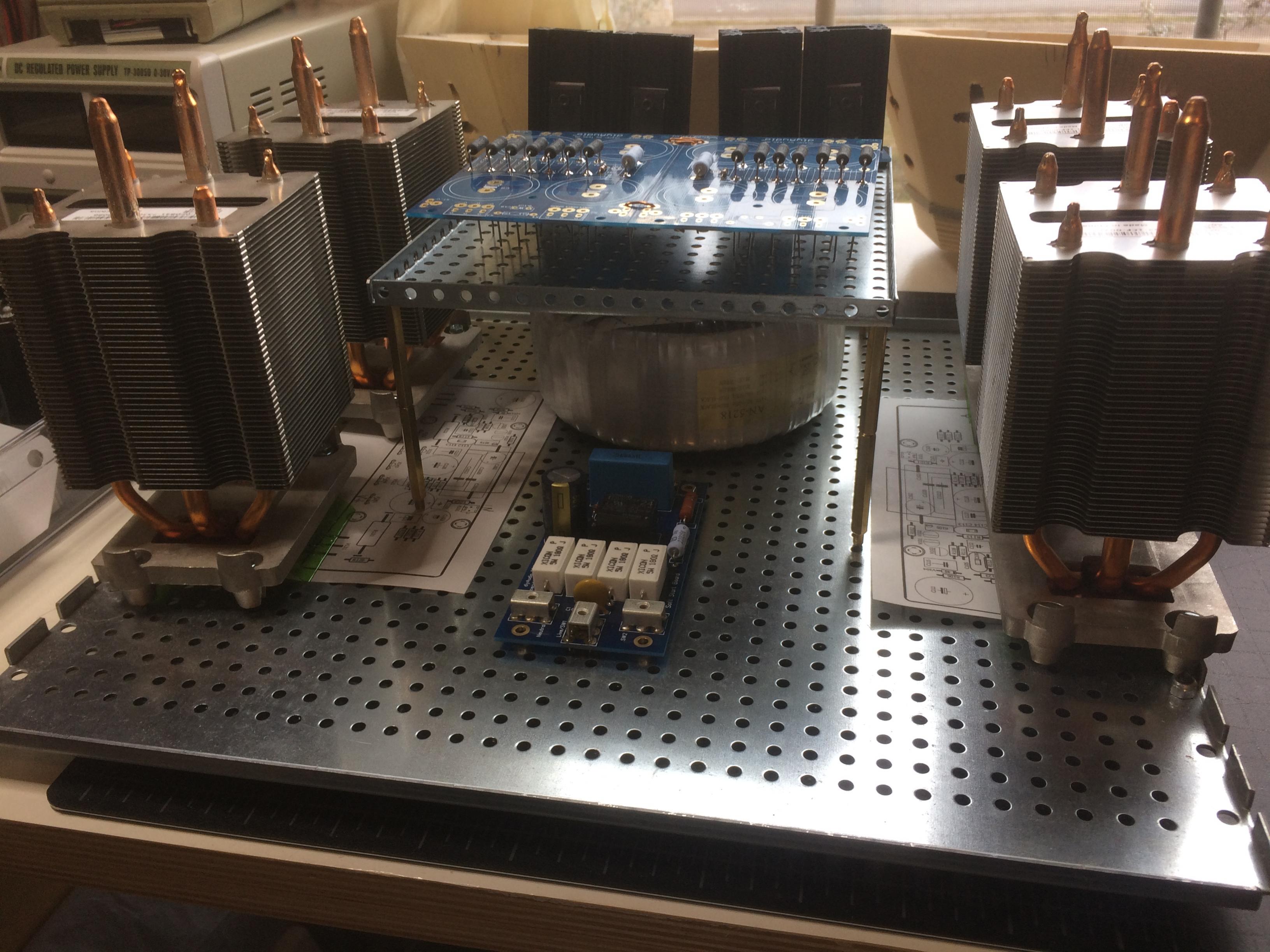

Working on layout for my Alpha 20w:
not sure if heatsinks will mount horizontally, or vertically. I have a few different sized chassis plates that I could use, or just as easily make my own from 3mm aluminum.
Trying to optimize location of low level input and any a/c, among other things.
Anyone else starting to plan out layout?

Looking good!
I took my good old 4U chassis and took it apart, was wondering about heatsinks but maybe I'm going with cpu coolers also. You have a link where to get those you use?
