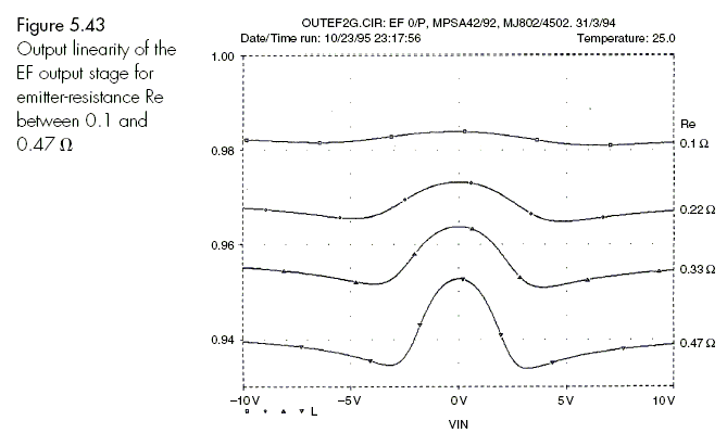

pooge said:Well excuse me!
Hugh made a statement that linearity is improved with larger resistance. I guess I just assumed that was an objective statement with something objective to support it other than subjective listening.
Well the claim is a load of nonsense of course, but typical.
AKSA said:#4 I was asked. I gave an answer. If you do not find it satisfactory, I politely point out that the onus is on you to research it and find why to your satisfaction. Experience is not transferable, but it is easily replicated. You do not have to tell anyone; no one here has placed obligations on you, Sir.
The inevitable, disingenuous evasion.
Larger emitter resistors mean greater crossover distortion and greater susceptibility to increased gm doubling (high order distortion) with temperature induced drift in Iq from optimal.
Anyone actually interested in researching this for themselves can start at chapter 5 of the Audio Power Amplifier Design Handbook:
EDIT: But then again, who gives a toss about the truth anyway?
I could be mistaken, but looks to me like Holton doesnt use emitter resistors at all, at least I dont see any 😱
