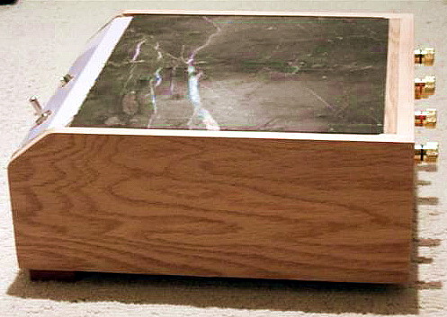

my aksa progress, wood case, bronze front, marble tile top lid[nice and heavy], stacked aluminum plate heatsink, venting cutout under heatsinks, top lid has air vent along each side.
For sure I will maximize venting and once working will be able to check heat build up.Looking forward to getting it done, and I can do it; but 1st must finish with the move. [it's so much work!]

Those holes may be enougth, if you produce almost the same area upper the cabinet,...
...it can be downwards.....or upwards the enclosure back panel too, but as you know, better to put the holes directly over the heatsink.
The upper holes can be a little bigger in area than the down holes...i perceived that this way cooling works fine.
I perceived you have good space down the enclosure, it will be great to cooling.
Also AKSA do not overheat....the iddle current, quiescent current, stand by current is small...so, average dissipation is not big...a real AB circuit, sligthly underbiased.
