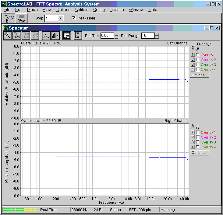

Watch the attached file ... this is our self-build A/D.
Is it good? Sinus Sweep!
ADC cs5361.

What do you think about my tests of cs5361?
We changed OPA2134 to the cheaper NE5532 and it got much better:
SNR: 109,5 dB
THD+N is 0,0001%
So I don't like the OPA2134 anymore )
Is it compatible to the AD8620/10?
Where can I get it?
Output I need AES3 and S/PDIF.
For clocking we are using a MK1412A at the moment!

Howdy TobWen,
using opamps in front of a adc like the 5361/81 is a sin, and the ne5532???!!!
I've not played with the cs5381, only the 5361, 5351 and the ad1871. A CLEAN clock, no matter the chip, is crucial.
I'd rather use a cs5351 with a discrete front end using matched transitors and plastic film caps then a 5381 with opamps and non bypassed electrolytic caps, eeeeeeeeeeeeeeeeeeee.
Spose this is why I diy, I think opamps should NEVER ever be used, they suck.
Getting the power supplies clean enough for high end adc work isn't easy, good luck
Mark Hathaway

How does your project measure w. OPA2134s??? NE5532 has a good output stage that delivers less THD with low load inpedances at high frequencies. It is a very good opamp for it's price. AD8620 claims to be some state-of-the-art opamp, and very expensive too
Look for Analog Devices distributor. www.analog.com
You need something like the CS8405/06 for S/PDIF transmitter, if you want sync think about AD1896 from AD, and some PLL for audio... /is MK1412 such, or it is the equipped clock generator in your studio??/
With discrette transistors u can get better results at lower prices, but u need to be advanced analog engeneer to design them, otherway better do with OPAMPS. Good Power Supply and clock is critical.
NE5532 vs OPA2134 - the first can generate much more ID when speed overloaded due to its BJT vs. FET /in OPA2134/ input stage. For best performance use FET OPAMS or Fast Bipolar OPAMPs, some Video OPAMPs with voltage feedback etc. With discrette bjt one can do this easily, at the price of increased noise /1..2uV ref. input/

machinow,
can't say anything about that
atm the MK1412 is the clock on the A/D and it works for now
At the studio a Fostex D15 acts as a wordclock.
Of course, better analog-equipment could raise quality, but it is hard to get samples and I don't want to change my circuits every day :-((
atm I don't do any resampling. I set the CS5361 to 44.1 KHz and record
don't have one here :-(How does your project measure w. OPA2134s
We are using CS8405AYou need something like the CS8405/06 for S/PDIF transmitter
