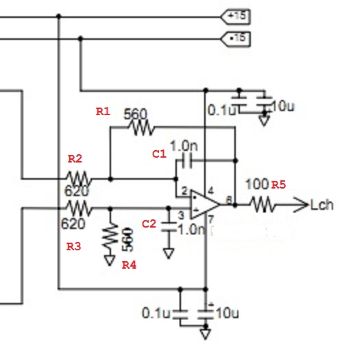

I have a question about changing the EVM circuit to use a current feedback op amp, the LME49713HA. It has +/-100mA output and can "easily drive 150R loads" and it seems to have pretty low distortion and noise too, and is able to drive some capacitance. So I think it should be able to drive headphones like Senn HD650 directly, if I add some gain.
I am planning to remove C1 and add a 600z ferrite in series after R1, or I could keep C1 and cut the trace into the neg op amp input and put the ferrite there. This follows Ti's advice about using cfb op amps, that Abrax posted in the es9018 thread. So, without having sim software, which one seems like the best idea ? What about C2 ? I assume it can stay since it is not in the neg f'back loop so it won't cause instability.
Then I need to change the resistor values for some gain, say +3, so change R2 and R3.
I was also thinking of reducing R5 to see if it would improve dynamics. Did I understand this right ?

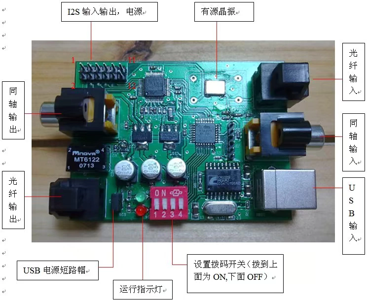

I cannot get this DAC to play music.
I have checked all power points, signal connections, data connections, etc. There are no shorts and all connections are good, with all the right pins getting the voltages, gnd, signal, etc they need. I can get it to buzz, hum, crackle, pop, etc but not decode pcm.
I have all the dif0-2 high for 32 bit I2S (which is my source, tested on other DACs too) and I have tried tying dif2 low for 24 bit i2s. I have also tried tying dem1 low to set de-emphasis to off, just in case.
There is no dc offset or any ACV on the output either.
It seems to me that it is not an analgoue problem because I an get continuous noise/hum by putting a finger on the wire near the dac output. The op amaps and circuitry are working.
With the op amps on, if I turn off the DACs power and then on again, I can get a thump.
So, I think it must be the i2s. I checked the board has been labelled correctly, and i checked and re-checked my source and the connecting cable.
There doesn't seem to be anything left to check, so that's why I'm posting this. My first failure.
1) check the 10uf and 20k near the reset, and 20k near the mute is all soldered ok.
2) try to short the reset after power on, if it sound, your 10uf and 20k near the reset should have problem.
3) check the fb is soldered
4) no need to install the switch SW1 if connected from our cm6631/a pcb, just make sure all 20k is soldered
1) all good - 5V accross 10uF cap
2) no sound/pop/etc, actually cuts noise when noise is present - Noise is sometimes present when the i2s gnd is disconnected, and very rarely there is distorted music hidden very quiet under the noise.
3) already checked and re-checked
4) had to try - tried everything.
The i2s sources are cm6631 and wolfson wm8805. both the same problem.
What voltage should there be on vcml and vcmr ? I have 0V. All power supply pins are correct.
cheers

Anyone know what vcml/vcmr should be ? The datasheet says "normally connected to vss" and it says that vss1-4 are connected to gnd, so vcml/r should be 0V ? There's only one reference to it that I can find.
The fact I can get noise of various kinds indicates to me that the analogue stage is working, and that it is the digital side that has a fault. Nonetheless, I've been over everything on this DAC several times now and found no fault.
I've spent over 10 hours debugging it and I can do no more. I have no clue why it doesn't work. There are hi-res photos on my blog - better than this site will allow - just click on the photo. www.myl8test.wordpress.com/audio/ak4399-dac/ The photo looks like pin1 and 2 are bridged with solder but actually that is not the case - funny angle or lighting or something.
I was hoping to get hit with something blindingly obvious rather than have to give up - I'll check the i2s again. Thank you !
It's working - what a relief.
Problem 1 - my CM6631 i2s has stopped working (but the spdif still works ?!). Something else to fix.
Problem 2 - the wm8805 only works if the AKM board is reset every time. I did not try the reset with this connected before. I have dif2 low for this too.
....so many hours wasted because of these two problems, but the AKM works. Thank you for your help ! It is very much appreciated.
The Lme47710ha sound horrible. LT1028 are much better but the treble has thd. OpA627 are "normal". I'll try more another time.
I had fitted 220R instead of 620R. This increases gain in that stage to ~3.5 and the output is high enough for hd650 at an excessive level.
