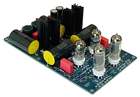

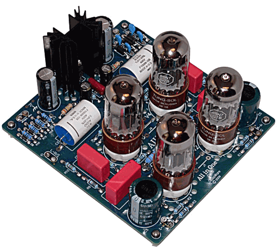

Akikido LSA/HPA 9-Pin or Akikido Octal which one?
If you were going to build a preamp and these two were your only choices, which one would you build?
I'm thinking of building both, but like some opinions especially from those that have built either or both.

First: it is not akikido, but Aikido. Second: impossible to say which is best, but surely the noval version is more flexible as there are way more noval double triodes than octal double triodes. Third: maybe one can move this thread to the tubes/valves forum?

If you don't have any "audio nervosa" and you know your target application, then build the Octal and use the 6SN7.
I believe the 9-pin with the 6CG7 is equivalent. The 9-pin version is cheaper, opens the opportunity of adjusting the gain by choosing a wider variety of input valves, and allows adjusting the output impedance by choosing the output valve.

Thanks for the input. I am hoping to pair it with an F5 clone for now. Maybe it would be a better option to go for the octals instead of the 9-pins if I would be using different amps with the pre, perhaps?

With the Octal Akikido, your linestage will be either operating with a fixed gain of the 6SN7, or you will be searching for NOS tubes that offer different gain values (that's what Tube Depot or Partsconnexion is for).
With the Novel (9-pin) version, you'll have a huge selection of valves to choose from, if you want to tweak the preamp as you try different power amplifiers.

Thanks for taking the time and your extensive reply, it did give me a better understanding of that to look for. I'd still have to read up a bit to make sense of a few more things, perhaps.
As far as the tweaking goes, I should be OK with a resistor swap everytime I change the tube to match the amp. If it's just going to be a resistor and nothing else, would a pot with 3 resistors of the needed values work here if I decide on the types of tubes I need before-hand?
The sources would be a universal DVD player, a DAC and possibly a phono amp sometime down the line. The 2 speakers I have in mind have 85dB and 91dB sensitivities respectively.
