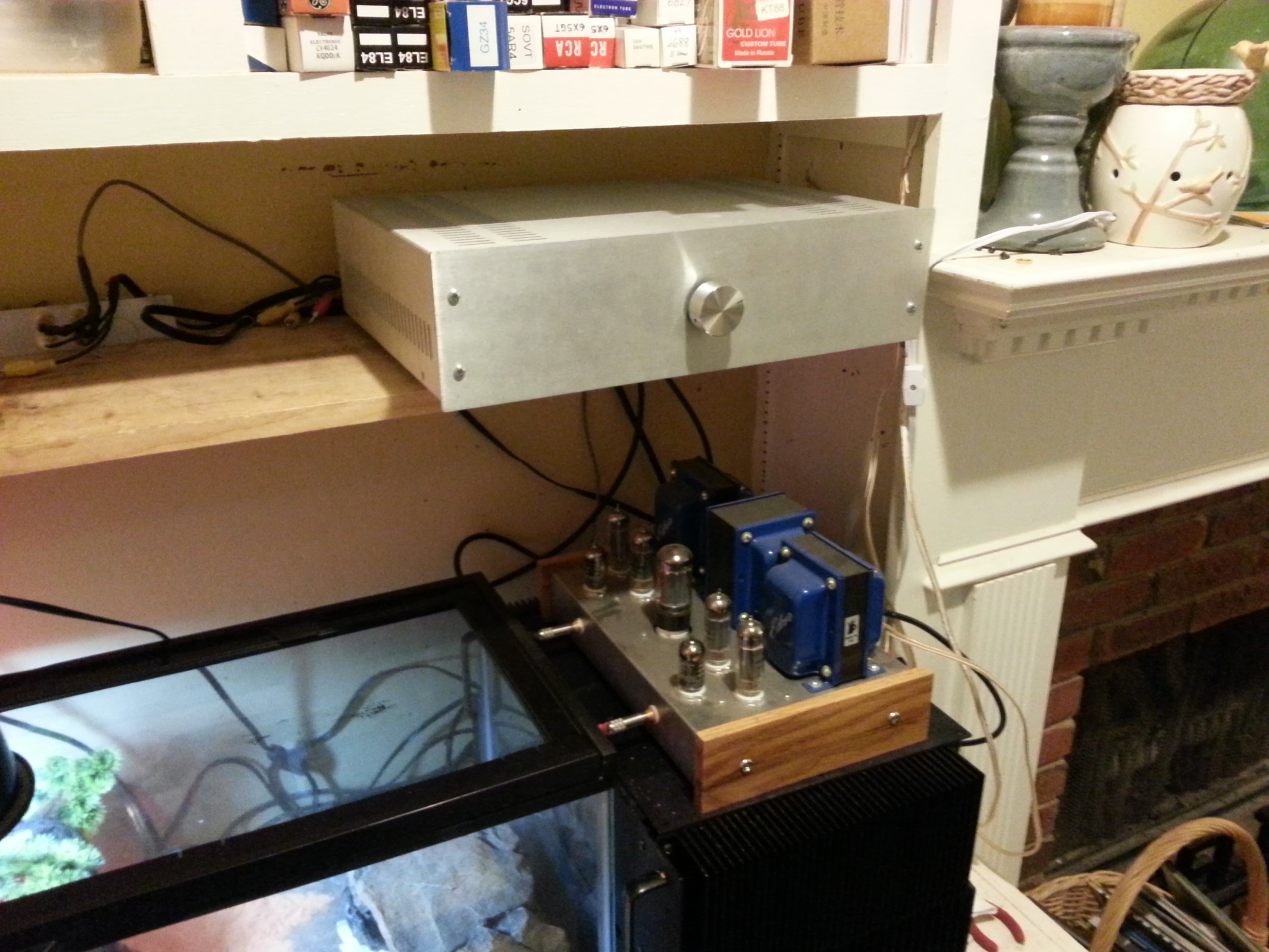

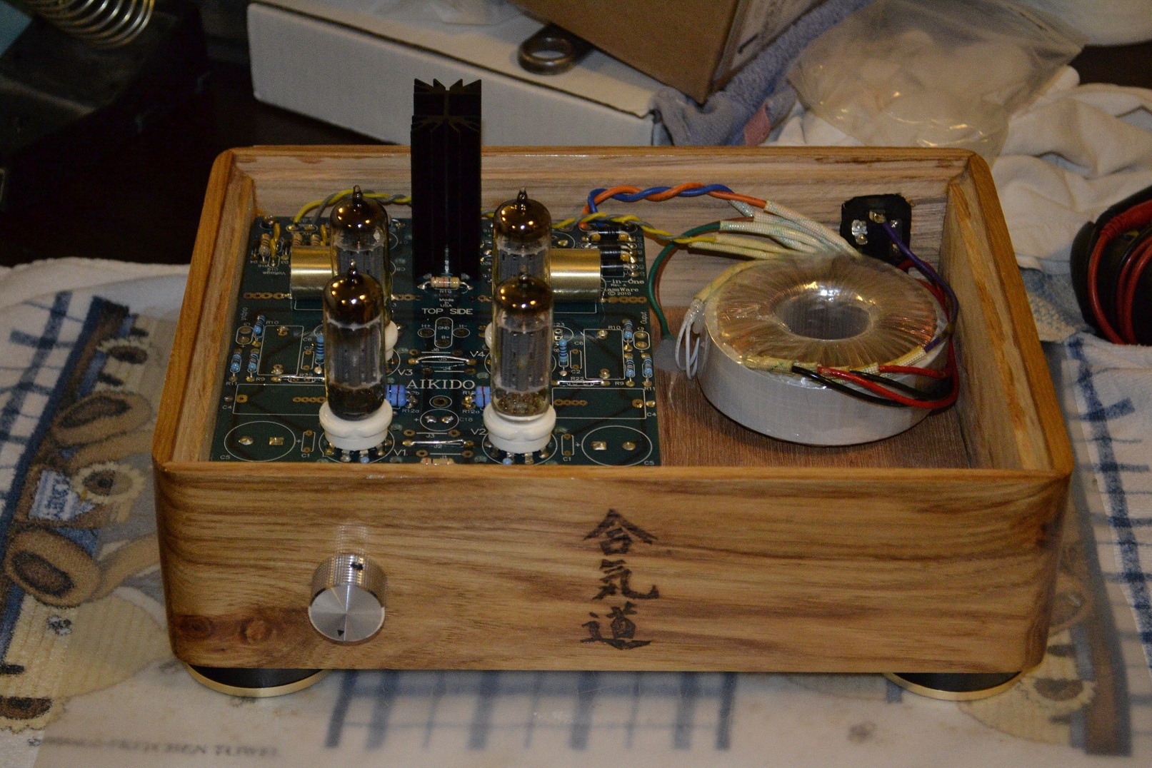

I can say for myself that I LOVE my Aikido 9-pin All in One.
I like it more with bypassed cathode resistors on 6CG7's all around.
It drives my F4 very well and it's dead quiet.
I would highly recommend building a Broskie kit.
Your 12V toroid will fit inside of a large tuna can, smooth sides would be best instead of corrugated.
A little primer and paint and you have a toroid cover.
Then you could make tuna sammiches while you wait for the paint to dry.

Einric...That photo does make preamp look good. I take it the 9 pin all-in- one is what you have in the photo. I take it the 12Vac Akido is roughly the same size. Can you tell me the inside dimensions of that chassis are? Mine will probably have to be metal (aluminum or steel or both) just because all my woodworking tools will be packed away. I image if I put in long hours at work on my dime I can somehow bribe the Tool Room Supervisor to let me borrow a Bridgeport for a few hours.
