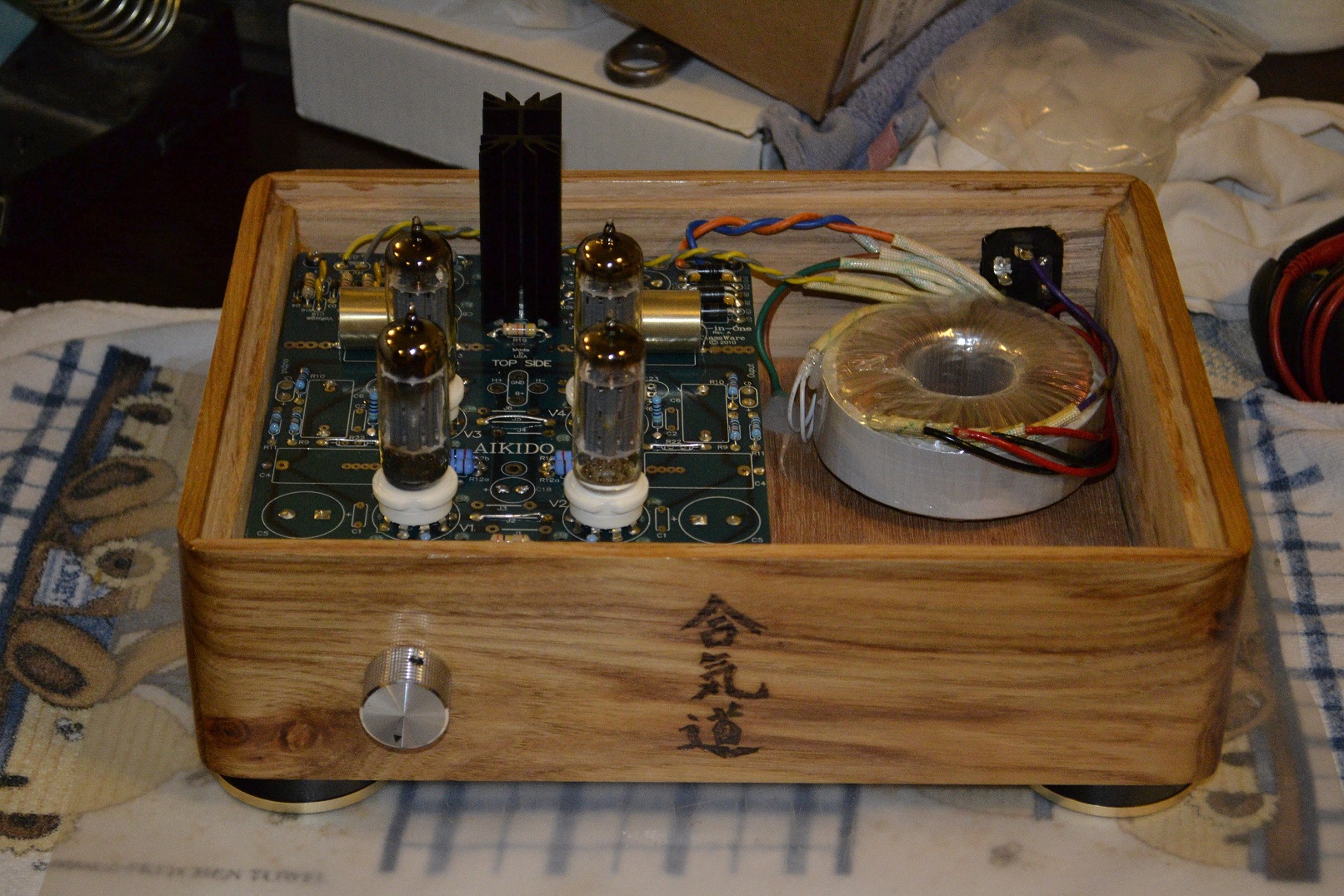

My Glassware Aikido 6CG7
I really LOVE my Aikido, If you need gain then I would really look at going with a Glassware kit.
I went with the 9-pin All in One.
Here is my thread.
I have cracked open MANY "wall warts" to find very cheap poor quality mass produced crap inside.
I have an Antek AN-0212 just waiting for another Aikido.
Generally a Torodial transformer will have a smaller "Sphere of Influence" than an E, C or I core transformer will.
So.....if you were to use an onboard transformer I would go with one of those AN-0212's or similar, you would just need to purchase an IEC inlet w/ fuse.

That build looks really nice. Can you tell me if you built that from a kit from Glassware? And if you did can you tell me what option choices you picked as far the resistors, caps, tubes, etc. and can you tell me what power supply transformer is in your preamp?
We're the instruction provided detailed enough for a newbie to build?

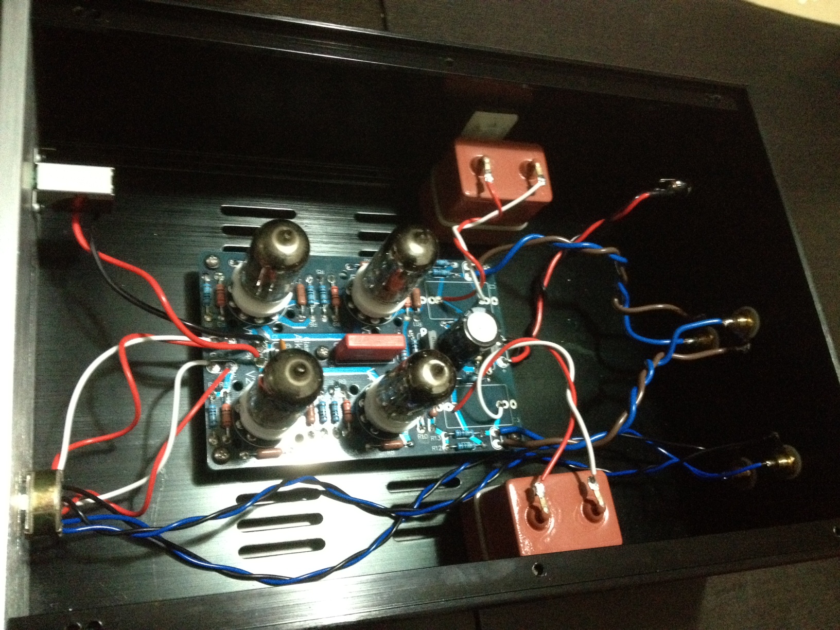

I built the Glassware 9-Pin All in one Aikido.
I chose to use the 6CG7 tube for both sections.
I don't think the one I used is available anymore but the 5687 All-in-One PCB & User Guide is very similar it just uses the 5687 tube instead.
The instructions are very clear and it's more like soldering practice than real work.
I went with WIMA capacitors for the PS bypass capacitors and Obbligato 1.0uf Coupling Capacitors.
I used the Antek AS-05T240 Transformer I just used the 220V tap and insulated off the 240 tap.
The project took me a little over a month to complete but if I had to do it again I could probably do it in a weekend.
The support I got here from more people than I can count was truly exceptional.
We're the instructions provided detailed enough for a newbie to build?
