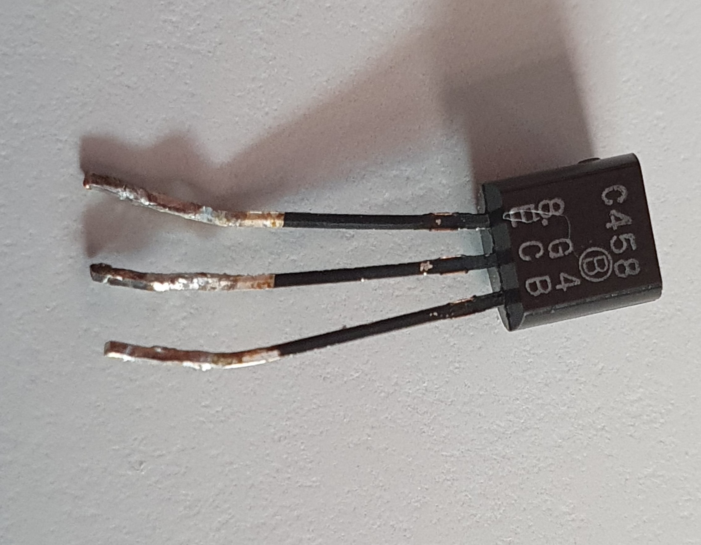

That´s not a bad idea. These old Akai´s (and similar) have two main reasons for noise: Corroded rec/play switches and the widespread use of Hitachi´s 2SC458´s. These transistors have a tendency to corrode on the legs, and with time the corrosion creeps into the plastic house and gradually destroys the chip, and thereby causing all kinds of strange behaviour, mainly all kinds of noises.
Just remember, after replacing them with a suitable substitute, the unit needs to be recalibrated/readjusted to perform to spec´s 🙂
I know this post is a couple of years old but if anyone comes across it, a known fault with these Akai decks is the 2SC458 transistors used in both the replay and microphone amplifiers. They deteriorate because of corrosion on the pins and initially become very noisy leading to a complete failure to pass a signal. Confusingly the DC conditions test out fine. A good clue that they're failing is the legs have gone black. I have just refurbished two of these Akai decks and swapping the dud transistors for 2SC3200 and 2SC1845 brought them back to spec.
