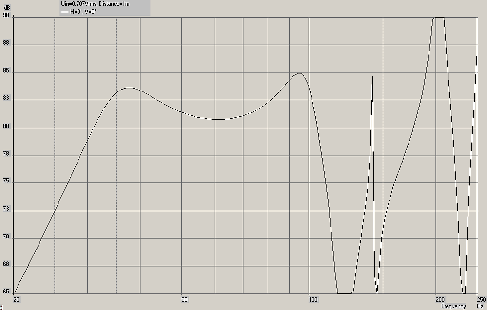

just slight offtopic in my own thread.... I compared the akabak scripts for a tapped horn with 2 drivers, 1 with the 2 assumed at the same location (as it is in Hornresp) and 1 with the 2 drivers at separate locations (as the real thing)
this is with 1 shared location
I know MJK's sheets, but thanks anyway...
I started to look more into Akabak because it is able to simulate stuff even Martin's sheets cannot do, like a tapped horn and systems with mulitple drivers. (+ that Martin has withdrawn his sheets from the public domain, which leaves us with only Hornresp in combination with Akabak)
