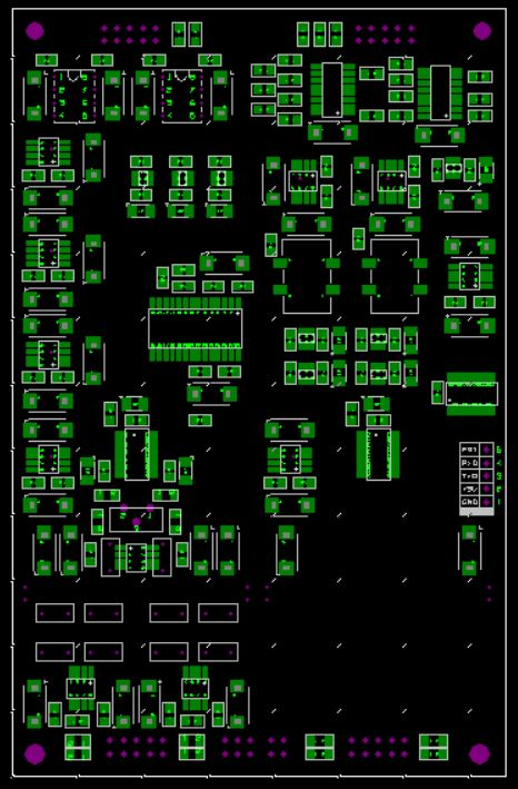

I would be interested in a DAC module with 1x AK4499EQ or better with 2x AK4499EQ in mono mode. Input only I2S to connector or pin header. My vision is, that on the PCB desk would be only 1 or better 2x AKM, voltage control, I2C bus and analog stage. I2S input, I2C bus not isolated, 4 layer PCB for simple layout . Here is my old unfinished project, how I imagine the implementation.
I would like to ask if there would be interest in such a board and if anyone could do a professional design. It would be good if there will be possibility of distribution of the board with soldering AK4499EQ (pad bottom side chip). Even better with the possibility of professional soldering was all SMD and THP components. It would be a widely usable module. I'm willing to pay for such board and I need a few pieces. I would probably be able to design it myself, but I don't have the possibility of using of automatic assembly machine and reflow.
Could someone du it?
What is the reason, that you want 2x4499?
4499 is 4ch DAC, so even with one chip you will have 2 DACs in parallel in each stereo channel.
P.S. According for my experience, for all AK449x series, there is absolutely no sense to parallel the DACs.
All versions with "2x4490, "2x4493", "2x4497" have only the marketing sense and influences to the customers only 🙂

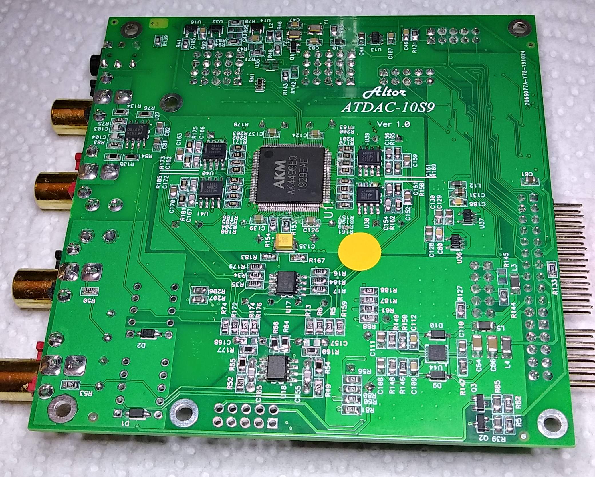

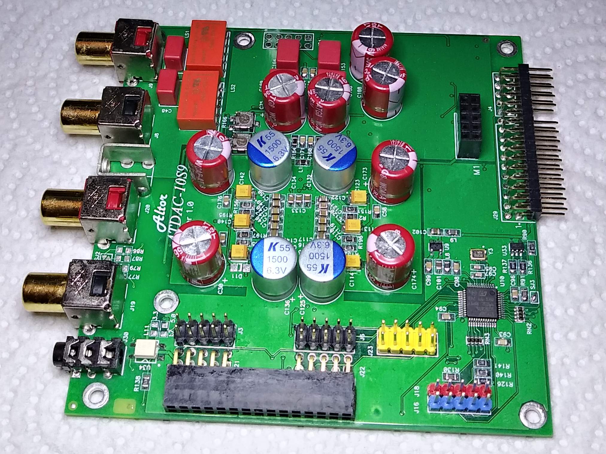

For a few pieces Reflow Oven and P'n'P Machine are overkill, everything can be made with the soldering station and fan.
The PCB manufacturing houses that make bare PCBs can also solder whatever parts you want, only certain ones or all of them. Just tell them what you want them to do, and they will give you a price for doing it.
However, a prototype may end up costing much more than a Topping D90 or similar, and might sound worse. Might sound much better too, but that is highly unlikely if you haven't done enough R&D work first.
Altor: Could you sell me one empty board and documentation for it ?
It is not for sale - it was a prototype, which I made more then a year ago. I assembled one and few units are at my friends. I do not have spare boards.
I did not heard any benefits vs 4497 in sound, also my measurement setup cannot show the big difference.
So this project was stopped, and I'm not sure if I will return.
Better to wait 4498.
P.S. I just show this photos to proof that P'n'P Machine and Reflow Oven are not necessary 🙂
